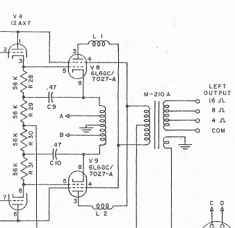

Seems that McIntosh made a number of tube amps years ago with a very similar topology. One difference though is that they don't use the cross coupling capacitors. The only reason I can think of for this is that the transformer has to have a 1:1 ratio between the cathode winding and the anode winding if you want to cross couple then using caps. Maybe theirs didn't? Another amp, the Quad 22 used what looks to be similar arrangement to the McIntosh but I think the cathode windings are way smaller than the anode ones and they don't contribute much to power output; their main purpose is for negative feedback.
Part of McIntosh MC-240 below.

FYI: McIntosh primary windings are 1:1

McIntosh was able to wind their output transformers' primaries "bifilar", that is, right next to each other. This removed the need for extra coupling capacitors across the ends of the windings. Your circuit, being the McIntosh topo without impedance matching, could be done the same. An interesting variation was described by Norman Crowhurst in 1960 using two separate output transformers, the extra coupling caps (of course), paralleled secondaries and the McIntosh bootstrapped drive. For valves, of course, in that era.
All good fortune,
Chris
ps: your original post was never answered. Yes, you want the same load impedance no matter what local feedback you're planning.
