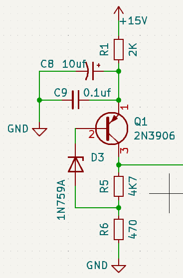

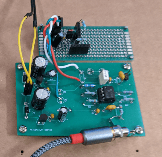

I think if you keep the reverse base current below 10uA you'll have a circuit that would be stable for a very long time. That circuit seems deceptively capable of doing that especially if you start with the pot turned all the way down and only set it for a couple uA. You could use a higher value emitter resistor. You don't need any 50MHz of course. I haven't found any diodes that are louder than the transistor, that's why people do it, but you still don't want to accidentally put a used one back in your bin and grab it later for an amplifier input stage.I think it is a design error to reverse bias a BJT emitter-base close to it's limit which is called a BREAKdown. It may work for a while but is probably damaged. Perhaps an adjustable current-limiter is needed.

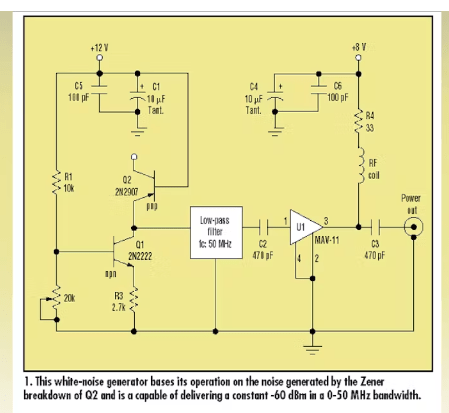

I found various schematics for generating white noise and/or pseudo-random numbers. Most of them are just experiments which don't protect the avalanche transistor. I like the projects by Rod Elliot and a few others that explain what they are doing.

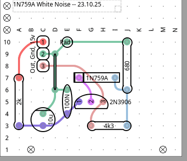

Using boosted Zener.
I abandoned the idea of using BJT for white noise since the BJT is too delicate. Fortunately, an actual Zener diode is "heavily-doped" ..LOL.. to withstand the stress of avalanche operation. I read that BJT can generate 30mv but Zener does only 20mv. I remedy that with a Zener-adapter. It is very robust and I can see it's output on my "Heisenberg" BitScope.
The schematic has a 2N3906 as a buffer which gives up a little gain to provide negative feedback for stability. I call R6 the gain resistor. It can be anything between 220 and 560. I don't know how much feedback is needed to compensate for material variance. I selected 470. I tested 220 but that causes clipping in the opamp of the support PCB which is gained by 10k/1k.

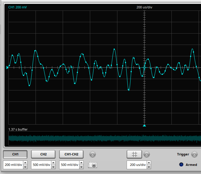

I discovered that the opamp will oscillate if the zener adapter is not plugged. An input termination resistor prevents oscillation but the test PCB needs shielding, shorter tracks and wires. The MC1458 (2X741) does not oscillate since it's frequency response rolls off sooner that 4562 or 5532. The 5532 does 300khz and the 4562 does 200khz. This is not a problem for the custom adapter but a flaw in the fabricated PCB and wires.

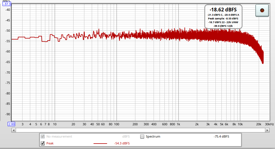

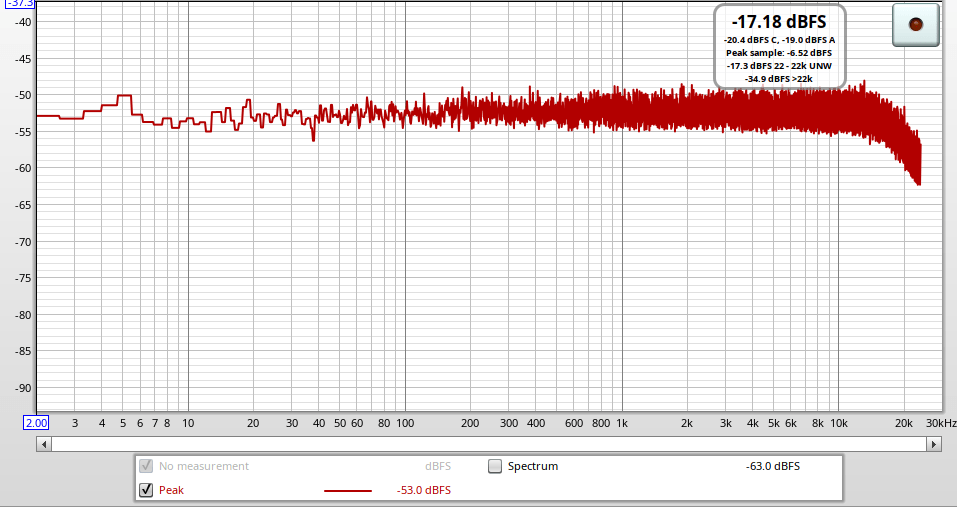

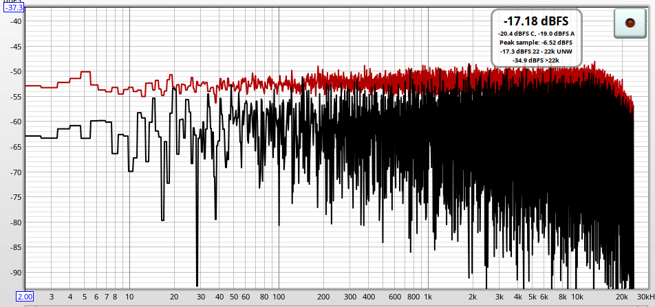

I prefer a digital generator but I want to compare analog and digital. Do they sound the same. Others may want everything analog with a pink noise filter for audio equipment.
