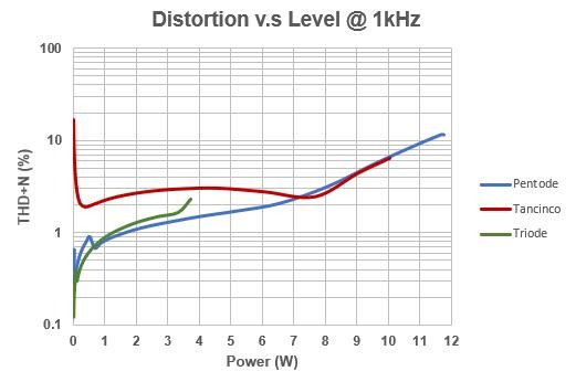

The Tancinco topology was patented in 1964 (US3136766), supposedly as a way to iron out crossover notch distortion in Class B amplifiers, and I've always wanted to give the concept a try. The idea is to add a pair of diodes so that when the anode swings above B+ the screen grid is driven directly from the anode (triode mode), but when the anode swings below B+ the screen is fed directly from the B+ (pentode mode). In theory this would give you the output power of pentode mode but a somewhat lower output impedance and the softer cut-off characteristic of triodes, which should suppress crossover defects. I've always wanted to try it out, so here are some quick and dirty results.
Test circuit below using a pair of 6P14P (basically EL84s) with an 8k : 8R transformer and regulated power supplies. Tubes biased to class-AB datasheet conditions. I have presented results for ordinary pentode and triode mode too by fitting D1/D2 alone (triode), or D3/D4 alone (pentode), or all four diodes for Tancinco mode. Tested on an Audio Precision System 1, 80kHz bandwith.
Results for Tancinco are dire. The diodes introduce a painful discontinuity into the signal which is worst at small signal levels; the oscillogram shows a 1V output signal together with the distortion residual. Tancinco tested the idea with vacuum diodes which of course would soften the switching, but I still kinda doubt he actually saw his claimed benefits even in 1964. Anyway it was fun to finally try the idea out.
Output impedance:
Pentode = 43 ohms
Tancinco = 9.5 ohms
Triode = 5.1 ohms
Input level (grid to grid) for 1W output:
Pentode = 9.4Vpp
Tancinco = 15Vpp
Triode = 24Vpp
