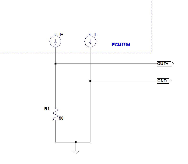

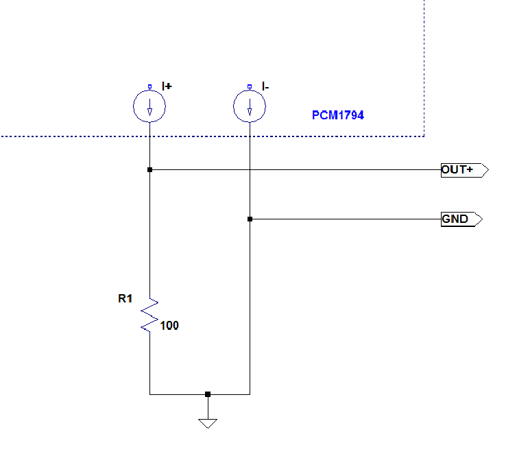

Regarding using the PCM1794A in single-ended passive (resistor) I/V configuration, I can affirm Sergio's suggestion to use an I/V resistor value as close to 50 ohms as is practical on the utilized output phase, while connecting the non-utilized oppositely phased output pin directly to ground. The sound subjectively becomes more relaxing, and more tightly focused particularly in the bass, as compared to utilizing higher I/V values and/or connecting the non-utilized output phase to ground via a matching resistor. At least, that is what I head via my homebrew PCM1794A DAC. 🙂
Ken, I've been fiddling around since you posted a link to this thread over in Doedes' DDAC1794 thread. Most interesting..... I've verified 2nd harmonic from the pos out is reduced by ~3db with the unused neg out directly grounded, rather than being tied to ground by the same size I/V resistor used for the pos out. Most curious. And as you point out there is a "tightening" of the sound from the pos out by directly grounding the non-utilized neg out.

You can also see in Sergio's post #13 of this thread that grounding the un-utilized phase output pin significantly lowers the 3rd harmonic.

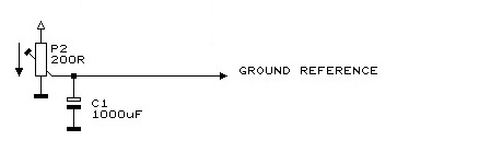

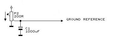

How about raise the ground reference in order to get rid of the capacitor?
Unfortunately, that 1000uF electrolytic capacitor is still in the A.C. circuit. So, while you can manually null any D.C. offset, the cap. establishes an A.C. ground, completing the circuit for signal current return and is therefore directly in the signal path.

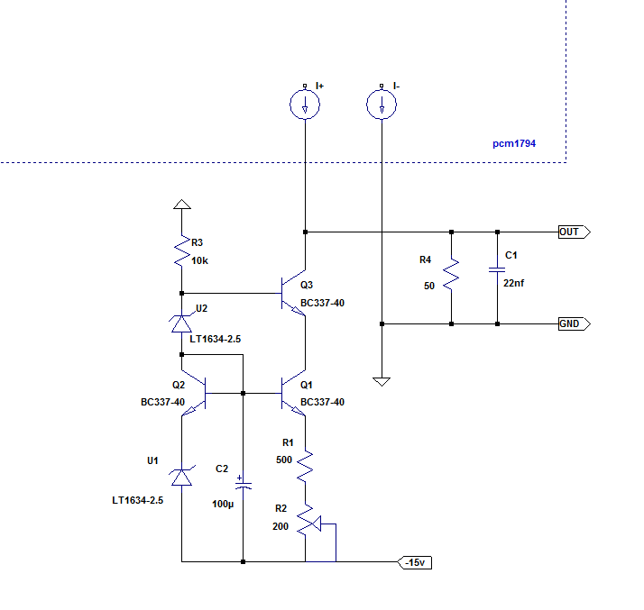

Looking at 2A3SET picture I thought about this. It resolves the dc problem ,
R3 is a 1K trimmer for nulling DC output.
C1 is optional and serves for filtering the high frequency trash ,
Ken, the problem that you experience with your preamplifier is maybe caused by the high frequency trash, i recommend that you try to put a capacitor in parallel with the 50 ohms resistor the value should be between 10nf and 22nf.

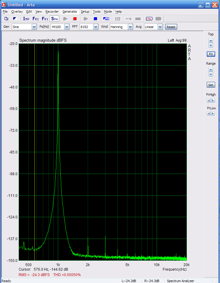

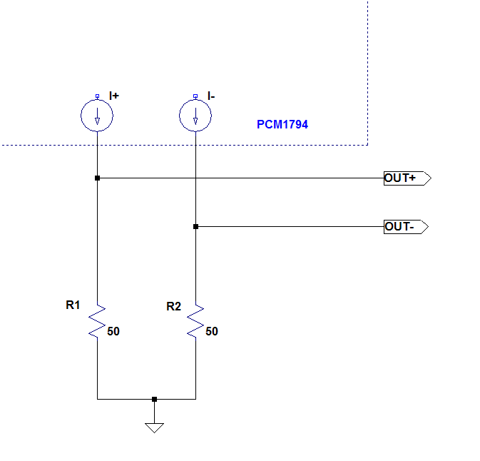

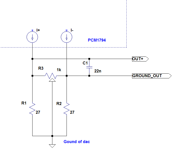

I searched for pictures of the tests that i have performed on the pcm1794 and find a fft from this circuit, unfortunately I do not have a test with two resistors of 25 ohms , but i predict the distortion is inferior with 25 ohms.
As expected from a balanced circuit the pairs harmonics are attenuated.

So , based on the last two posts, I predict that the distortion in the circuit from post 72 is equal to the single 50 ohms resistor , But with less second harmonic. The output A.C. voltage is also equal.
of course , with the added benefit that we do no longer need a capacitor at the output 🙂

Sergio,
Even so, I still find your FFT plots interesting in that for either mono or stereo mode, the PCM1794A will generate equivalent levels of odd order distortion in either single-ended or differential passive I/V output configuration if the same sum total I/V resistance value is in place. Not only would that establish the same net source resistance for either configuration, it also establishing the same fullscale passive I/V net signal voltage amplitude. The cancellation of even order distortion appears to be the only significant performance difference between the two configurations.
One of the system design implications of the above is that while differential drive can give twice the signal amplitude, that comes with a non-proportional increase in odd order distortion percentage.
Ken, That is the case when using passive resistor I/V converter, but with low impedance values like when one use a active I/V converter, the odd harmonics are also cancelled , as i have shown in post #7. But I must admit that using a 50 ohms or less also have very good linearity.

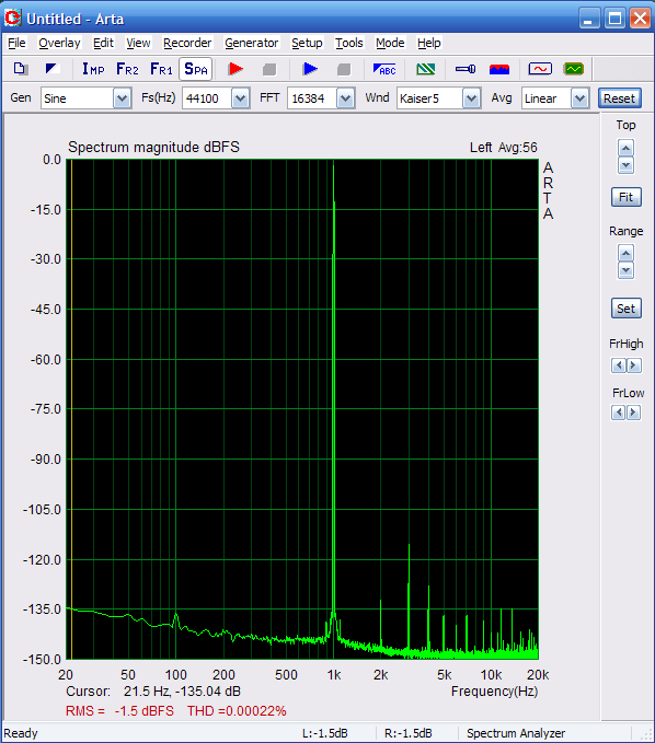

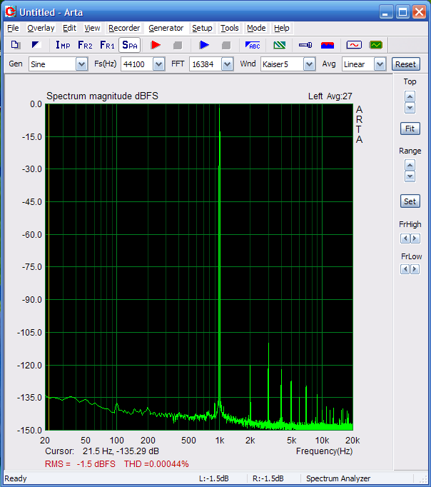

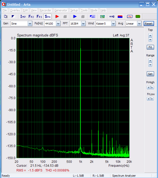

Yesterday, I was making some tests in a I/V converter that I am working on , and remind me, that I never post pictures from 96Khz and 192Khz in this thread, so here they are, for future reference .
First 44Khz second 96Khz and third at 192Khz, all of them 24bits at -1dB of full scalle (2Vrms).
This test was made with a balanced connection.
the distortion at 44khz is only 0.00022% then double to 0.00044% at 96Khz and double again to 0.00088% at 192khz.
