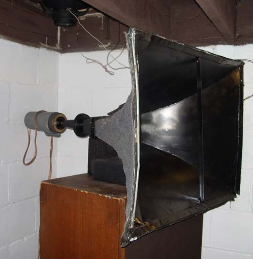

The Synergy and similar "Danley" horns are designed to have zero offset of the radiation axes between low, mid, and high sections of the horn. The drivers work together to act as a point source.
The Summa drivers are about 16" apart on the baffle. This is over one wavelength at the crossover frequency. Not at all a point source.
Here's a picture of one of my TD-2's with the cabinet back off.
That photo is for members only🙁 Does it look like a WE 15A?
Sorry! Here's the photo. Not like a 15A - no curl. And not as big. A bit bigger and a lot deeper than the waveguide in the OP. But a similar idea. 200Hz crossover.
