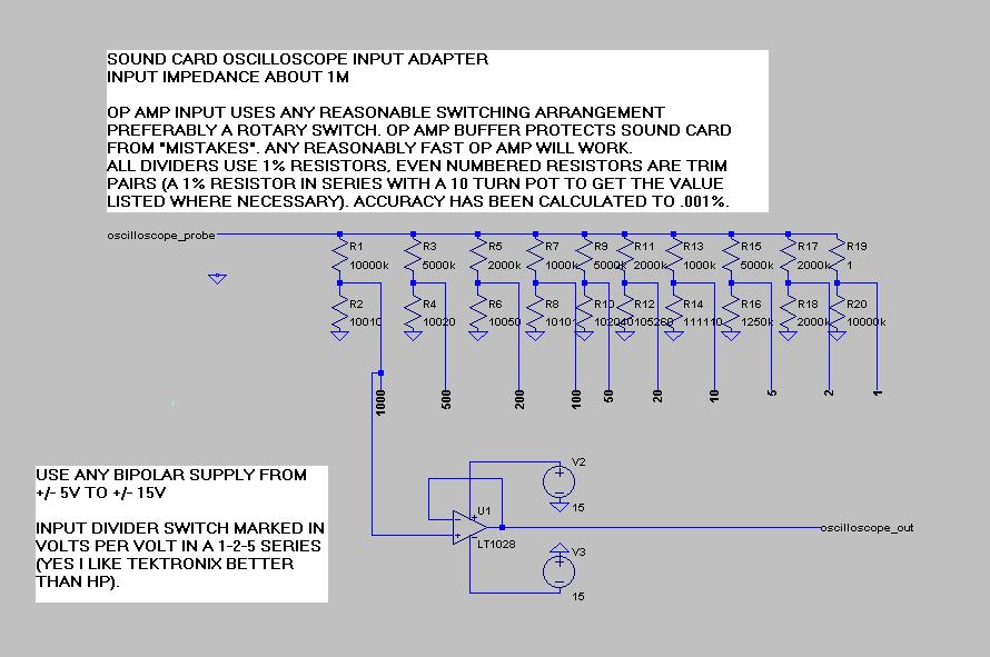

i'm working on the following attenuator for general testing, using the sound card line input and suitable software (like Audio Test Bench) as an oscilloscope...... one thing i forgot was an ac/dc coupled input switch.
the same circuit can also be used as an output attenuator for the sound card output.
I don't have a circuit to post but the switched bypass/cut Pi attenuator will serve you better.
I have twelve DPDT switches and it achieves 0db to -61.05db in 0.05db steps.
It is 600r Zin and Zout.
I have loaded the output with a fixed 600r so that it attenuates correctly when feeding a high Zin and that shows Rs=300r for any receiving amp. Selected 1% resistors achieves very good accuracy.
