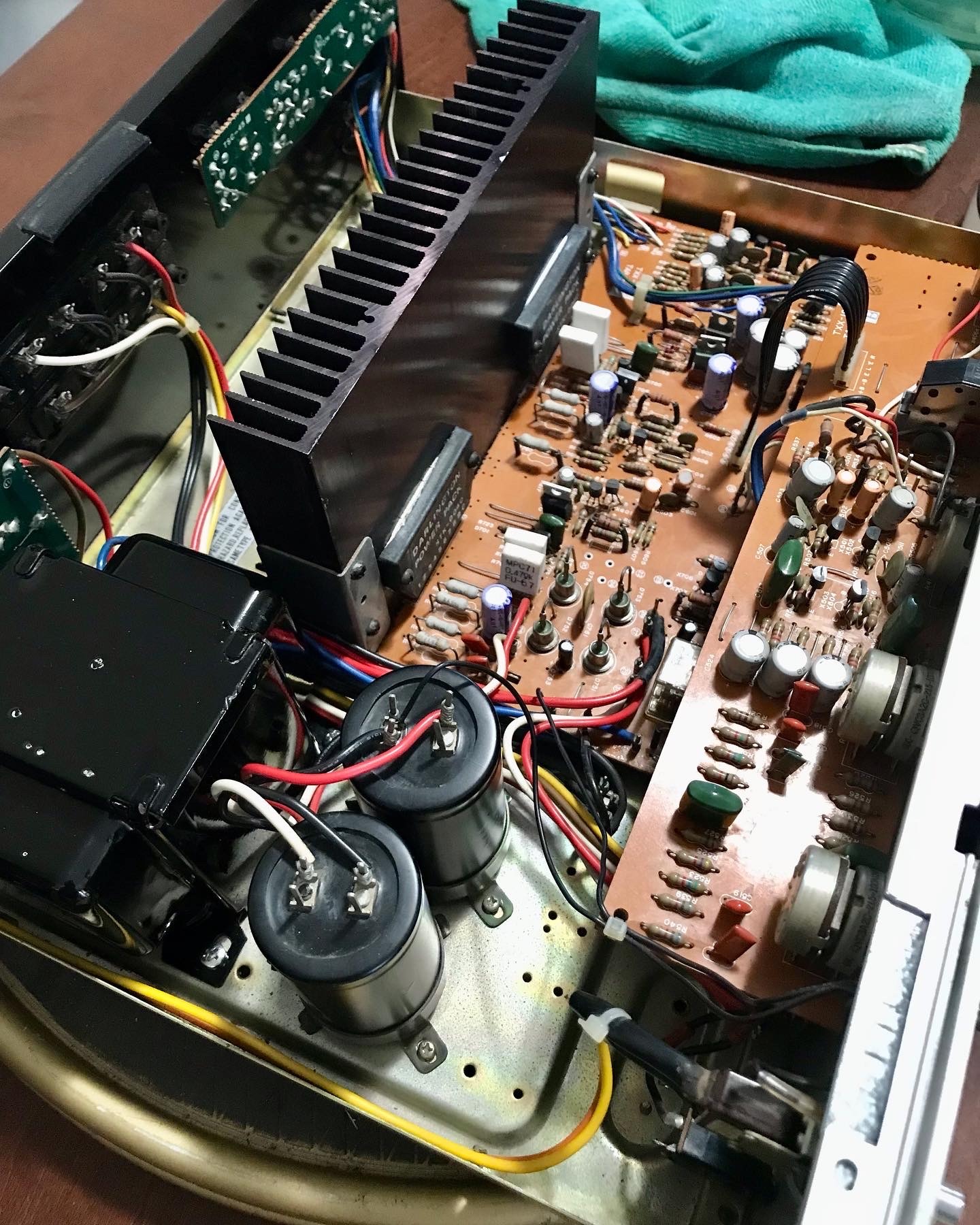

Hi guys I know is a very old thread but hey, has relevant information. I got a vintage JVC amp and I been troubleshooting the thing, someone had been in there before so i found several thing loose and some destroyed resistors. Then I found a couple of bad transistors checked diodes and replaced some caps, because the thing was half apart anyway, But I'm going around , finally got to the stk0040, someone had one out already, trying to get some information on them, i got here. I did the resistance check, then diode tes(short) and finally a voltage check(again).
P1-0
P2--37.7
P3-37.6
P4-0
P5-0
P6-0
P7-0
P8--.06
P-9-37.7
P10-37.7
so if I understand it correctly the thing is toast!!, thanks in advance for your help.

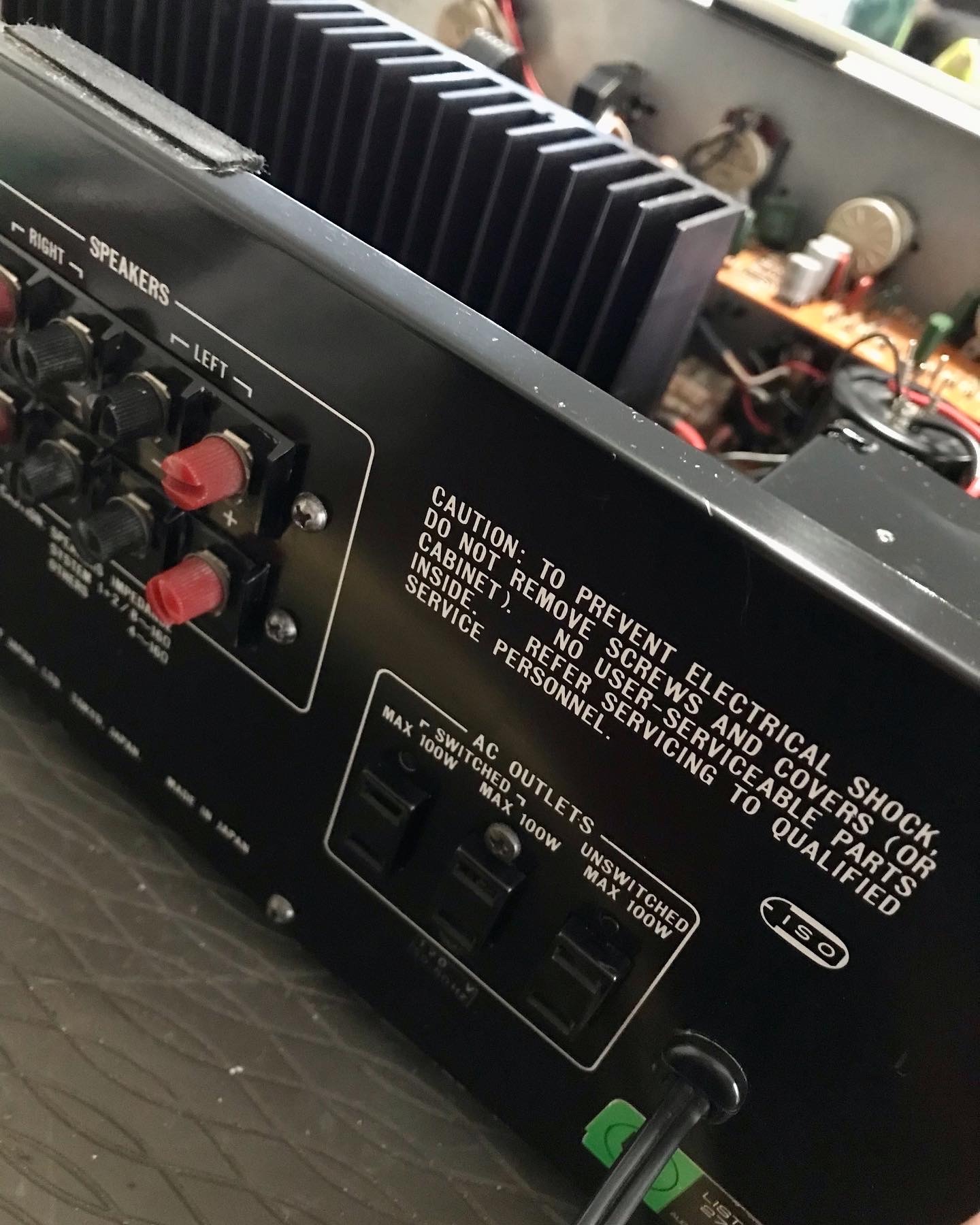

Hi guys, Just to keep this going, after replacing the stk-0040 and a Fet, 1 transistor and two resistors the JVC is humming again. Now cleaned is set aside for a full restoration, next year. Noe time to figure out what's wrong with the STR V6, RH channel (short)
