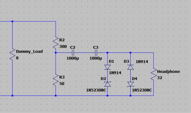

Background. I want to design amplifiers by listening the result on loudspeaker. Problem arose when I realized that without good speaker, I wouldn't be able to judge if an amp is great or not, or sound the way I wanted it with my real speaker. And for safety reason I couldn't prepare a great enough speaker for testing with amp prototypes.
But I thought that great/proper headphone would be much cheaper than proper speaker. So my questions:
1) Is it possible to drive a headphone from power amp, lowering the load resistance to around 8 Ohm with some circuit and have the ability to judge the amplifier?
2) Any suggestion with the proper circuit after the output of the power amp?
3) Stupid question but how dangerous is it to the ears when the amp and headphone drivers blow up in smoke?
4) Any better plan to achieve what I want to achieve?
If the above plan fails then I might have to think about serious/fail-proof speaker protection circuit as it will be abused during the tweak, and use my main speaker.

You CAN drive a resistive load, say 8 ohms, AND attenuate some of the output to headphone levels, for monitoring purposes.

Use a step-down trafo to feed your headphones. Then you can explore the effect of the PSU on dynamics - listen with a 8R load in parallel with the trafo, and without. Unfortunately headphones don't give you much if any insight into soundstage depth, an important subjective attribute of an amp.

Something like this could be suitable. Adjust the divider to suit the amp and headphone impedance.
DC safe and the zeners will clip the audio at the chosen Zener voltage + the ordinaray diodes volt drop. Use say 4v7 or 6v8 Zeners. Caps are fitted back to back to make a non-polarised one.
You can use zeners connected back-to-back, omitting both rectifier diodes. The zener's junction capacitance won't matter at all at 40-ish ohm attenuator impedance ...

Mooly - I will try your circuit and compare it with a trafo. Nice protection features.
