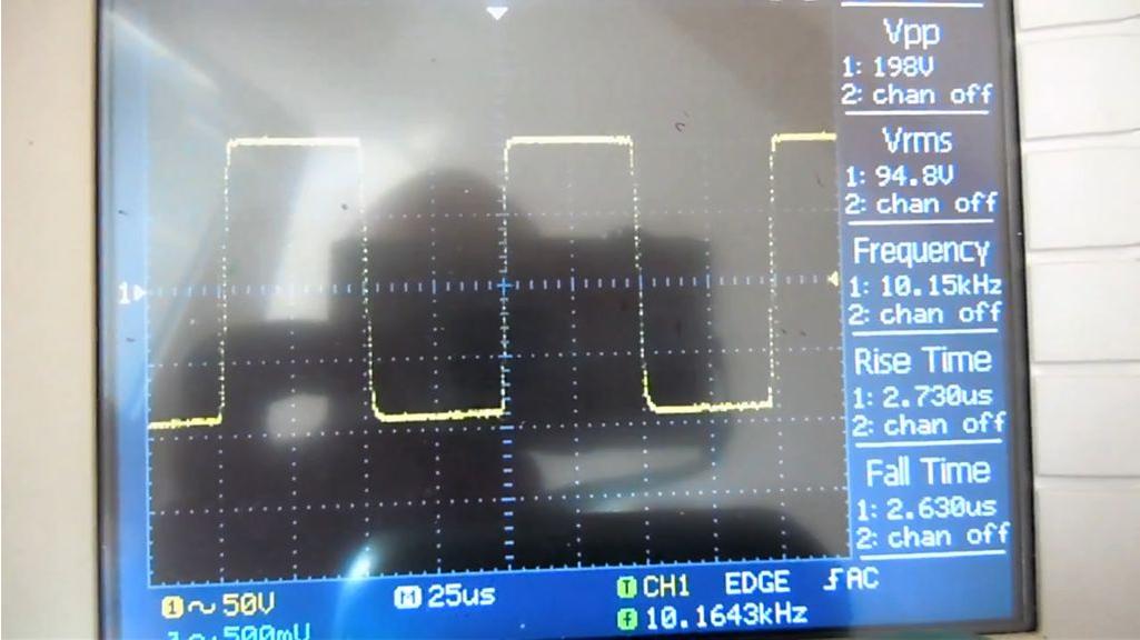

I cannot do any test because amp wasn't mine, and doesn't have it anymore for testing.
I refear at portion of first movie, where I have tested at 10 Khz in squarewave, and around 20 Khz squarewave becomes from rectangular signal to sinusoidal form.
Is exactly at min 12:40, from there till end of first movie.

Datasheets not always reflect reality!
I saw no one to show squarewave response, on their PDF's or on presentation site...
Value are just wrotten, but very hard to be as real acting of amps.
There's an example of the last updated version, of amps modules that I sold (LECO AB Class Amp),presented here:
http://www.diyaudio.com/forums/vendors-bazaar/175365-my-500w-8r-800w-4r-ab-class-amplifier.html
I told to all mine clients that the amp module will reaches MINIMUM 40 volts per microsecond, and the printscreen is with 4 ohms dummy load.
Please be my guest and calculate slew rate of mine amplifier!
Hi DJ,
your customers are free to copy my school book text from above how to calculate the slew rate and do on their own, in case they don't trust you.
I see in comparison to the measurements from the promotional thread
you have doubled the speed. Nice.
Even when talking about slew rates above, the rise times like you measured are the better criteria to judge the speed of an amp.
Required slew rate is a result of the desired frequency reproduction and desired voltage levels. Means the higher power a amp designed for the higher slew rate will be needed, while the required rise time is independent from power.
In fact already rise times around 10us are about two times faster than ribbon tweeters. Similar slowish situation like with the speakers we will find in CD players. Consequently only very slow amps will be the bottleneck in a normal sound reinforcement chain.
You are showing rise times of 2-3us and again it is up to your customers to judge how many times faster they demand the amp to be compared to their beloved snail type CD players and speakers.
