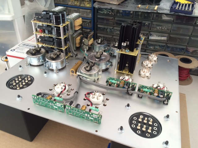

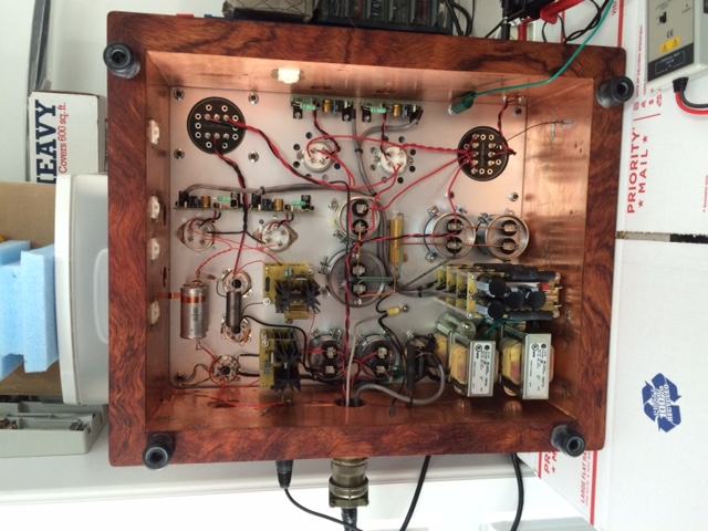

I will let more experienced people here with more sophisticated test equipment comment on your measurements... But I'd like to say that your layout and build is very impressive, especially how you stacked those filament supply modules (?) before reaching the Coleman reg boards..
If ever you plan to rebuild again maybe you could consider another DHT like the 10Y for the CCS plate load -> cap coupled LTP input stage.. I'm not sure though how you would compensate for the lower mu of the DHT. Maybe wire an input phase splitting iron with step up gain? Or maybe you could score a quad of relatively matched 841 higher mu DHT's..
It would be great if you can post the PSU schematic. And please do update us on the better matched 46's or if ever you decide to switch to 45's...

Having all the filament regulators mounted to the top plate, in addition to the cathode resistor, puts out a lot of heat that must be dealt with. The plate runs around 53C in a garage where ambient is currently around 38C. Hot to the touch, for sure, but just tolerable. I also note that the 'lytics in the filament power supplies get pretty warm, but I always make certain to buy 105C caps for good reliability. Heat is not your friend, so just taking the time to really make sure I have a reliable design. I may have to reconsider putting this baby on carpet; will probably have a little plywood platform for each mono block to sit on.

Thank you for the kind words. I admire the mechanical wonders of Thomas Mayer - VinylSavor
He was the inspiration to maximize the use of space, which also helps localize the nasty magnetic strays caused by the rectifier transformers. I have had other designs that were a disaster, especially when using 60 Hz chokes.

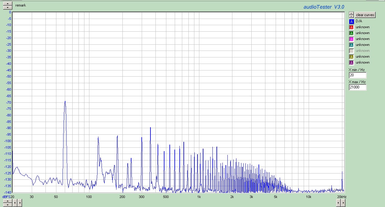

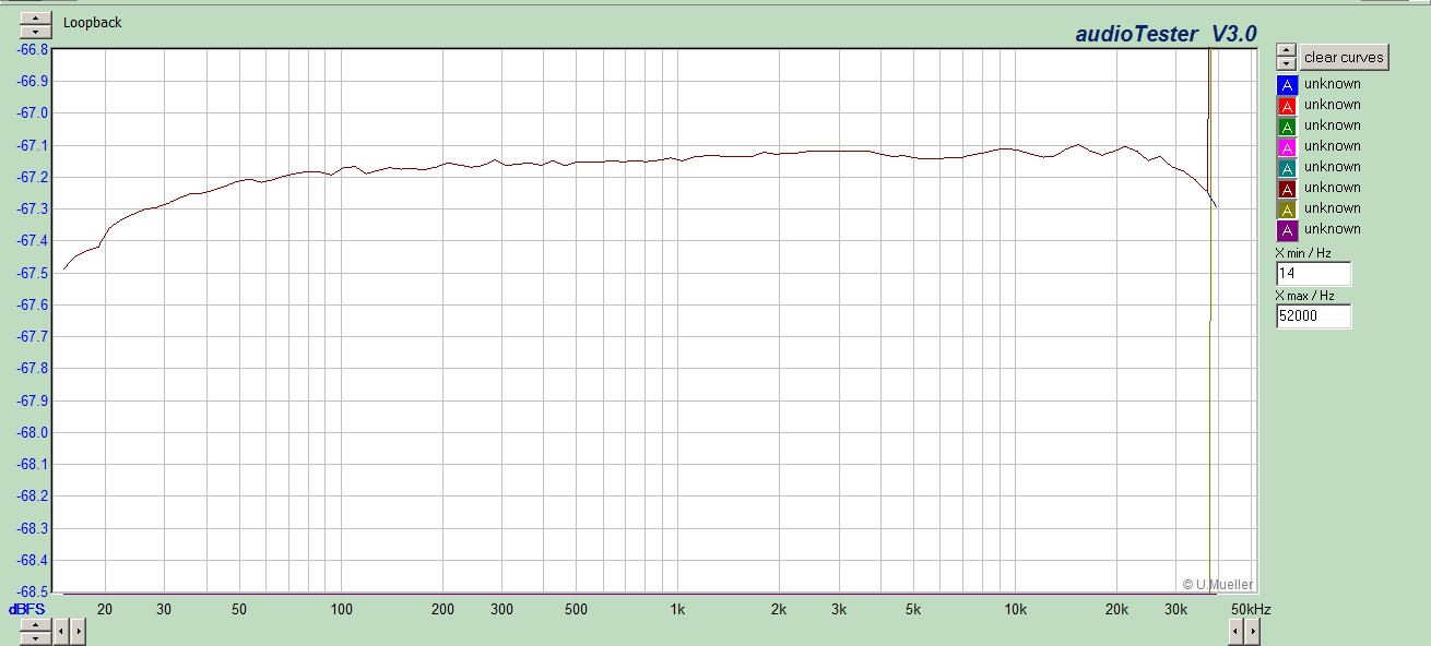

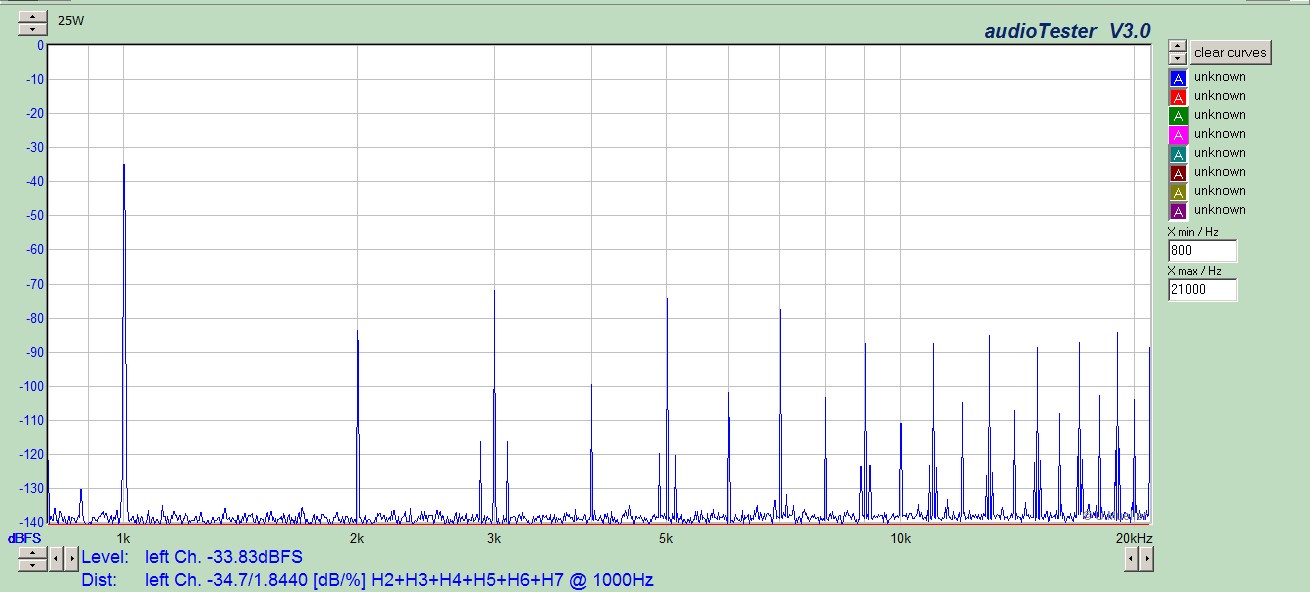

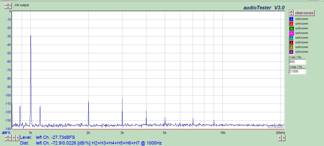

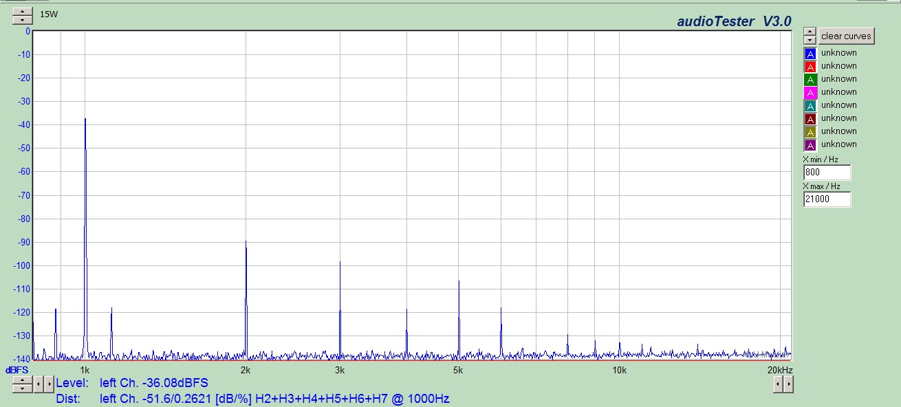

IMD loopback and result. Would this be interpreted as an 0.56% result? Seems a little high, but then again it isn't a feedback design. Would it be proper to assume that one would get significant amounts of 1 kHz, 2 kHz, but ideally very little above that, whereas a high feedback design might have very low but detectable higher order products, such at 7 kHz, 9 kHz?

Very cool your amplifier construction, congratulations!! And great THD results! I can imagine this sounds very good.
A little about perfecting yet more the FFT readings: to make better use of the measuring range, it is best to use an adjustable input attenuator (a pot, for example) and try to use the sound card always with a signal near 0dB. So you can go "over the background" and find more "hidden" harmonics. With a -20dB for example we are already losing a few bits of resolution. Check before in loopback if not appear undesirable harmonics with the most "near 0dB" signal.
Of course, some FFT programs shows "off mark" scale and the real 0dB "saturation" input maybe can -10dB or sometimes +10dB (like in an old Spectralab version I have worked some years ago). Is better to check this first.
For my measurements I use a Asus Xonar (to Arta FFT) with a input pot (and buffers only for high impedance signals) and I always try to perform the measurement between -10 dB and zero dB adjusting the input. The "real" 0dB are +1dB in graph but Arta permits calibrating.

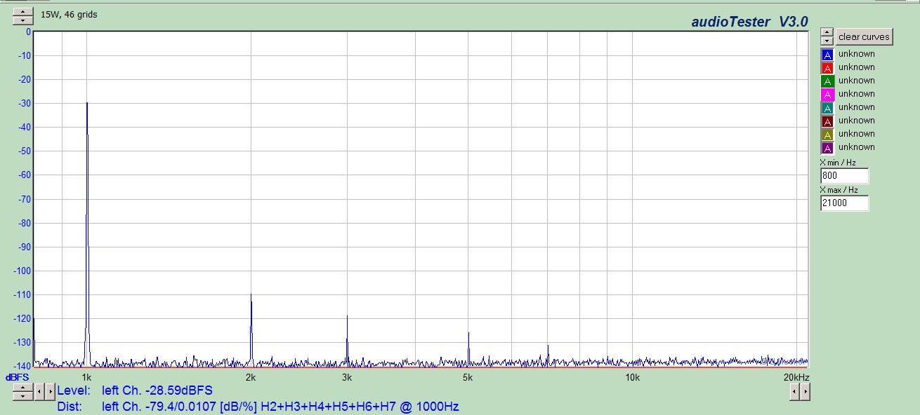

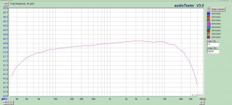

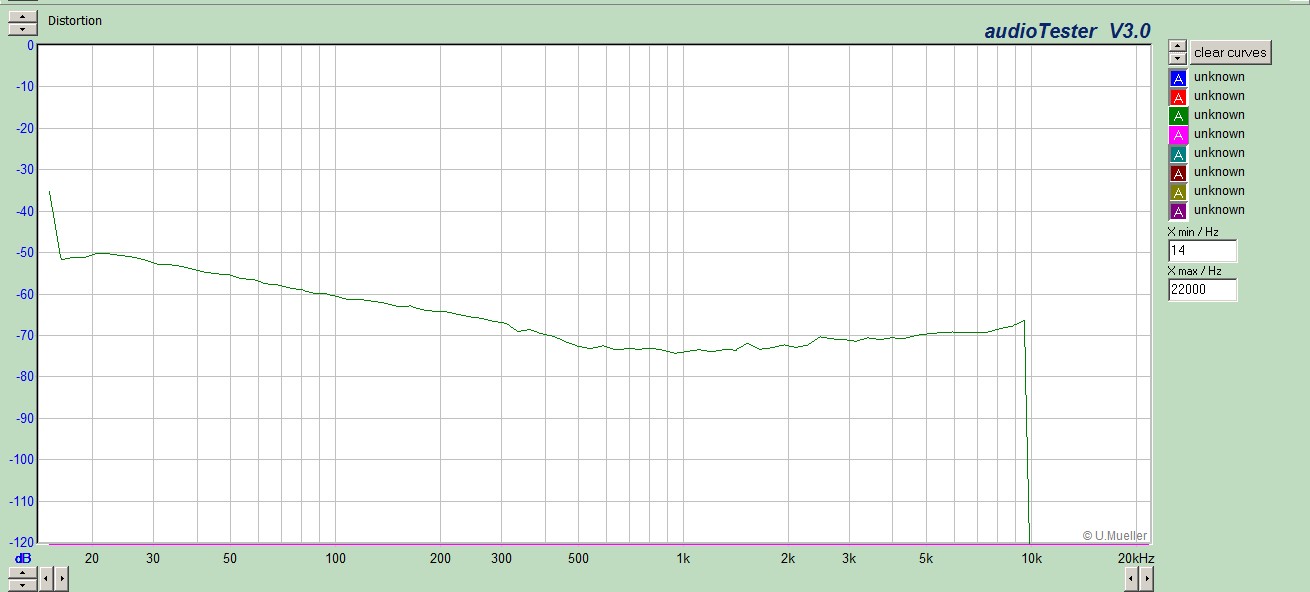

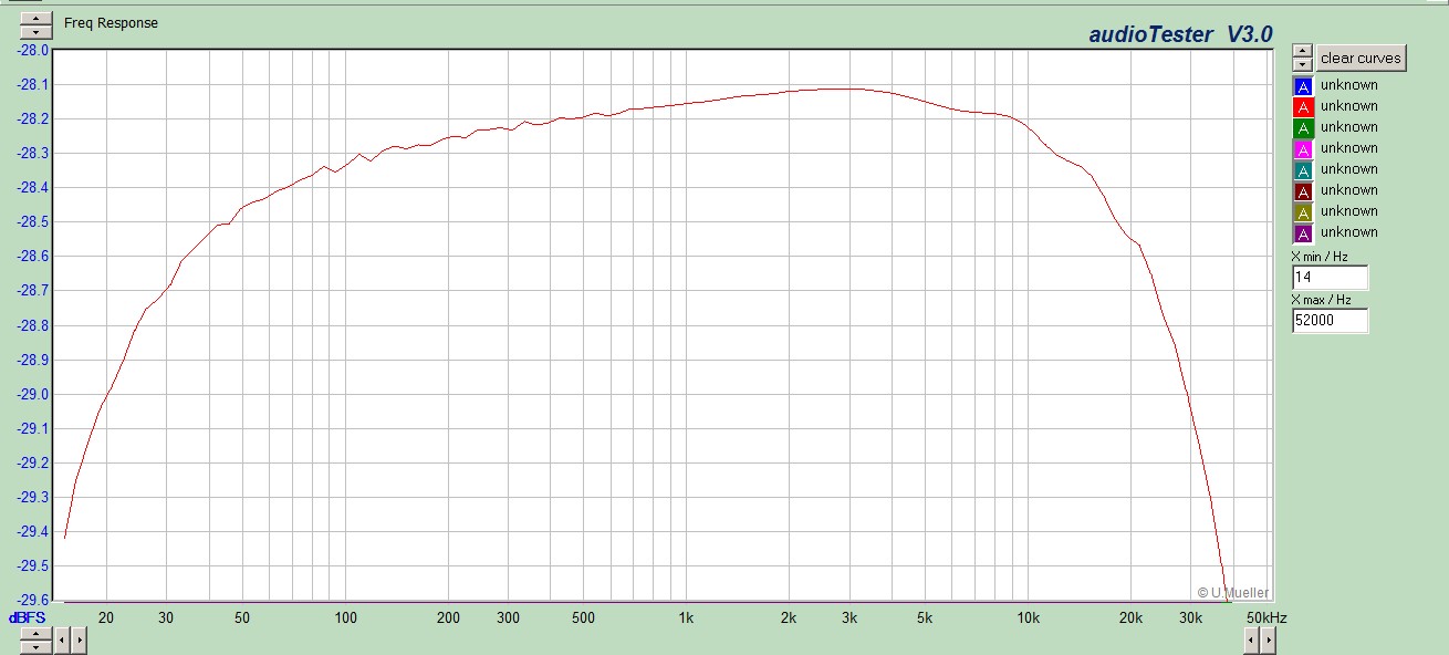

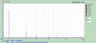

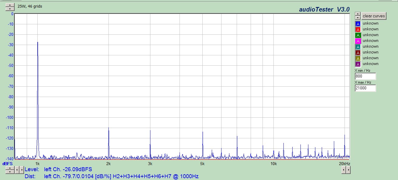

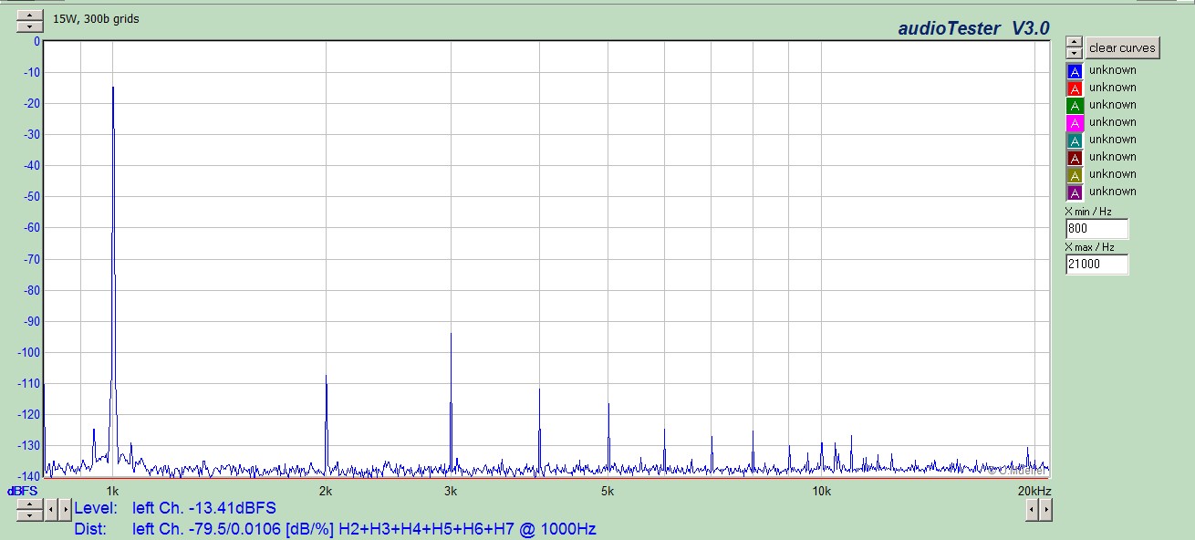

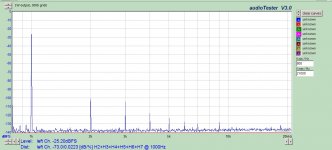

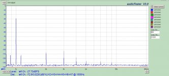

Performance at 1W into 4 ohm resistive load. The captions near the top of the image explains the conditions.

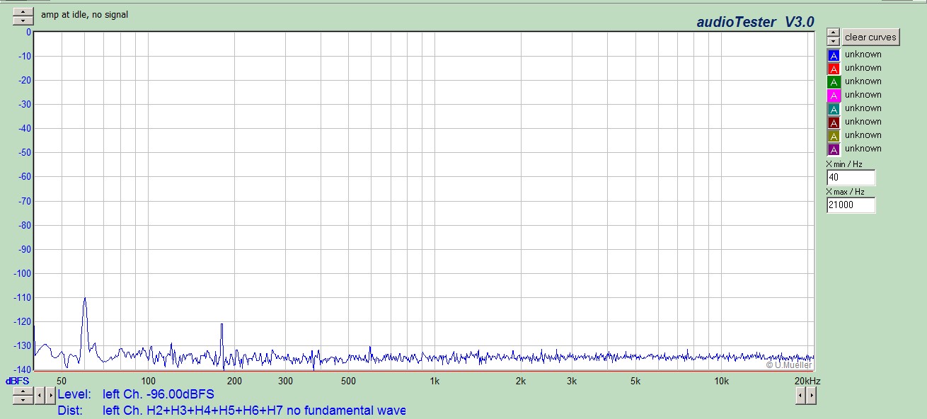

First is the speaker output. 0.02%. Note the sidebands around the fundamental are 120 Hz, which originates from the 250mV ripple present on the output stage B+. The input and driver stage have no ripple effect, as the input stage benefits from the CCS rejection, and the driver stage is shunt regulated with gas tubes.

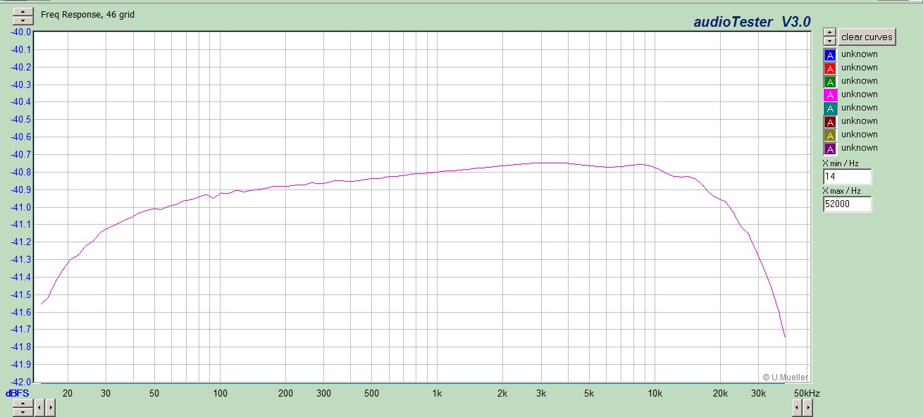

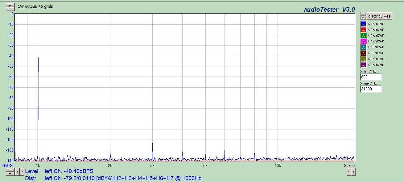

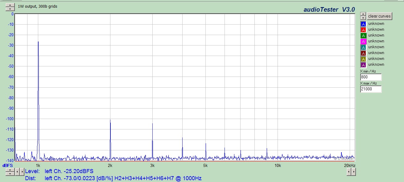

Next is the same conditions, but measurement is differential at the grids of the 46 triodes. This shows the input stage is doing a very fine job at 0.011%. Depending on the tube I use, I can improve the input stage performance. I have a few stellar SN7's that have been verified, and will use those when actually listening to the system. But for testing purposes I picked a good (not stellar) one.

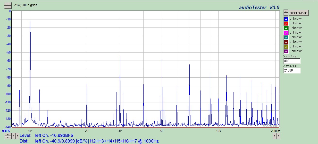

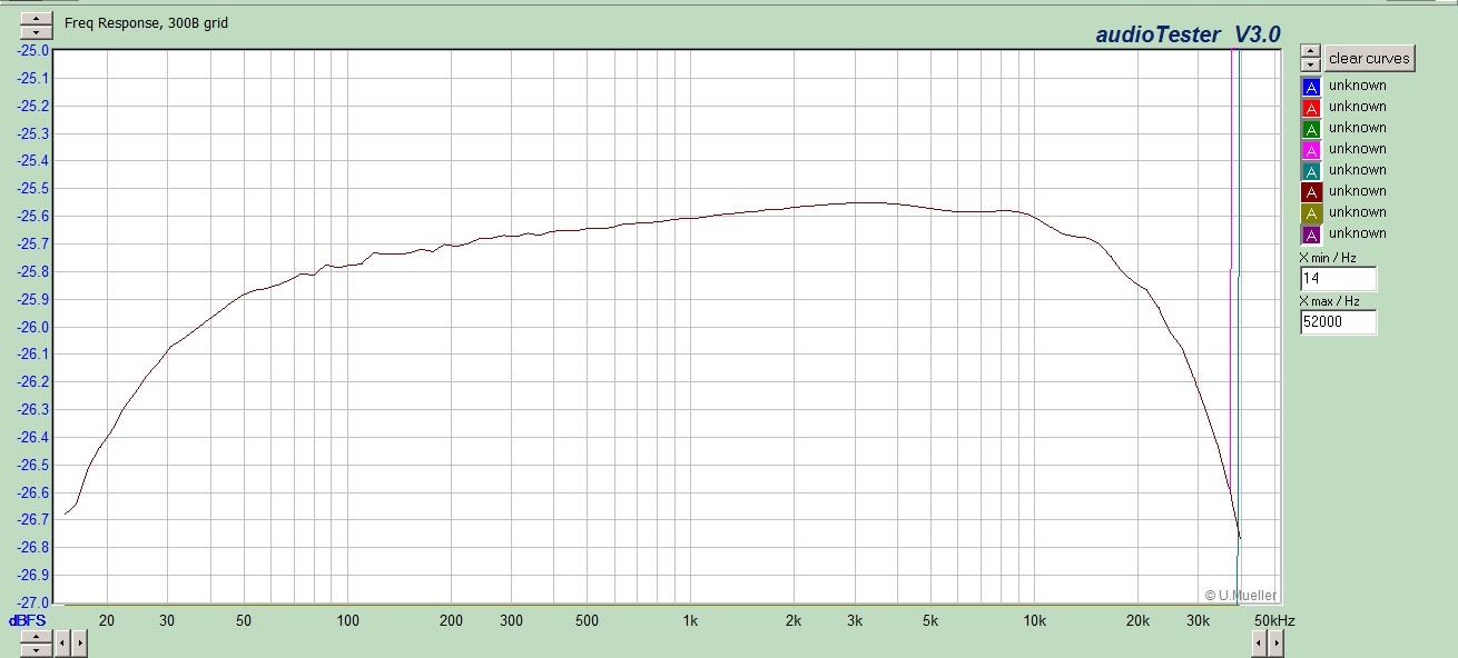

Finally is the differential measurement at the grids of the 300B's. A little additional distortion has been added in the driver stage, but very minimal. I may experiment with matching pairs based on FFT and bias to try and improve the driver, but generally the triode connected 46 does a fine job.
Splendid design work, and very useful characterising measurements. Thanks for sharing!
Lower open-loop distortion of 300Bs is particularly notable with a reactive load (ie loudspeaker) and frequency sweep is applied. Or compare the curves to KT88 IDHTs (etc) ... The improved sound is real enough.

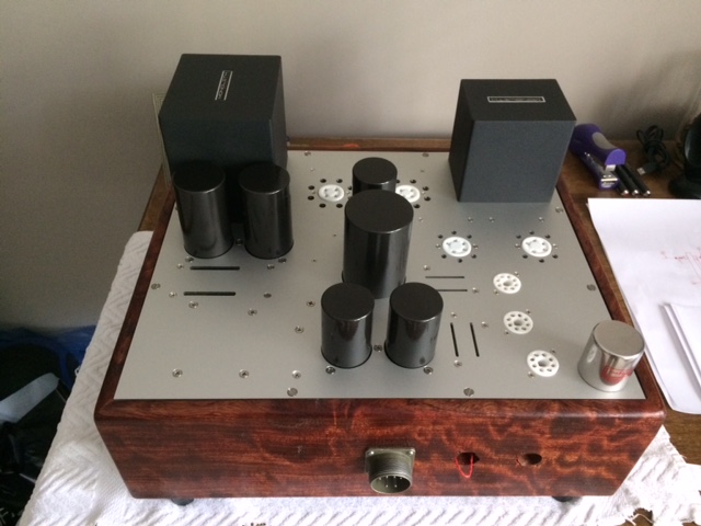

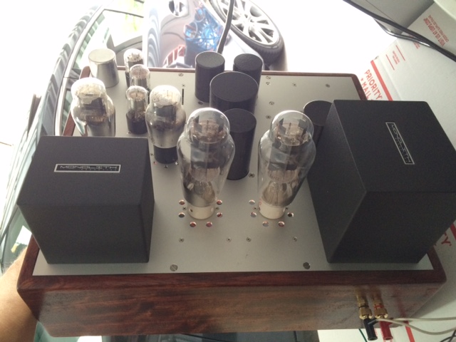

Is the case made of Waterfall Bubinga? Nice work.
I net it sounds glorious.
Thank you, and yes it is solid bubinga. It was called curly, which I'm sure is the same thing as waterfall. Had a great exotic hardwood source back in WI years ago. They have something from every country it seemed. I have designs built of teak, bubinga, zebrawood, cherry, and a few others I don't even remember.
