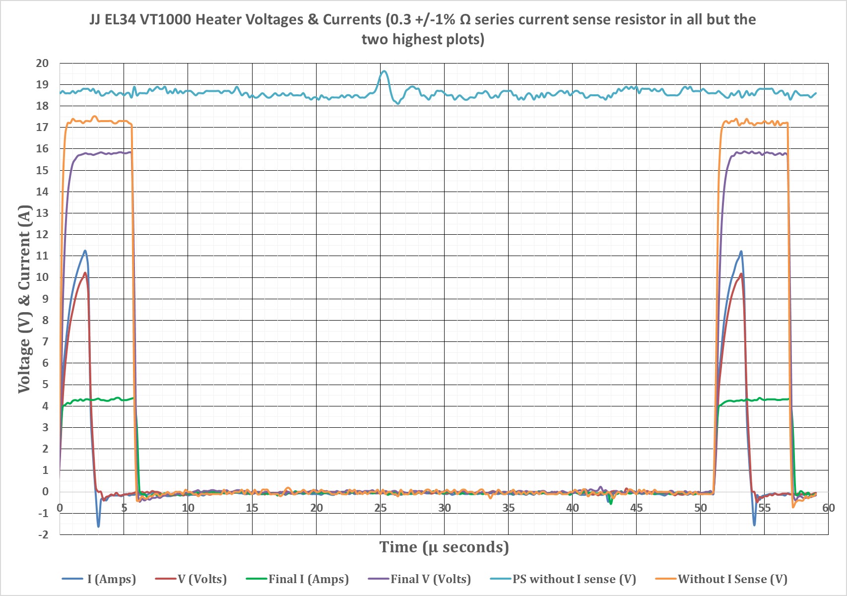

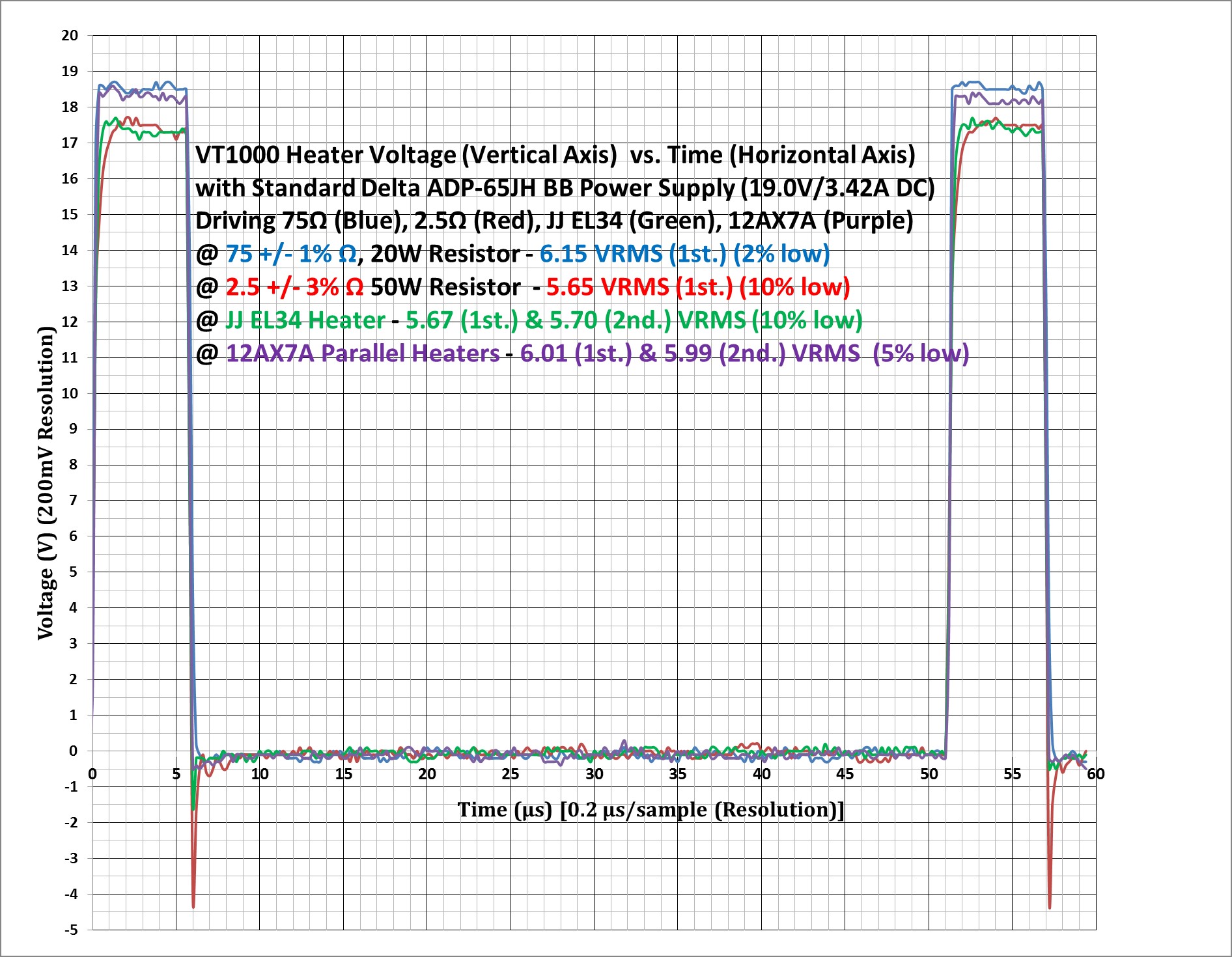

Orange VT1000 Valve Tester Heater Voltages
As Keit pointed out, by confusing RMS with average, my claims for the relevant heater voltages used by the Orange VT1000 Valve Tester were incorrect. Keit and I have tried unsuccessfully for the past month to get that erroneous information removed from the forum to avoid further dissemination. This post is an attempt to correct as well as expand on how the VT1000 really does drive the heaters in the tubes being tested.
The following “Heater Voltages” Microsoft Excel “XY (Scatter)” chart shows the periodic heater voltage waveforms measured for various heaters/simulators after the 5 second heater “soft start/warmup” phase. Excel formulas were used over the period of the waveform to calculate the RMS values shown.
The following “Heater Currents” chart shows measured heater voltage and current waveforms acquired during the 5 second “soft start/warmup phase” (I * V = ~114 Watts Peak) as well as at the end of the test sequence (Final I * Final V = ~68 Watts Peak) with a JJ EL34 tube. It also shows that the unit’s external laptop-type switching power supply output (“PS without I sense”) isn’t causing the voltage drops during the high current draws. “Without I Sense” shows the heater voltage waveform when the current sense resistor is bypassed (for better correlation with the previous chart).
The VT1000’s “Matching Value” for that tube was “7” (Vg = ~-15.5 V for 18.7 mA Ic) with the current sense resistor and “8” (Vg = ~-16.5 V for 18.7 mA Ic) without it. When powered by a DC power source, the “Matching Value” remained at “8” between 6.6 VDC @ 1.56 ADC and 5 VDC @ 1.19 ADC. (Regulating the heater voltage clearly wasn’t necessary for this tube). The “Matching Value” dropped to “1” (Vg = ~-9 V for 18.7 mA Ic) at 3.08 VDC @ 1.04 ADC.
