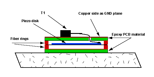

Attached the schematic of the fet buffer for the accelerometer. If you can’t find a small 100M resistor for R1, a 10M one will do also. This resistor defines together with the piezo’s capacitance the low freq. cut-off, this is in fact a high-pass filter. But most piezo’s are in the range of a few nF so this is not much an issue. The circuit is very sensitive to hum, so proper shielding is necessary. Some aluminium or copper foil connected to the gnd will do.
