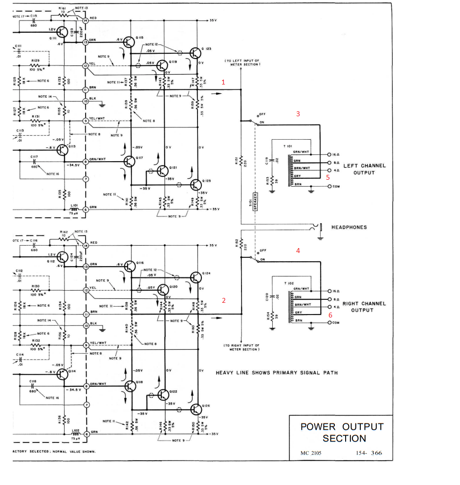

Here's the MC2105 service manual from HiFi Engine. My goal here is to find a diagnostic method to verify that the target OPT is defective. Best if I could do that with the transformer in-circuit. However, I could de-solder the secondary outputs without too much hassle. Thanks
Diag is easy: the opt is just an impedance matching auto-transformer outside of any critical circuit
- Use a voltmeter to measure the output terminal. Any DC? No? Good, carry on. Yes? Bad news, amp blown.
- Connect some headphone. Any sound? Yes? Good, carry on
- Connect some sacrificial speakers between the ground and the "center" of the speaker switch S101. This is the true output of the amp, the thick line in the schematic. Any sound? Yes? Bad news: 1 or both OPT dead, unless it's a contact problem; try DeOxit.
If speaker switch is "OFF" and headphone working well (both channel), the amplifier part is OK.
Switch this to "ON".
Is both channel power level meter working?
If yes, and shows -more or less- same level, the amplifier channels are OK.
If "bad" channel level meter shows -much- less level (or nothing), the OPT may degraded.
If shows more level, as Zung said: contact problem in S101 speaker switch.

Both channels provide ac signal through the input section at the headphone jack. H'ever, no ac signal present at the right speaker output posts. Speaker switch is OK, Physical layout of the amp prevents powered voltage checks (ac and dc) beyond the input section (headphone jack). All output power components on the right side check out OK with power off. (PCBs and heat-sink mounted components both). Removeable power PCBs; were swapped and right channel continued to fail while left channel (using the right PCB) worked fine. As noted in the original post, a couple of possibly suspect right-side output transistors were replaced. Therefore, everything points to the right OPT. Have not yet checked right channel posts for dc voltage but will do so as soon as I get a chance.

Fine on most amps, but not too useful here: there can be NO DC across a transformer primary, even less such a low DCR one.Diag is easy: the opt is just an impedance matching auto-transformer outside of any critical circuit

With power to the amp off, both sides are the same. Com to: 4 - .06R; 8R- 0.7R; 16 - 1.0 R;.
With amp and speakers on; 0 gain, no signal in: left channel shows all three left outputs at 26 R; right channel all three at 4R. Also with power and speakers on, left outputs all show 0.027 vdc;; right channel, all three -0.014 vdc.
On the contrary; it's only useful here: it's an auto-transformer directly coupled to the output stage. Any DC means a blown amp. Look at the schematic.Fine on most amps, but not too useful here: there can be NO DC across a transformer primary, even less such a low DCR one.

Good news, maybe the OPT are OK.With power to the amp off, both sides are the same. Com to: 4 - .06R; 8R- 0.7R; 16 - 1.0 R;.
Now try:
- Continuity tests between the true output/thick line/junction of R147 & R159 and the speaker switch, then on to the output terminals.
- Continuity tests between the amp grounds and the output terminal ground
NB.1: resistance measurement with power on is affected by the output offset. Don't do this.
NB.2: output offset is a bit high, but OK

- Continuity tests between the true output/thick line/junction of R147 & R159 and the speaker switch, then on to the output terminals. - YES
- Continuity tests between the amp grounds and the output terminal ground - YES

Zung, thanks for the assistance. I've run into a snag which will have to be fixed. I put signal into the device and tested both channels at pin 11; both showed appropriate ac voltage. Moving to the speaker switch, I poked around looking for ac voltage and managed blow the fuse. I changed the fuse and tried to power-on with the speaker switch on; blew a couple more fuses. Then tried to power-on with the speaker switch off. It stayed on for a minute then burned out a couple of resistors; but didn't blow the fuse. The resistors that burned out were 162, 134 & 130. Once it's fixed, to get an ac voltage reading at your #2 spot, I'll have to remove the plug-in board (043-899), attach a dmm lead to the out leg-of R148, replace the plug-in board, then test again..
Background: A few months ago (just to be sure) I replaced the speaker switch with a recommended after market substitute. That worked OK. When I got the amp back from the tech a couple of weeks ago, the switch movement operation was labored. Probably the tech damaged the switch mechanically, then I shorted it poking around. I might have the original switch around; but I probably don't have those resistor values in .5 watt; so I'll have to get some parts. Probably take about a week.
