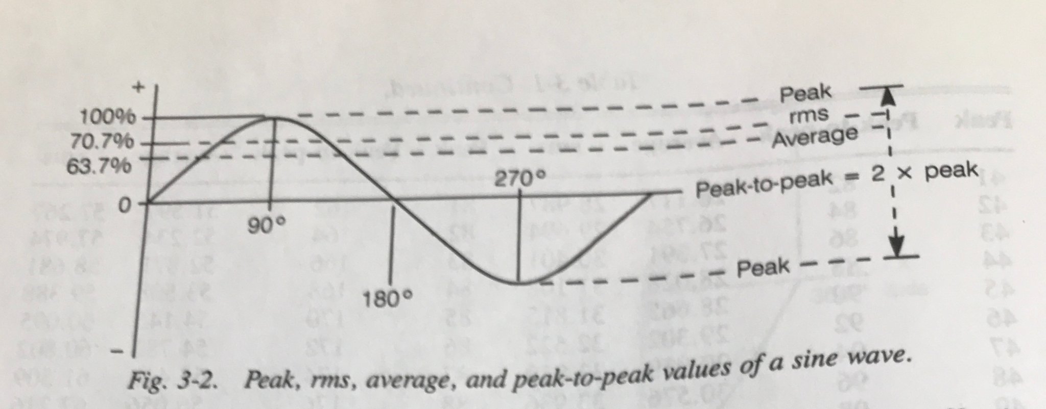

Testing amplifier output?
From https://en.wikipedia.org/wiki/Root_mean_square
Peak-to-peak
{\displaystyle =2{\sqrt {2}}\times {\text{RMS}}\approx 2.8\times {\text{RMS}}.}

Sine wave
{\displaystyle y=A_{1}\sin(2\pi ft)\,}
{\displaystyle {\frac {A_{1}}{\sqrt {2}}}}

The fact is that > RMS voltage , squared , divided by load resistance = WATTS.
( I dare say to invest in a true RMS volt-meter, and double check your PtoP measurements )
Follow your own advice: get a sine wave on your scope so you can observe peak-to-peak and monitor with an rms voltmeter.
The argument is two to one in voltage, four to one in power. Better make sure you’re correct.

The full-wave rectification (fortuitously) achieves the divide by two necessary to calculate power. In terms of heating a resistor, it doesn't matter what the polarity of the voltage across it is (otherwise it would get cold on negative half-cycles!) - this is why the p-p voltage is divided by two.
In simple terms, P=V^2/R, but remember polarity isn't important. That is why it's the peak voltage/sqrt(2), not peak-to-peak.

So, with your 50v peak to peak, convert it to RMS by dividing it by 1.414 = 35.36V RMS.
Then square your 35.36V = 35.36 x 35.36 = 1250.33 . Then divide that by your OHMS > and you get WATTS.
1250.33 divided by 4 (ohms) = 312.5 Watts.
1250.33 divided by 8 (ohms) = 156.3 Watts.
( these power levels are RMS )
I think you didn't read this thread before replying - this is wrong and covered in detail above!
