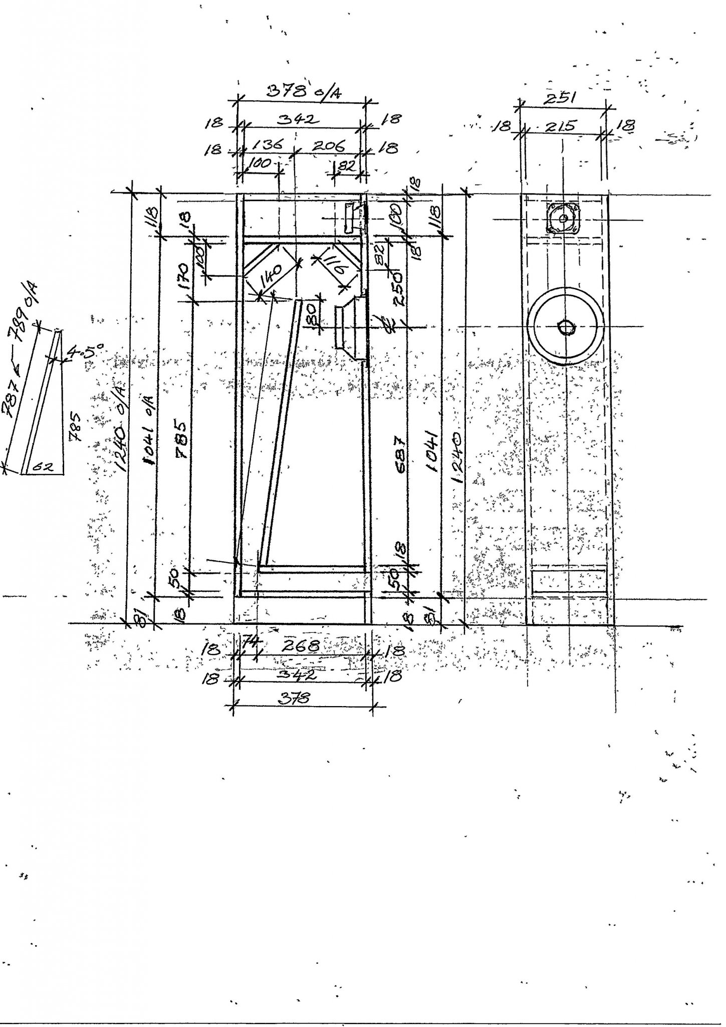

This is my TL design (bloody lot taller than I imagined).Hello, can you post the TL drawing?
The space underneath the TL outlet is where the crossover will be located.
Yes, designed by xrk971 https://www.diyaudio.com/community/threads/10f-8424-rs225-8-fast-waw-ref-monitor.273524/page-99Isn't there a crossover for that combination in the RS225/Scan Speak FAST thread? Maybe it just needs some tweaking to deal with your distance issue?
Geoff
But the enclosure design didn't seem to work when put into Hornresp, and didn't seem to comply with the design theories of people like Martin King.
Regardless, I took the basic concept of combining the RS225 with the Vifa TC9FD, and did my own design using Hornresp. In hindsight, I don't think they are a very good match - RS225 is more sensitive than the smaller TC9FD.
