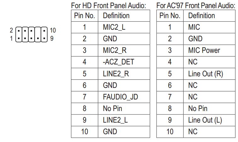

New PC case and mobo. PC keeps telling me that audio plugs plugged into front panel keep disconnecting and reconnecting.. I need advice on how to test it(test whats between the mainboard header, and the audio jacks), as I reckon there are 9 wires to connect 2 audio ports, so there have to be more than just audio extensions there.

Pc front audio pinout
Hi .
Not sure if this may help..

@madtecchy
This is the mainboard's mapping, which I already have. what I'm looking for is the whats on the case's side.. where do these wires go from here.

There are only five wires go straghte to jaks (2Left, 2R, 1GND) while the other four, I belive, are responsable for telling the PC that if there are plugs plugged into the jacks. I believe the issue is here because there have to be electronic parts here.
