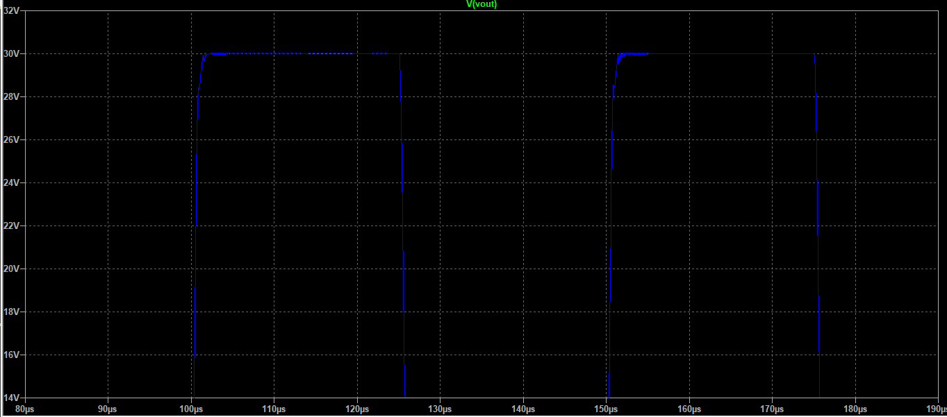

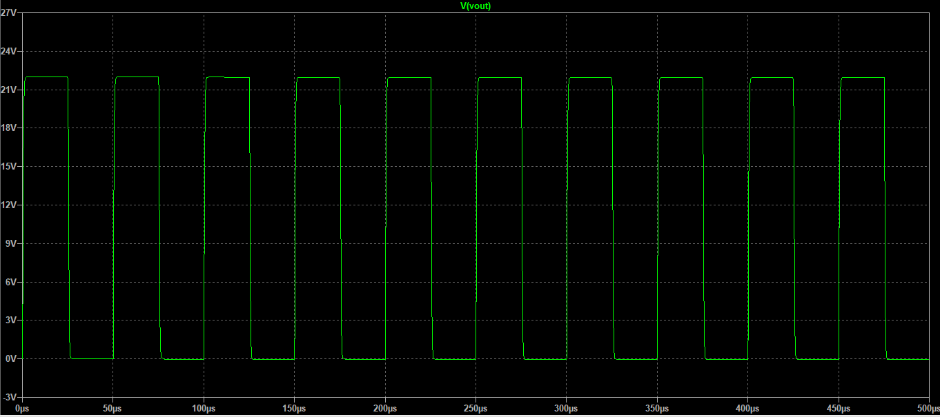

test21... what next?

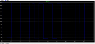

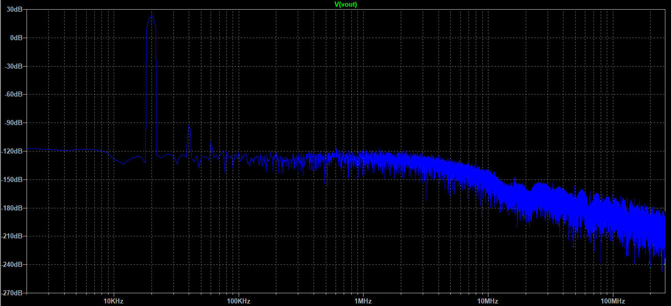

I started testing square waves, but the results don't look so good.
100Hz and 20kHz bellow.
Why is that?

Add this spice directive..
.option reltol=1e-6

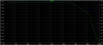

It may improve settling time but could increase sim time depending on your pc hardware specs. Not an expert but a few observation, yuo are using all high gain devices at the input stage perhaps a pair in the LTP should be enough..so you could omit or reduce some miller comp caps (comp caps at the drivers seems a little high at 100pf). Phase is good at 80° but the slope doesn't look ok at 100db. I figure you have a very high open loop gain for a CFP ops. There also appears a bump at 10mhz region. Check your open loop gain plot this could be a sign of HF overshoot, it will affect gain margin, and agree with Maestro Valery perhaps a one transistor VBE multiplier should be enough for the job.

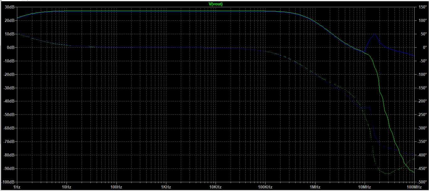

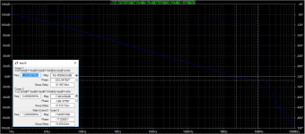

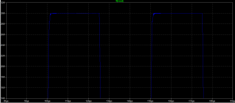

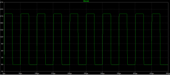

So, it's been a while... I've been swapping parts and tinkering with values, but the bump doesn't want to go away.
And the slope in the OLG looks strange, I haven't simed any amplifier to look like this.

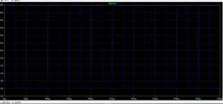

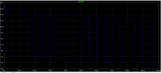

Also, while looking for the clipping point , 1% Thd, I found that it is a fine line between 0.03% at 1,35v input and 5% at 1,4v input. Is this normal?
