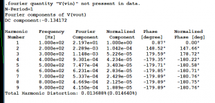

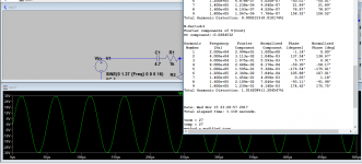

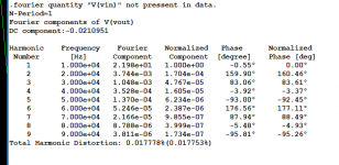

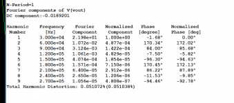

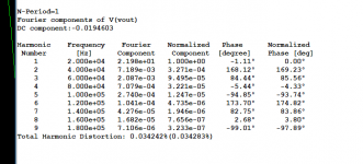

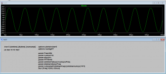

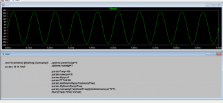

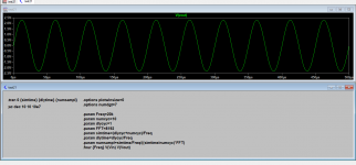

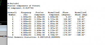

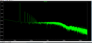

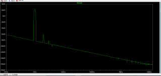

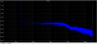

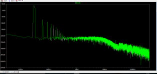

Hey guys, what to look for next?
Swapping the BD's for 1381/3503 does improve things, but I really hate how hard they are to find. 1220/2690 doesn't change things that much...
Maybe a more complex cascode or buffered VAS?
Tests were mostly done for 2 ohm res load, because I noticed some stability issues early on, so I insisted on pushing it...

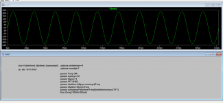

and some more...

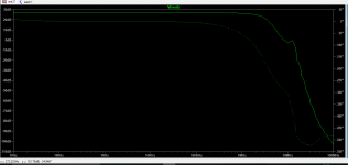

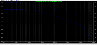

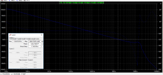

Phase margin and closed loop gain? CFP output stage is very tricky to simulate, it has to be tested in real hardware to verify that it will not self-oscillate.
I get an error when looking for phase margin, don't why...
I'll be back with results.
Maybe I need a new directive.

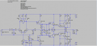

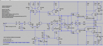

OK, cool 🙂 Let me know if I can help with something.
A few thoughts right away:
- 1381/3503 is an excellent pair (initially designed for video applications) - not suitable for high-current circuits, but excellent for the VAS and pre-driver kind of stages. You don't have to match them precisely - in most cases, 50% hFE difference is fine. Look at it from the following point of view - in the working, self-balanced circuit, collector currents of the complementary pair will be equal. Having some h21 difference within this pair, you will have the base current difference, accordingly. So what? In CCS'ed VAS like yours, it's no problem, in the pre-driver stage - those bases are virtually connected via a low-impedance bias spreader, so no real issue as well.
- Input stage degeneration - R4, R5 - a good practical value I would use is 100R, especially having your LTP loaded with the current mirror (overall gain of IPS is high enough). Higher local linearity and better transient response.
Those values may be lower than that, or even zero, with jFETs in LTP though, because of their lower transconductance.
- You may want to try an emitter follower in front of your VAS (Q8) - use the same BC556B as the ones you use in the current mirror.
- Bias spreader may be simpler - a single transistor, as having your OPS arranged as CFP, you need to track the temperature of the drivers only. Dual-transistor arrangement, as yours, is very good in EF arrangements, where you track both the drivers, placed on a local heatsink, and the outputs, placed on the main heatsink.

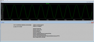

Here is the phase plot.
What do I look for?
Put a cursor on the graph (click on the top equation to invoke) drag it to reach 0db reference, read the corresponding phase deg in the window, subtract with -180° the resulting difference is your phase margin.

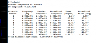

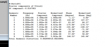

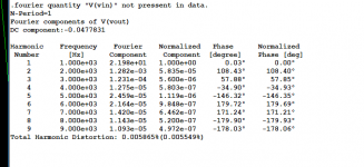

1381/3503 in vas does reduce thd quite a lot. I was under the false impression that they need to be matched.
Lowering the degeneration resistors increases thd. Even the slightest change of R9 value leads to stability problems.
I will try to ad that extra transistor to Q8.

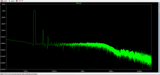

I think that there must be a conspiracy promoted by transistor companies to sell large quantities of actives with the promise that more actives gives better lower distortion results. I realize that this is a power amp, and what I am showing below is what you could use to drive an output stage, but I think, paired with a well designed neutral output stage, it could be very very good, and it would be cleaner and have less hash/grass/fuzz on the FFT with just maybe H2/H3/H4 peaks only.
Here is a 5 transistor design by Hugh Dean that can drive 40v p-p cleanly:
Predicted FFT for 20vpp into 10kohms:
Measured FFT 20vpp into 3.4kohm load:
If you increase impedance of load to 25k we can drive at 36vpp and still GT this:

This is inspired by Borbely-Lender VAS, asymmetric by nature but that's why it works to promote the beautiful harmonic distortion profile.
