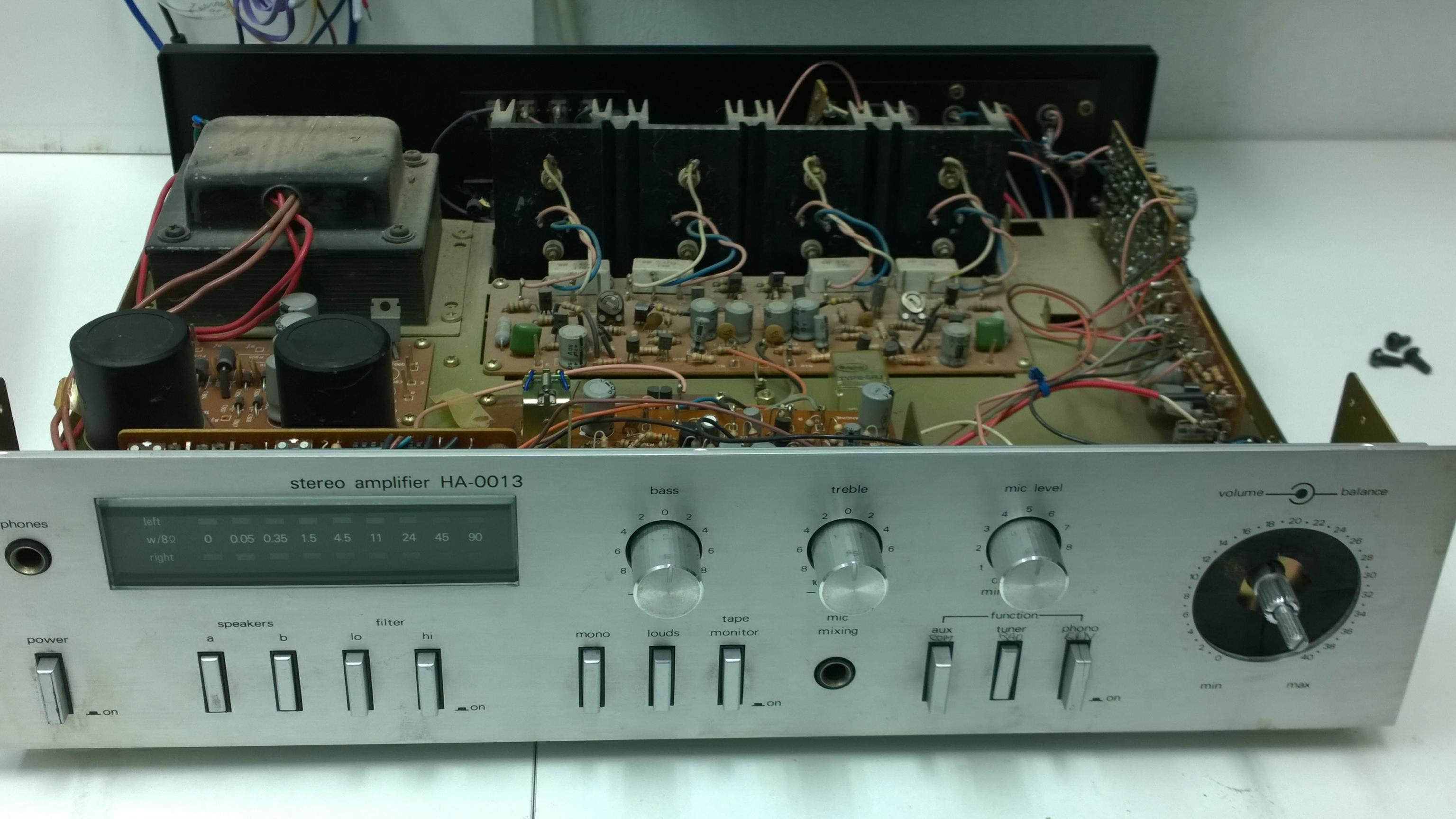

I have find some problems for the old amp. The amplifier had at least two problems.
First was a bad contact in the bass potentiometer interrupting the low freqs and then acting like a high pass filter reducing the level for the 440hz tone and making the distortion more obvious.
Second problem was at the speaker protection relay contacts. Here we have three working states: no sound, normal sound and sound distorted.
All these failures are modified by the level of the signal and the vibrations around the amplifier, like the sound from the speaker.
Now that the problems are fixed, I clean all the contacts, I was not able to pass the ABX anymore.
Problem solved.
But the reality, in my experience, is that these failures are very common for old amps and others can experience similar auditions resulting in false ABXs, at least for simply tones.

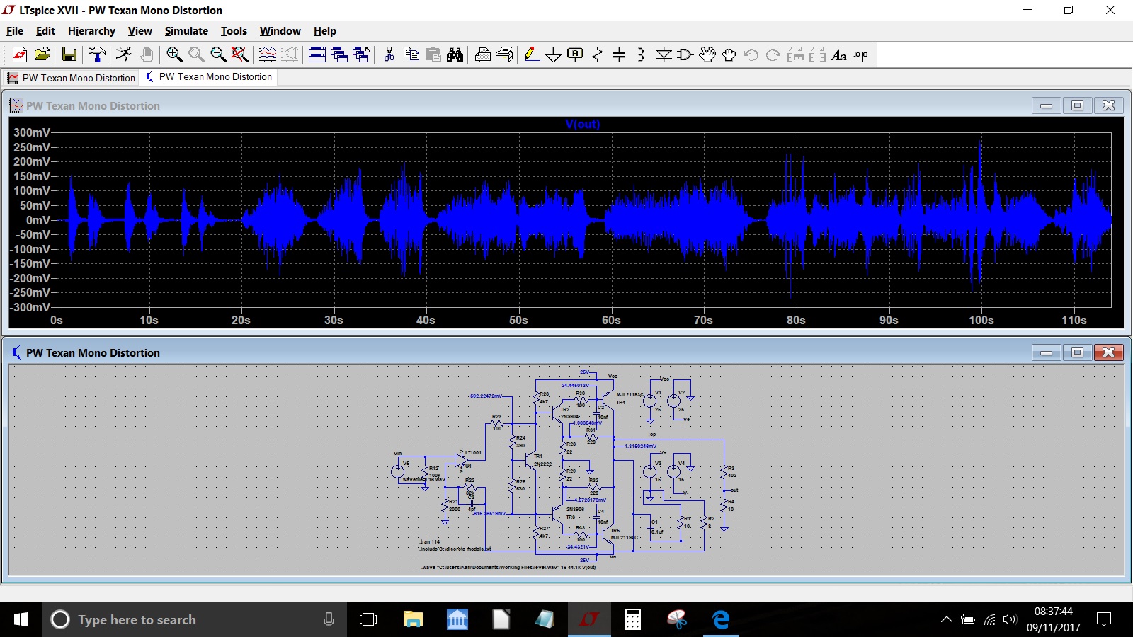

First Texan file is running. This is at normal bias and with an output attenuator chosen to give identical levels between Vin and Vout. The peak level at the amp output was around 8 volts in the short sample I used to test (the end of the Bach).

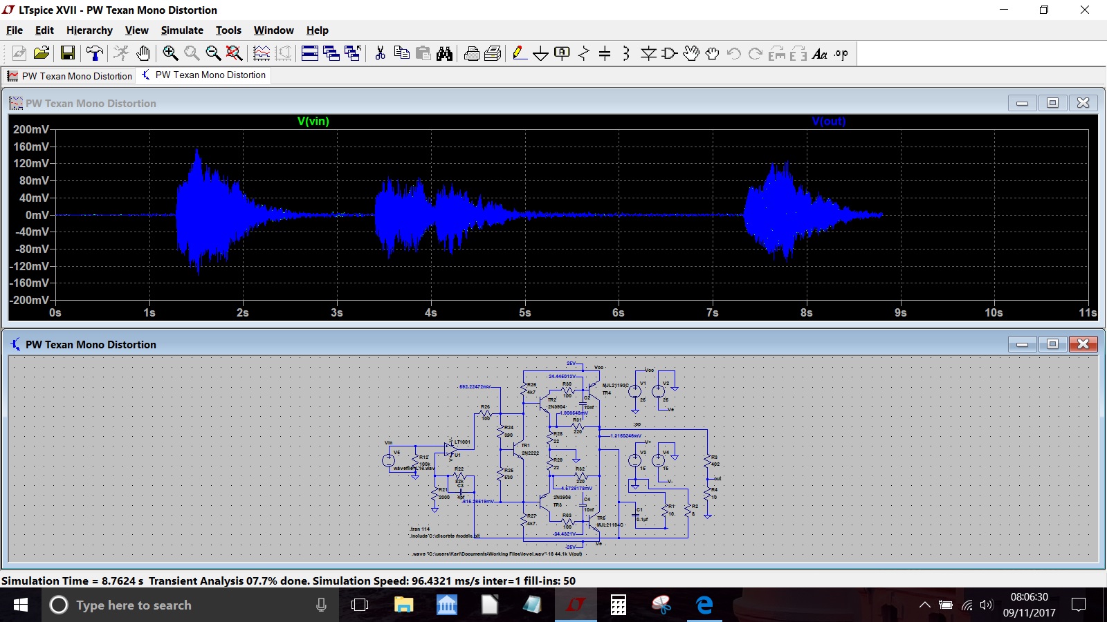

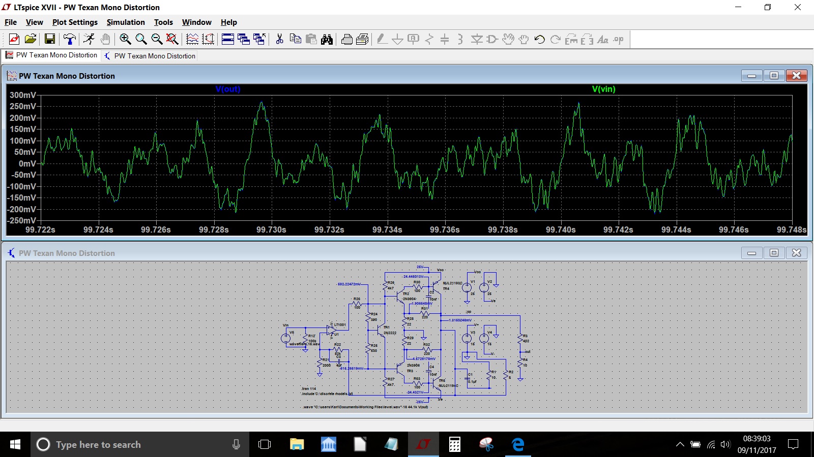

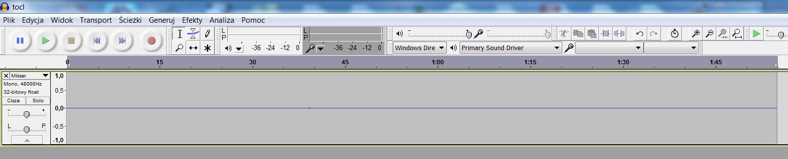

Here we are then. One file is one of the original files (tocl or tocr, you don't know which) converted to 16/44.1 and the other file is via the Texan running normal bias. The final second on both is cropped because I looked at the properties of the original and it was listed as 1'54" and set the simulation to run for 114 seconds but it seems its actually nearer 1'55".
(although LT seemed to accept a 48k input file, it does not seem to output to a 48k file. The sim appears to run but stalls part way through leaving the output file blank. I recall reading in the LT manual by Gilles Brocard that it has to be 16/44.1)

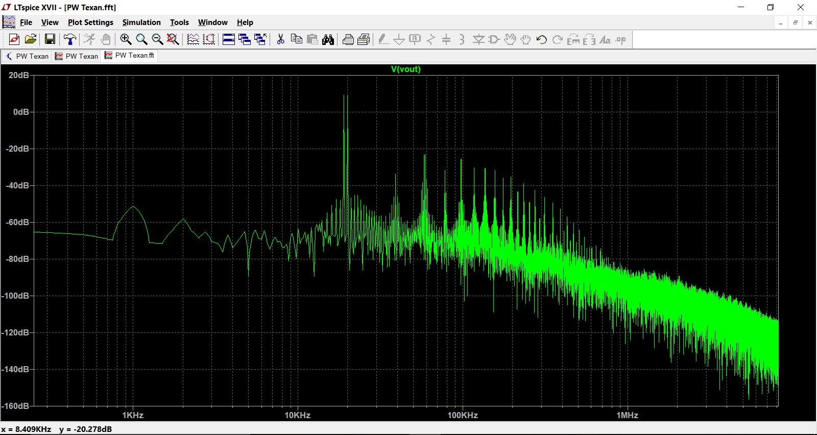

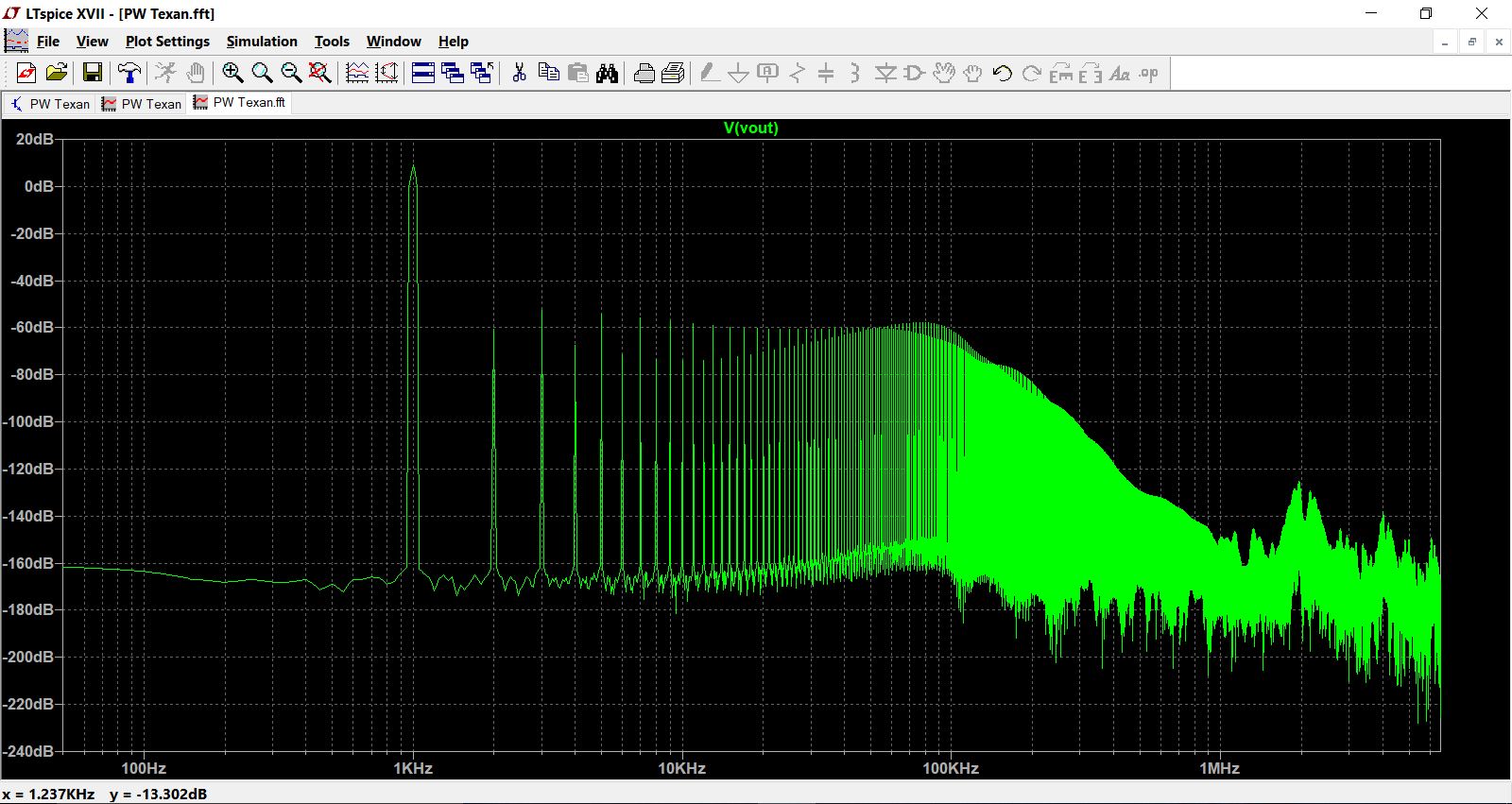

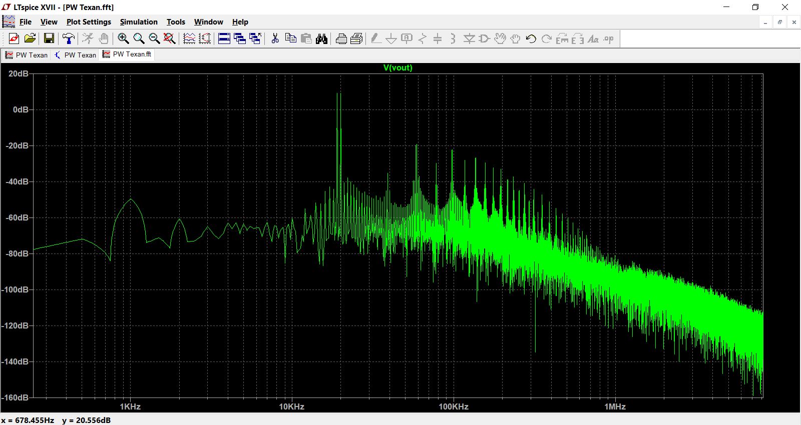

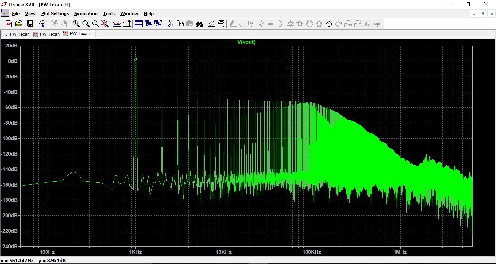

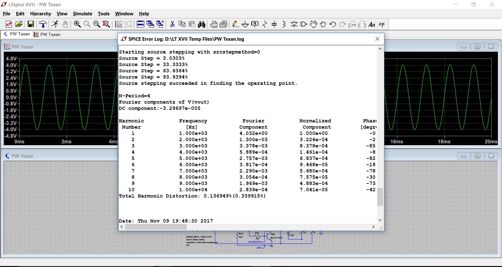

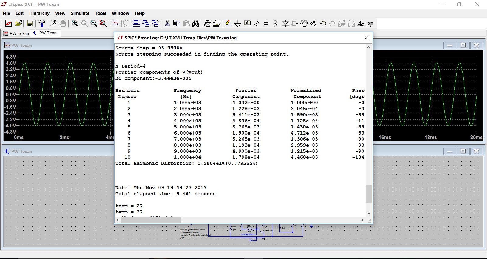

Here is the distortion for the Texan at low and normal bias.
I do wonder how realistic the Texan simulation is with regard to using the LT1001 opamp model rather than using a full discrete model of the 741.
However 🙂
I've still got my Rotel files to post (that's a real amp, not a sim). I'll get cracking and write that up.
However 🙂

These are very good questions, Dan. The original tests are in the 1st post of the thread, together with a question what you should do. The original test was recorded with OPA549 chip amplifier and the goal was to discern its crossover distortion in the foobar ABX test. The original files were in 44.1/16 (Steely Dan). For the reason that there were no statistically valid positive test result with these first test files, we started to explore audibility of the distortion of the individual 1kHz and 440Hz tone. The 440Hz tone test is at
http://pmacura.cz/440_549.zip
As we did not get a positive result even with the sine files, Mooly suggested to create and created some test files through LT Spice simulated Texan amplifier, set for normal and low bias, both creating crossover distortion, worse with low bias. Distorted 1KHz tone was easily discernible, but Steely Dan music not.
So I prepared 48/24 files with violin sound, linked again in the 1st post of the thread. We were not able to discern the OPA549 distortion again, and I asked Mooly to prepare this violin test through the simulated Texan. At normal bias, we did not hear the distortion, at low bias, some of us heard the distortion. The latest Mooly's files are in posts
