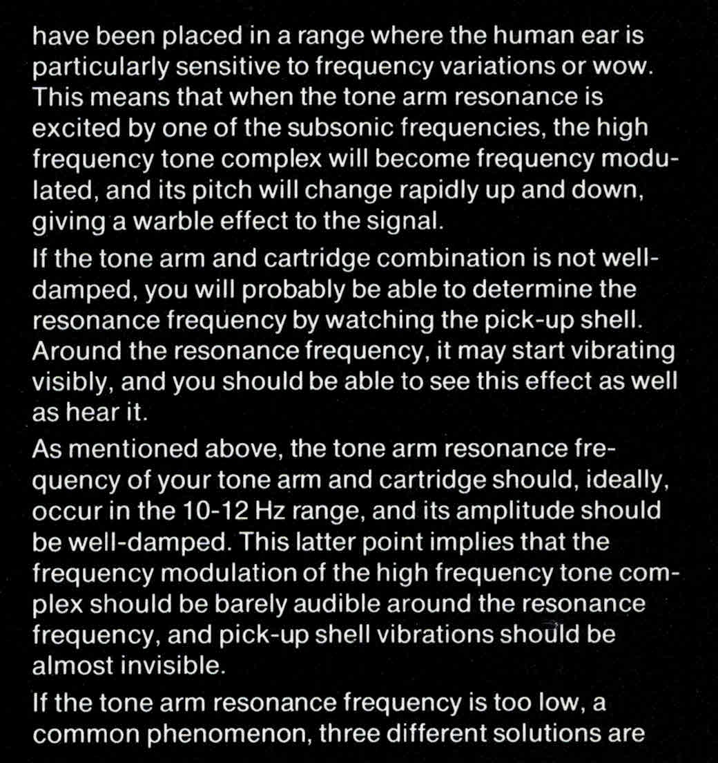

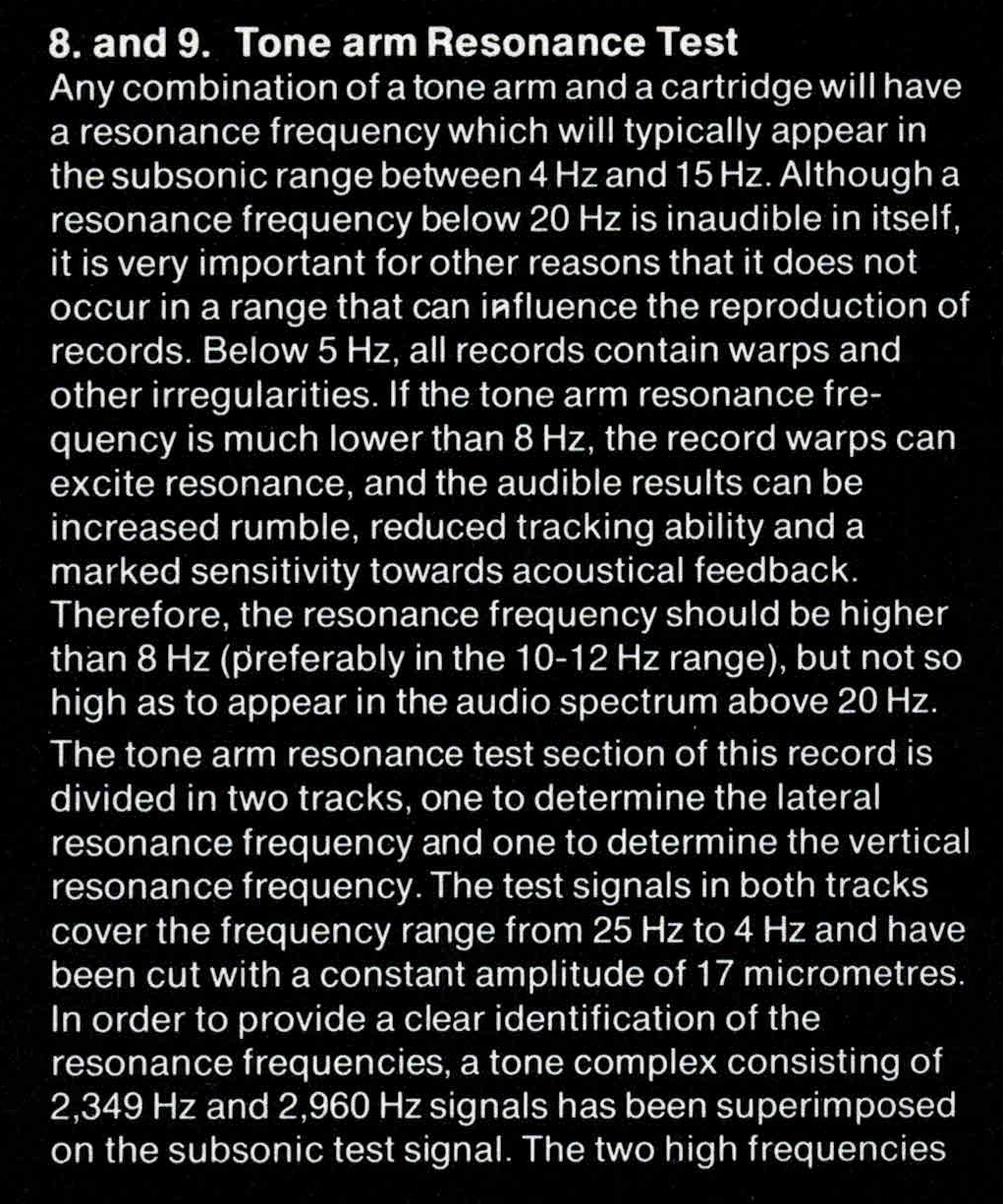

My gold standard for evaluating FM susceptability is the Ortofon Test Record #0001 and #0002, both lonnng out of print. Ortofon cut 2 tracks, one for vertical and one for horizontal. They superimposed a combination of 2349Hz and 2960Hz on a subsonic test sweep from 4 to 25Hz. The resonance test was for subjective evaluation and did not require the user to possess or use any instrumentation. I attached some of the liner notes that describe these test bands. Although the intent of the tone complex was to detrmine the mass/compliance resonance frequency (Fres), the mechanism by which the tone complex made the Fres point audible is the FM warble that the user heard when the vibrating arm caused stylus scrubbing. I think the DIY group's standardizing on 3150Hz would also accomplish the desired audible objective, plus the DIY tone complex would allow objective analysis of FM via software.
Please be aware that, for whatever baffling reason, the currently re-issued version of the Ortofon test record does NOT have these resonance test bands! (And neither does the out-of-print Ortofon Test Record #0003)
Ray K
http://www.diyaudio.com/forums/attachment.php?attachmentid=654473&stc=1&d=1515019840
http://www.diyaudio.com/forums/attachment.php?attachmentid=654474&stc=1&d=1515019840

Ray,
I still don't get what the advantage would be to have a combination of 3150 Hz with a superimposed sweep from 4-25 Hz if the only purpose is to find out what Fres of the Cart/Arm is.
Just having a sweep from 4-25 Hz will do the same IMO.
And as we have seen in various plots, a single 3150 Hz tone will also reveal Fres in the IM spectrum.
My proposal to have a strong and a weak 3150 Hz signal, separates the TT noise without Fres from TT + Fres.
I do not see this info popping up with the 4-25 Hz chirp.
And on top of that, to know Fres as just a frequency seems less important as it is to see what it does to the IM distortion.
Hans
