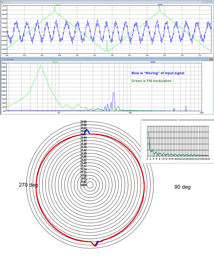

And my FM discriminator is clearly superior with some qualities which are a bit special, as explained at the time. No-one would disclose it without doing proper diligence.
LD
Do you really think your model is superior ?
I give Scott all the credits to come with a piece of SW that is as least as good if not better.
The approach with a Hilbert transform is very capable of finding the instantaneous frequency, when avoiding some well defined traps to stay away from.
I was especially not impressed by you processing of Pano's virtual TT1.
The bulges at both ends were equal in size, although the lower one in your image should be half that size.
You mentioned that your model is bandwidth limited to 40 Hz, although flutter goes well up to 100Hz and also pick up of 50 or 60Hz mains may cause IM products.
Yes, but only a small specific part of it. That part is amazingly accurate, fast, and has superior noise rejection. The rest of my SW is just cobbled together for my own use which is fine, but inferior.
That's because I didn't find any significant FM above 40Hz in practice. When you think about the physics involved, and what has to move, that isn't a surprise. 60Hz IM products should be rejected because they aren't real FM.
