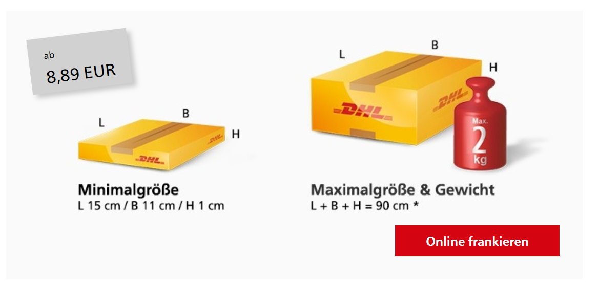

Could you please check international shipping rates from Germany? I tried to do this myself, but don't speak German. Thus I got rates too good to believe.
Figure a package 320x320x25mm and 500g. I think that's about right.
Anyone else can jump in with shipping rates from your country.
From the USA to Germany is at least $20 or over $40 for priority. Yikes!
LuckytheDog. Any thought on those signals? I would be nice to see what we are looking at. Cheers.Lucky can you generate one of your signals, or give me details and I'll do it? So that we know what we are looking at for mastering.
Looks like international shipping from Germany comes in at 9 euros (see picture for definition what parcel this refers to - can be up to 2000grams, all dimensions added should be less than 90cm, so that would fit nicely).
Insurance (delivery against signature only, value up to 50 euro) will cost €2,20 extra (EU) or € 3,20 (WW)
