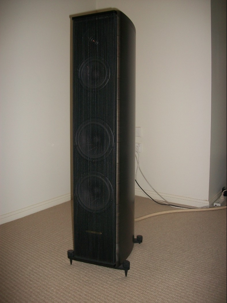

Last time I set up the Cremona’s I did it by ear. I wound up moving them further and further away from the walls to stop reflection, ending up a couple of feet off each wall. It will be nice to be able to measure that sweet spot rather than having to guess with my ears.
Currently the Cremona’s are in storage about a 1000klms away waiting to be relocated, temporarily I am listening to some Sharp 2 way speakers that belonged to a 3 in 1 that is about 20 years old. My ears haven’t started bleeding yet but there not far off it.
Maybe they would be a good starting point to practice on, so I’m not concerned about trying to make them better and can just concentrate on the measuring.

I like the pictures of the Cremona's.
