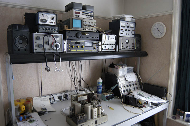

Seems those years spent in a TV studio weren't completely wasted...
Likewise. I use guttering lined with slightly crinkled kitchen foil as a diffuse reflector for the fluorescent.

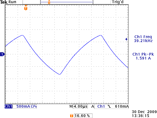

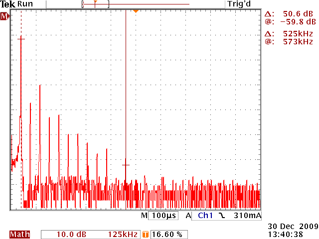

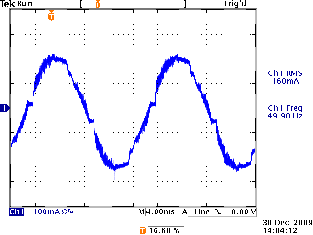

Since people were complaining about the RF noise produced by HF fluorescents and she-who-must-be-obeyed wanted better lighting for her sewing machine, I thought I'd investigate a 36W HF fluorescent before screwing it to the ceiling. The first thing I looked at was the current through the tube, which turned out to be an integrated 39kHz square wave (first waveform). Then I got the 'scope to do an FFT of that waveform to see what the harmonics were like (they go up to 570kHz). Finally, I looked at the current waveform from the mains, rather messy, but approximating to a sine wave (which is more than any audio kit does).
