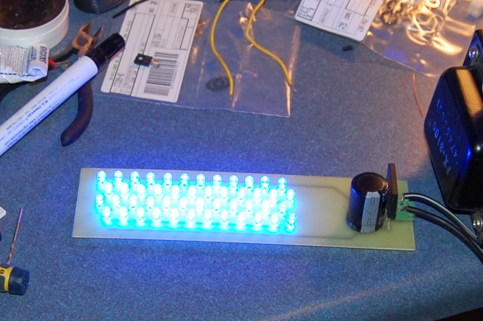

Inspired, I did up this:
48 high intensity blue LEDs (bought 100 of these ~5 years ago on Ebay). Line voltage in, bridge, 200V cap from an old computer power supply and a 2 watt dropping resistor (680 ohm, LEDs drop 3.2V and are running at ~24mA). Simplicity itself.
Casts a pretty intense light, impossible to look at directly. High fashion blue too.

I know it is hard to believe, but somebody actually got a patent on that power supply. I have a shop light made that way using white LEDs. I added a constant current source so any number of LEDs could be used, up to max voltage.
Hi Steve,
CCS is a good idea. I just calculated the resistor based on the ~16V drop at 24mA. Rectifying mains voltage gives ~170VDC, enough voltage for the 48 I used. Just playing around but I think it would make a heck of a desk light with white LEDs and a diffuser - low power, no heat.
Elektor has a project that uses blue LEDs for mood enhancement (seasonal affected disorder nonsense, you know) with a much more complex power supply. I'll make a wall mount fixture to put this in and cast a blue glow over my workbench. 🙂
why not white ? doesn't the blue bother you or change the colour of things like colour codes on resistors etc etc ?
