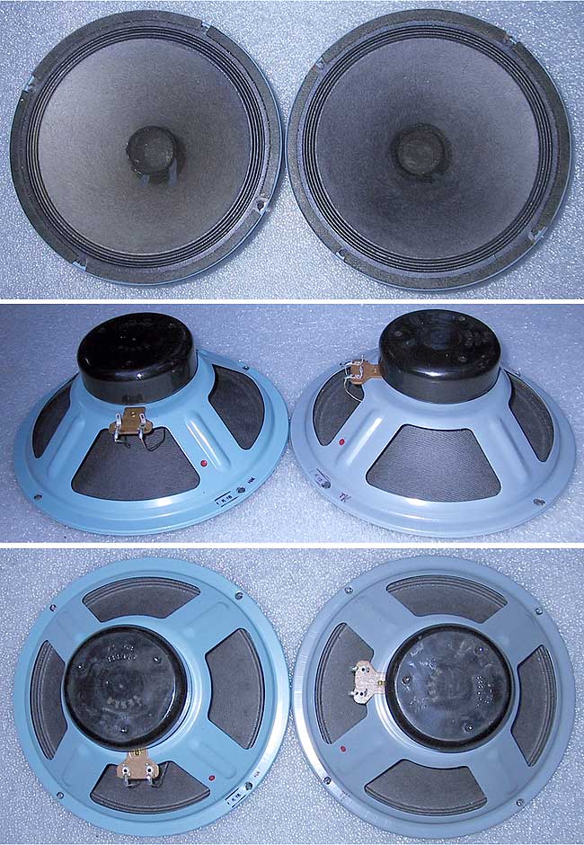

Do you mean the Tesla model, by Scientific Fidelity?
Review on Stereophile here (there are sections on specs and measurements also).
Scientific Fidelity Tesla loudspeaker | Stereophile.com

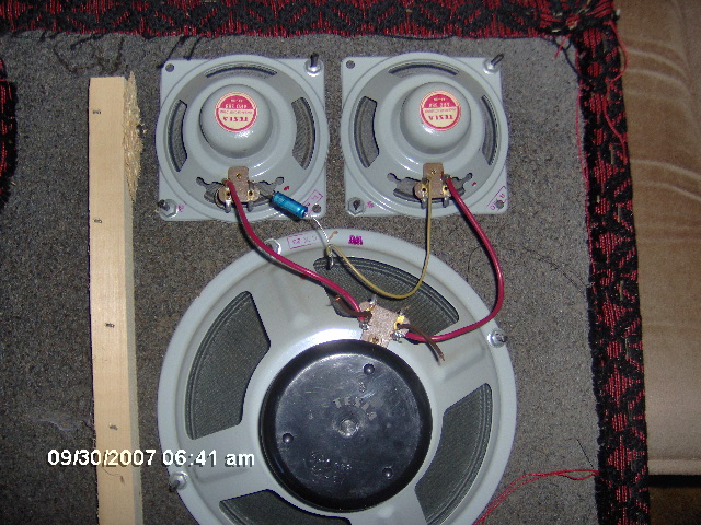

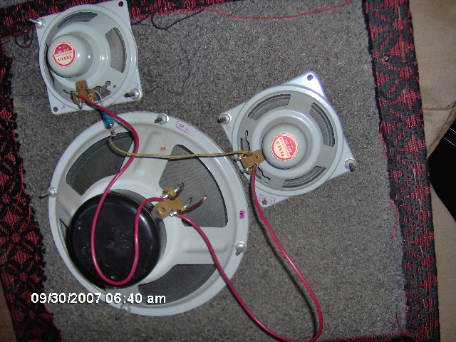

that's the exact one's i have ARO 666 and they're accompanied by two ARO 388.
all from a canadian made console branded Symphonic.
what's really strange is wiring, it appears one 388 is not high passed and series feeds the tweeter.
any published spec's on these?
is it possible that this wiring scheme when one considers the phase dots (i.e. polarity) with overlapping frequency ranges it creates a mid cut and crude loudness contour?
or does driver inductance serve a crossover function?
The tweeters in your picture are high passed with the series cap.
I don’t have T/S for these, just impedance curves. Fairly flat with a resonance peak @ about 110 Hz.

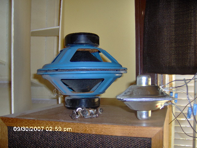

so... on a scale of 1 to 10 how do these 666's rate as fullrangers?
i'm enjoying the first set on the original baffles stock just wired to my test amp!
never been down the OB trail before.
any tips on baffle size and shape? there on 18 by 16 baffles now and give a fair show of themselves. placement i understand can make or break things no?
i've got some 100uf bipolar lytics for a quick listen.
