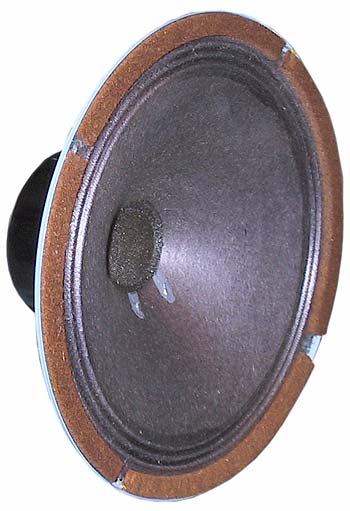

i acquired a pair of old speakers from a friend of mine. i tried researching these speakers but could not find anything about them. hopefully someone here might know.
brand and model number are Tesla ARO-666. it's an 8" speaker with a blue frame and a black plastic cover over the magnet. very vintage: thin paper cone, accordion surround, no real dust cap, instead there is a small mesh. apparently they came out of an old record player.
i built a roughly 25liter sealed enclosure for them and they sound very detailed and full as they are just running fullrange with no eq or xo. impressive for a pair of speakers that sat hanging off a shelf, in a free-air baffle, in a dusty garage on a farm for at least a decade, with the sun constantly beating on their back through the window.
anyway, just wanted to see if anyone on the forum has heard of these drivers or even the brand.

this is an obsolete model made by tesla (now tvm acoustics - www.tvm.cz) in 70s, i was trying to find something nore specific about it but their data is not very accurate
could be some 5 watt, sensitivity somewhere near 86-87 dB
its successor was ARN (i think, am not sure) 6604(8) with some twenty watts, better magent but more or less same cone

Tesla ARO 666 T/S parameters:
Qts:0.81
Vas:17.3L
Fs:93Hz.
Re:7.7ohm
Le: ?
Xmax: ?
Qms: 4.79
Qes: 0.98
Pe: 5W (as per back of magnet)
Sd: 268.66cm^2
SPL: 74dB.@1W, 1m. (seems a little low.)

It certainly does... i've had a number of these, and they were all closer to the 86-87 dB figure mentioned earlier.

All mine (except the pair i have to glue back up (they were glued, not svrewed to the baffle and didn't come off too well)) quickly went to new homes. They are quite suitable for OB use. Should work in an alpha TL or ML-TQWT as well.
