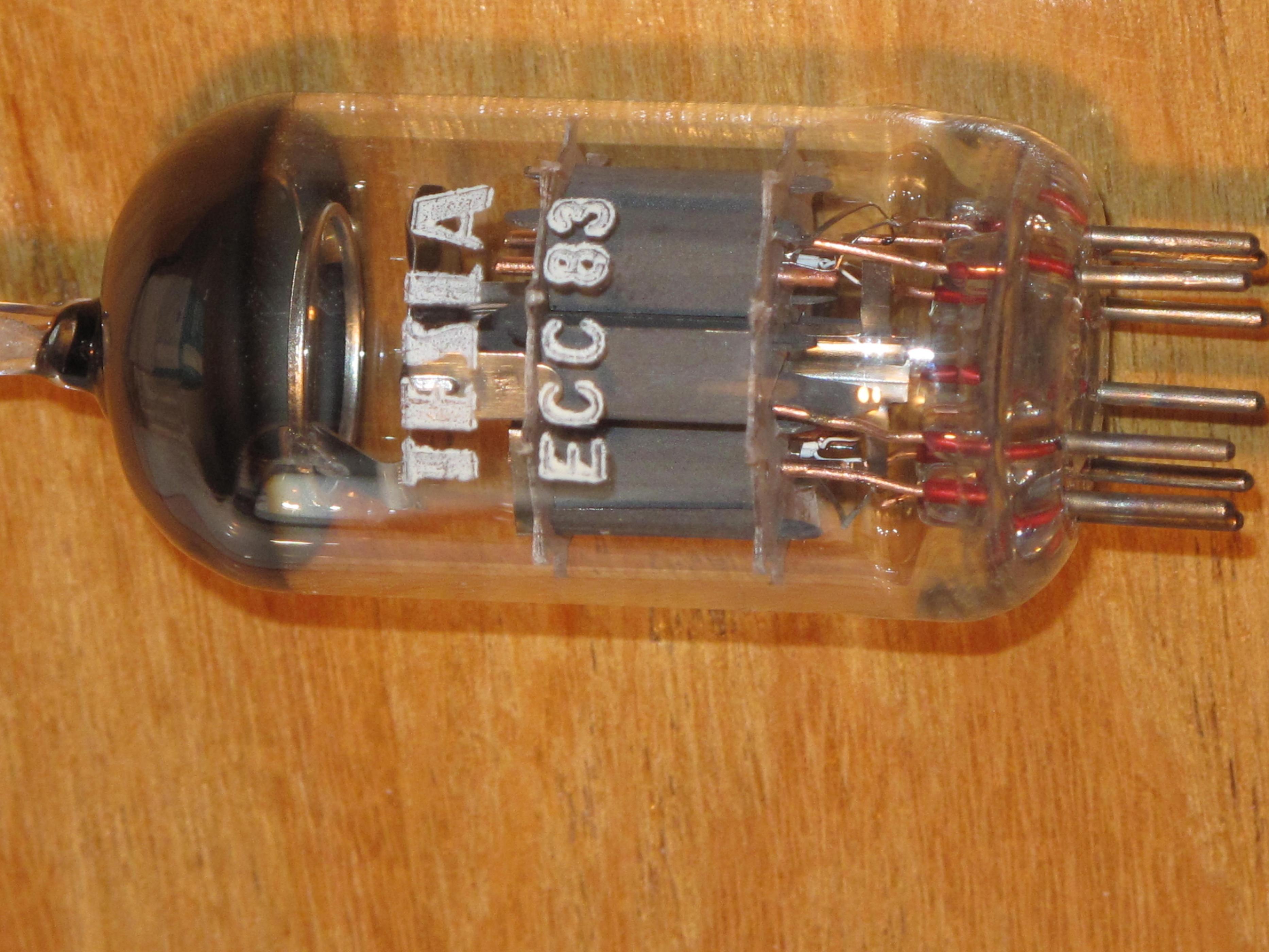

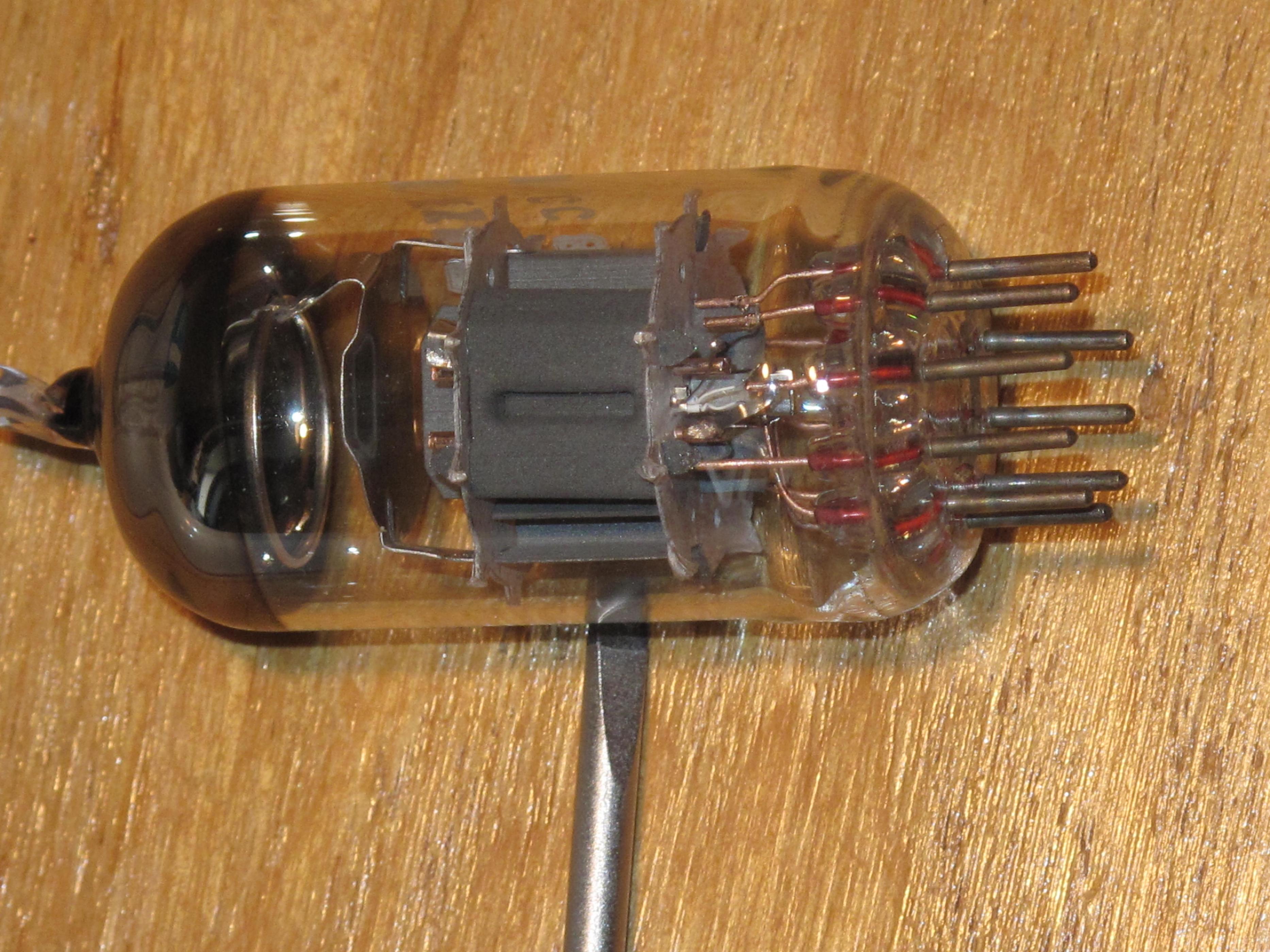

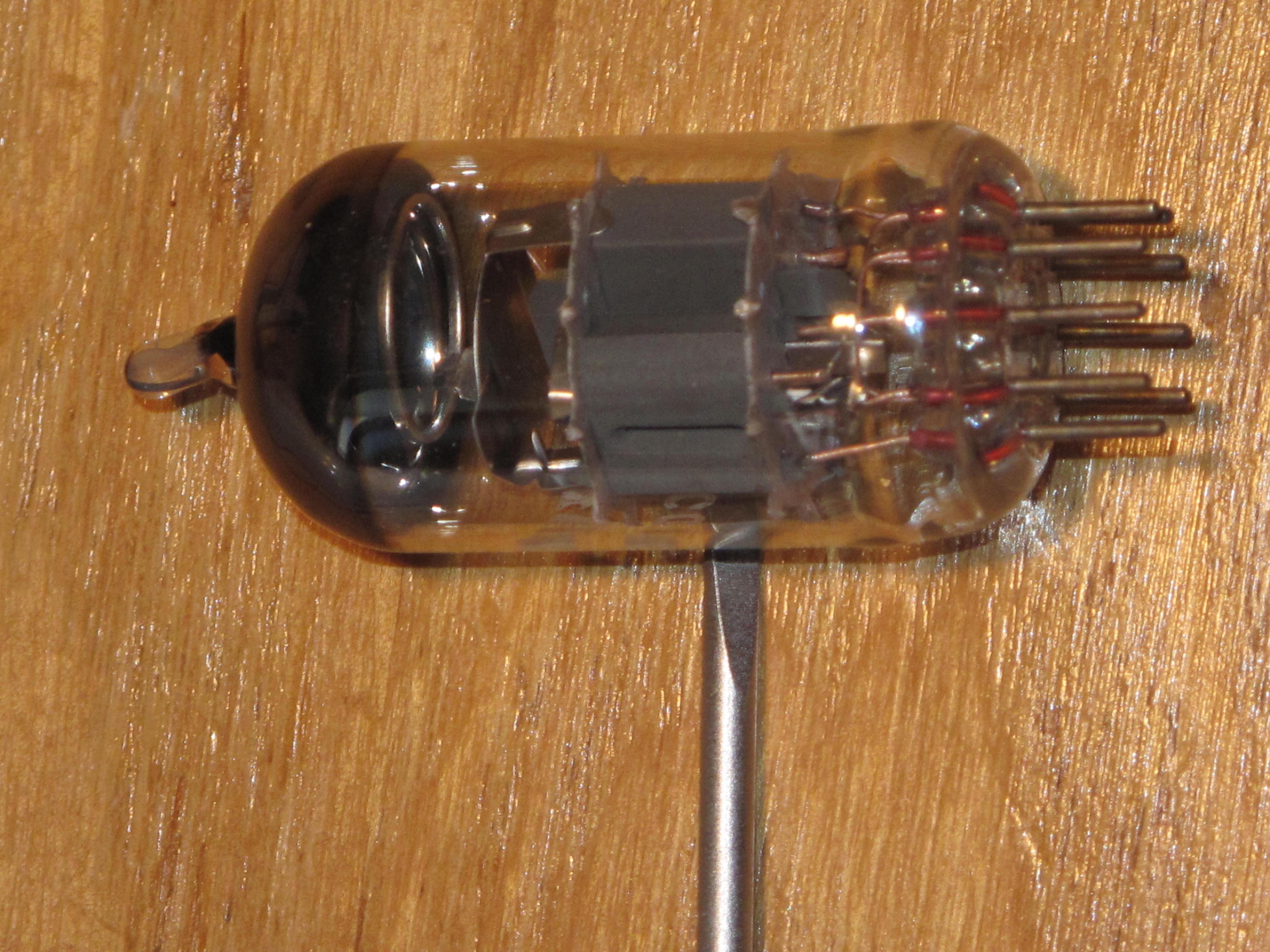

Hi Like 'jonnyque' who started this thread, I too am a novice at identifying Vacuum Tubes! Having recently purchased a Croft Pre/Power,I have become interested in obtaining tubes that may enhance the sound quality. So, amongst others, I attempted to obtain the original Tesla ECC83! It soon became obvious that this a 'well beaten road' travelled by others before me!! It soon became clear that obtaining these tubes was going to be difficult! However,I found what I know to be , a reputable Dealer who had some! In my initial exchange of emails , the Dealer stated "these are 1970s production from the Roznov factory" !! I subsequently spoke with the Dealer on the telephone who stated these tubes had been obtained as a bulk purchase at that time !! As such, they were not screen printed.(the 'Tesla ECC83' being added by the Dealer)I attach photographs of the tube.I would welcome comments !
Bulk purchases valves were usually printed. The only difference between them and retail valves is the lack of a box. Still, at least in this case the dealer is admitting that he faked the printing.
Hi DF96
I have no 'issue' with the Dealer .I know him to be an honest person.He was quite open about the source of the tubes so he's not tried to deceive me.
However, when I received the tubes I was not exactly sure what I've got !!
Of all the pictures and information circulating , it appears to me that 'my' tubes possess some of the features of the old Tesla and some of the new JJ version.
Which is why I asked for any feedback from other users!
Now, the most important issue,is how they sound and perform. For that, time will tell.However,clearly I don't wish to 'test' them if they must go back !
The shape of the glass looks more Tesla than JJ.
Yes, I agree, there are other signs that point to Tesla. The shield is coated which indicate Tesla.
Do you have any opinion on the Getter support. Most Tesla ECC83s seem to have a double support whereas mine only one?
