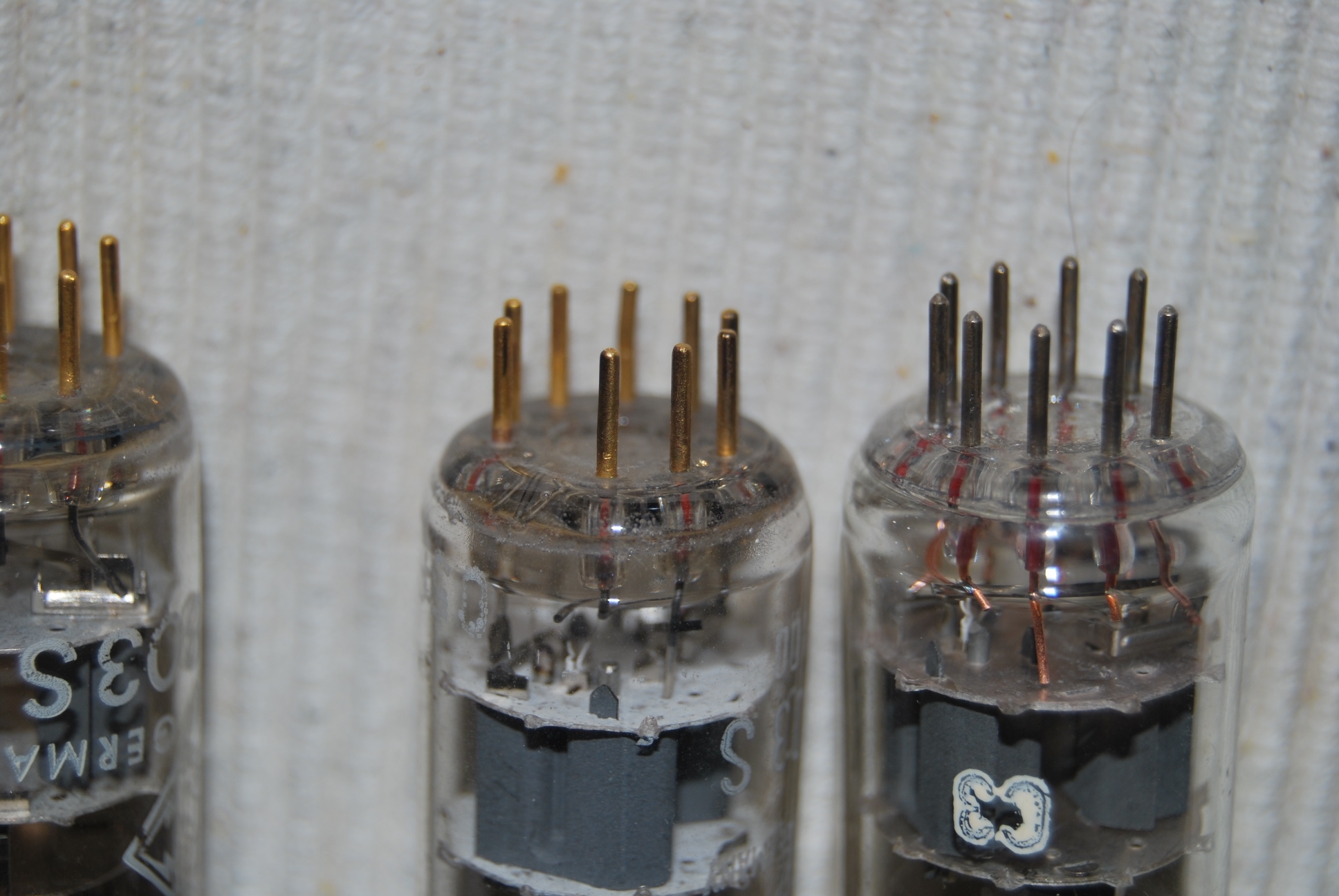

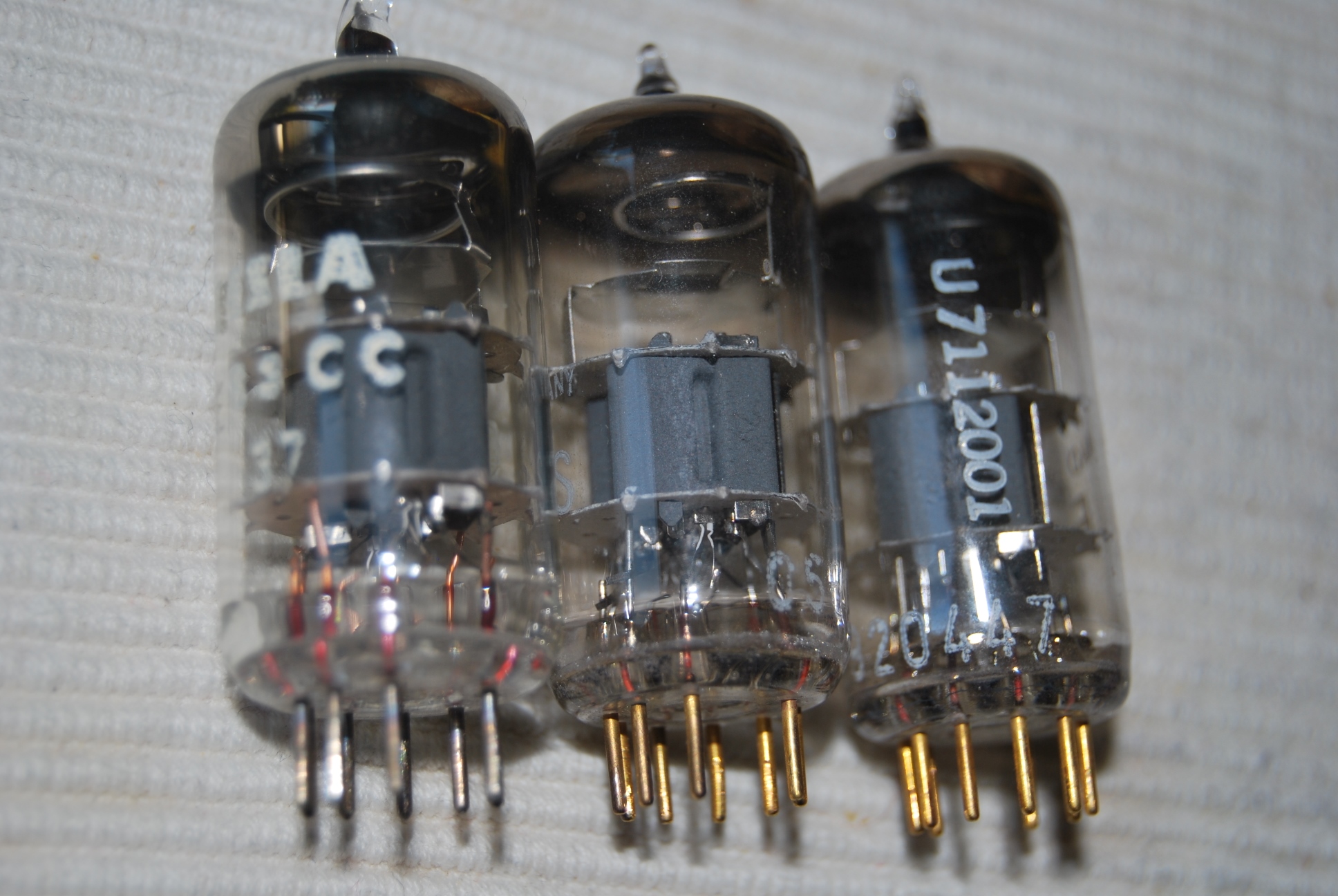

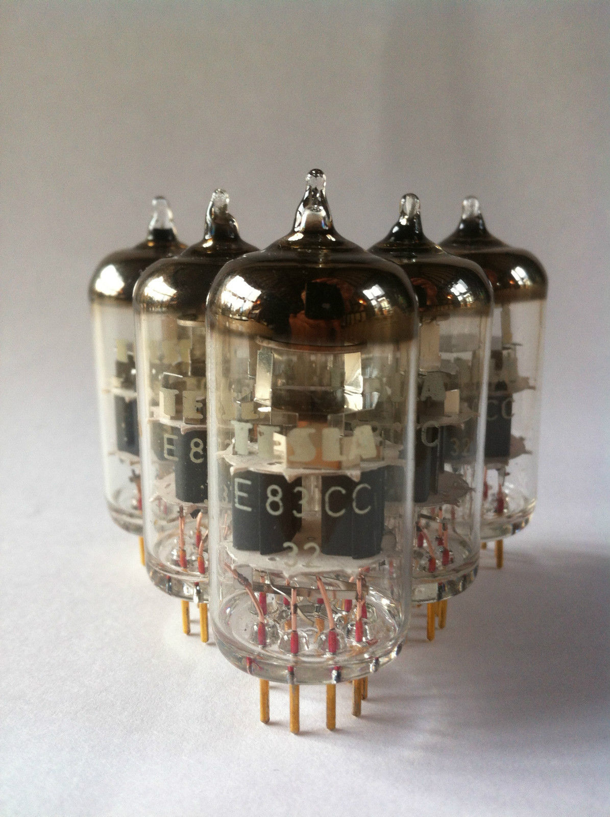

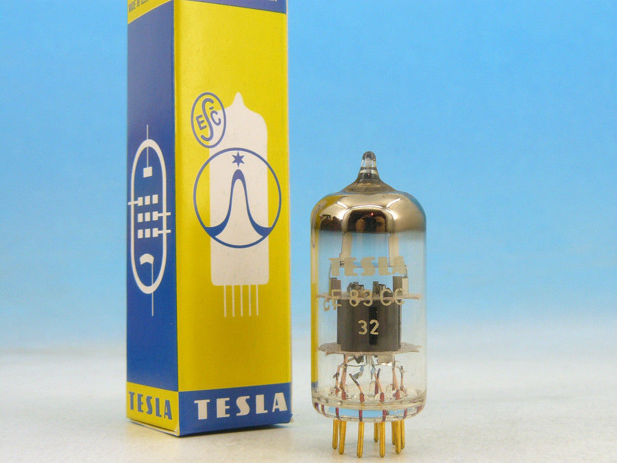

The first pic is one that I can't tell if it's real or not. To my novice eyes, the top of the tube seems flat and the inner tube construction (what I can see) seems to be a correct Tesla E83CC to me, but I'm just not sure. The 2nd and 3rd pics are of a different example, and I also can't tell if it's genuine. The 4th pic is the last example. I'd greatly appreciate experienced opinions/info.

A real E83CC, that is, one made by Mullard/Philips, and other European tubemakers, is a special quality version of the ECC83, similar to the American 12AX7WA.
As such, shouldn't the question be not is it a genuine Tesla?, but is it likely to meet the characteristics, low noise performance, and reliability of the E83CC/12AX7WA?
The tube is a high mu low gm tube for audio use. As such it should not have frame grid construction and should have short anodes. It should have the proper double mica structure at the top.
All teh tubes in your photos have pins/leads that look as though the are the proper dumet metal. I have noticed that Chinese copies typically do not.
Some genuine Tesla (and Telefunken?) ECC83 equivalents are made using a frame grid construction. The JJ 'copy' of the Tesla has anodes which makes it look like a frame grid valve, but I'm not sure that it actually has a frame grid.
Philips and its subsidiaries (Mullard, Valvo etc) introduced the naming system that was adopted by most european manufacturers. Philips put the numbers in between the letters to identify SQ versions (ECC83 vs E83CC) whereas Telefunken added a '0' (ECC803S, EF806). As far as I know only TFK published (and maintained) very strict parameters to which its SQ valves should comply.
So that means that everybody can label a 'SQ' version of their own using the Philips convention. JJ is doing this a bit creatively, as their E34L has slightly different specs than their EL34.
The original Tesla factory produced an SQ ECC83 and so labeled it E83CC. As it is almost identical to the TFK ECC803S I suspect it was made in close cooperation with TFK (possibly as a subcontract to produce actual TFK ECC803S?). And yes, it has a framegrid construction.
Tesla was a producer of valves that could hold their own to Philips and Telefunken and so are getting very sought after. Had I known this in the early 90's, I would have gotten the whole box of of those E83CC's instead of just 1 for curiosity, oh well.
As DF96 said, types equivalent to the ECC83 have no pin to connect a shield between the anodes. Neither the Tesla E83CC nor the TFK ECC803S have such a shield.
In the pictures you provided there is no shield either.
The ECC808 has a shield, but different pinout.
Possibly you are confusing some pictures of E88CC's on the jacmusic site with E83CC's.
The valves in your pictures look identical to my Tesla E83CC.
The one suspicious thing would be the gold pins. Just like mine, the ones on jacmusics site have regular (non shiney) pins.
My camera is not working now, maybe I'll post pictures later.

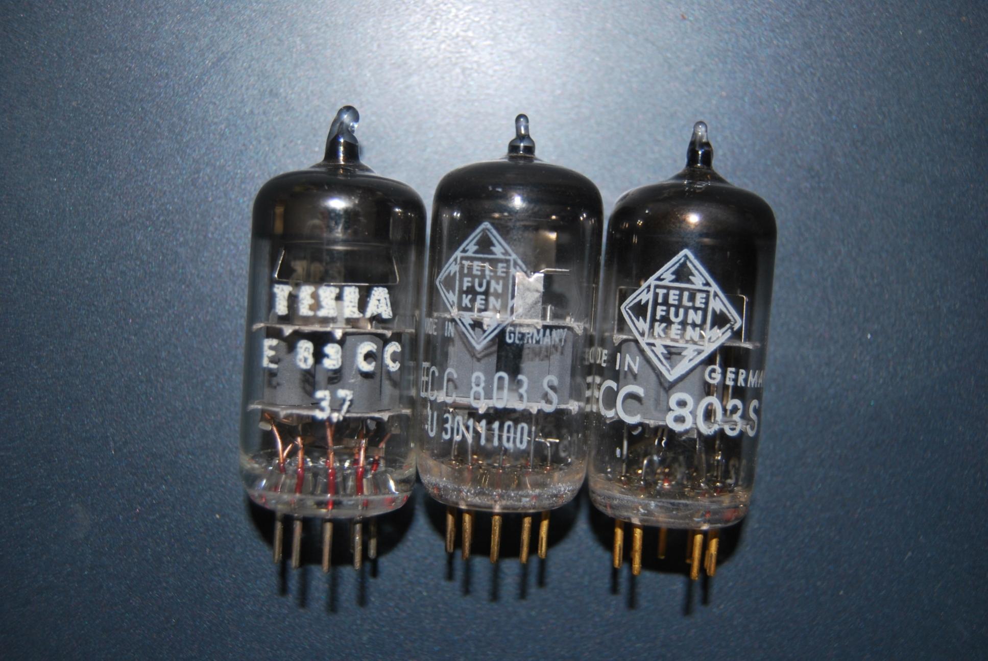

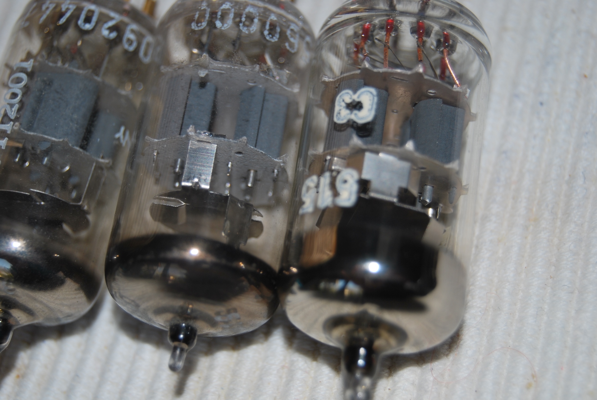

OK, I managed to take some pictures.
Hope it helps.
These are TFK ECC803S (Ulm factory) and Tesla E83CC (Rosnov factory).
Here you can see how similar they are: framegrid construction and shielded getter ring.
Seen from the top, you notice the small difference in the getter support, with the Tesla being slightly bigger. The getter ring in the Tesla is supported on two points, the TFK only on one. The mica spacers look VERY similar. There is no shield between the individual triodes.
As seen from the bottom it is clear that the pins inside the glass is very red, typical for eastern european production. The spacers are whiter in the TFK. The Tesla doesn't have gilded pins.
Hmmmm..
Huge diameter grid support verticals are visible. That indicates the tubes are probably frame grid - but not necessarily. One would have to take a tube apart and see if the to and bottom laterals are there, as well the actual grid wire. Splitting hairs perhaps.
However, it is good confirmation that the tubes have been constructed to be identical, and something other manufacturers probably would not do.
An interesting quirk is the Tesla has copper coloured leads. Only the part inside the glass button should have this colour - it ensures a gas tight seal, but within the tube vacuum it isn't perfect because it is difficult to make free of absorbed gas.
Unfortunately copying the construction is no guarantee to get the same performance.
When Tesla (or was it their owner GE USA) shut down all valve production except transmitting stuff, JJ bought the equipment and set up a factory of his own in Slowakia. The shape of the glass may be different, but the insides of their frame grid types (ECC81/82/83/88) all look the same. I was shown some of their types when I was there in 2001.
So the insides are made on the same tooling, look the same, but use different materials as the originals are no longer available.

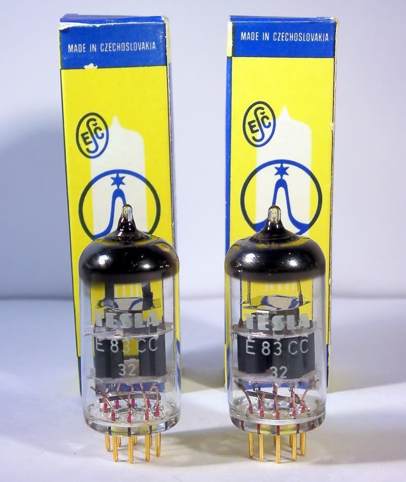

AudioFreak88, do you happen to recall if your Tesla E83CCs had gold plated pins on the bottom? Some seem to have them and others seem not to. I'm wondering if it just flakes off after enough tube rolling or if the ones with gold plated pins are a warning sign of a fake. I've read they (at least some) came from Tesla with gold-plated pins, but some people here have some that do not.
And, thanks for your feedback! That sounds exactly like what I'm looking for.
