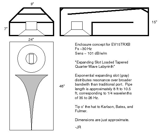

FWIW, I mentioned the K-Slot thing to Bill Wood, an Arch-Lord of the horn speaker, Jedi wunderkind of Yorkville Sound, in Toronto, and his gut feeling was that the slotback BIB was a Good Thing, ----based only on years and years of experience, and its resultant instinct.
My BIB168's are cut down on a 20' wavered angle, to increase the effective width of the mouth, plus, it adds greatly to the lines, the horizontal perimeter reminiscent of the tail of a quarter note, and overall physical perspective, especially when seated, they are fairly "tall," at 66 inches. I liked that design, as I see the BIB speaker as a musical instrument, as opposed to a box with a bunch of drivers, all connected with metallo-ceramic prosthetics, which at this point are guaranteed to ruin the sonic fun...
I think for the 5 inchers I will measure a K-slot. Just thinking out loud here.

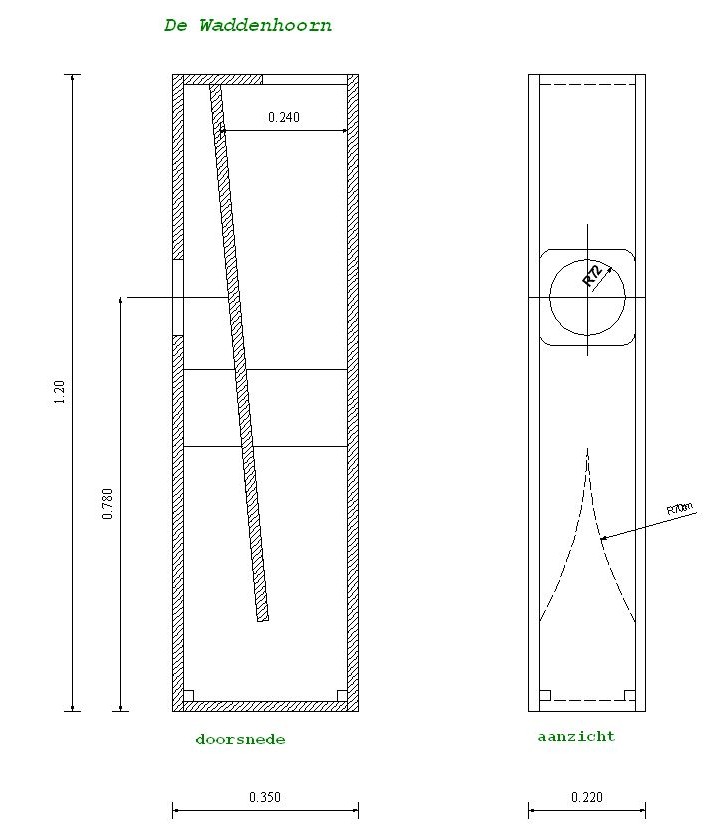

dmason the Dutch are in the groove...
found a couple of designs on Dutch site
