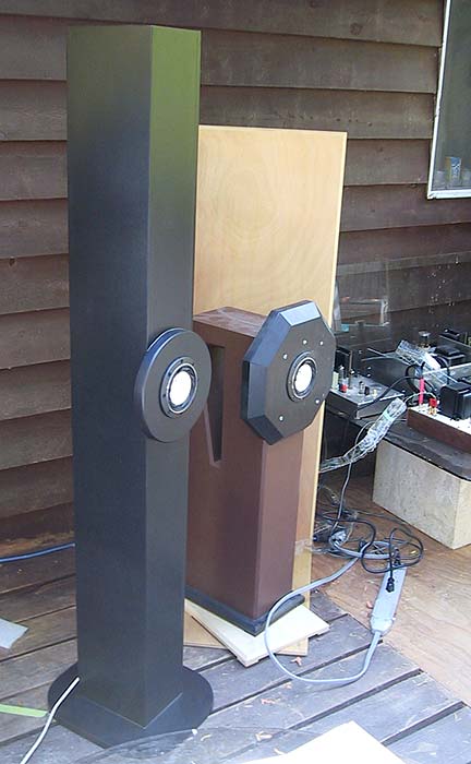

Dave has come up with a downward-firing FE108ESigma BIB box. Picture that Dave (P10 -a different Dave! ;-) posted on the FR forum. Early Frugelhorn next to it. Look's pretty impressive. I'll have to look into upward-firing enclosures for the smaller 4 - 4 1/2in drivers again.
Dave as in Dave Dormer.... my only role was to help convince Dave that an FE108eS was not a bad move. Scott & Jeff are responsible for his choice of BIB.
His Black BIBs with his newly aquired Decware Taboo was a really synergistic match. They really rocked. They lack the finese and the ultimate extension (even thou they sim to 40 Hz) of the little horn but are still very listenable and did i say that they really rock ...
dave

Curses. I forgot to actually attach that picture didn't I? ;-) Sorry about that!
Glad they rock out -something these boxes are rather good at for FR units. Regarding the limited extension, I don't know the exact dimensions that were used (I've PMed Dave about them, and for the measurements), but for what it's worth, going by the info Dave has posted on the FR forum, my suspicion is that the driver position too far along the line is lowering LF output by reducing gain, and that some of the terminus output is being shorted by the floor-venting. Back cutting it at an angle a la TC's could probably help out there.

just got an email from dave explaining that the dimensions he used for the inverted bib are basically the same except the front and sides are extended about 14(?) inches and attached to a base. would it be preferable to scallop the sides a la terry cain or just attach some legs leaving the bottom open? when flipped over the driver is less than 18" from the floor so they would have at least 12" long and strong enough to hold the substancial weight of the bib. i can only imagine the mdf monsters some are building.:worship:
Yeah, got one from Dave just now. It's a good idea to get the driver nearer to ear-height. The only possible issue I can forsee with doing that is that you move the terminus away from the floor, and it might loose out on some of the room's loading. So do the upward-firing versions though.
Fatiguing? I'm begining to see the light, especially when you mention the glass doors to the rear. Sounds to me as if you're getting a bit too much midrange out through the terminus, so before experimenting with adding a stand to allow it to be flipped, try increasing the density of the stuffing on the base, which should help somewhat, and then possibly add some thick grill material over the terminus -Greg suggested this a while back. Not only will it keep the dust out, it should help attenuate the highs coming out of the horn without damaging the LF. If this doesn't help, the stand and flipping it inverted will be probably help out.

Thanks for the interest in my BIB. When I first got the dims to build a BIB for the 108, I knew I wanted to change it up a little bit and have it firing downward and I wanted to have the driver higher up from the floor. Then I saw a pic of the TC design for the 108 and I thought hey I'll style them after that. I used all 1/2''baltic birch ply and it only comes in 5'x5' sheets here.
My Bib is exactly the dims that were given to m except I made the front piece 60'' and the sides 60'' and attached a 3/4'' fir base to support the cab. The round baffels are two pieces of 1/2'' baltic birch glued together and the circle diameter is 9.25''. The one thing I forgot to allow for was to increase the depth to allow for the internal divider, so whatever depth you were given for a 108 bib build just keep it the same if your using 1/2'' material and you'll be exactly how I did mine. I wired with cat5 which is just so stupid good for the price, I think I paid under $3.00 to have speaker wire for both speakers.
In my room they sound really nice, great detail and good bass, the 108 driver amazes me all the time that such a small driver can do so much, I love it.... Dave.......
