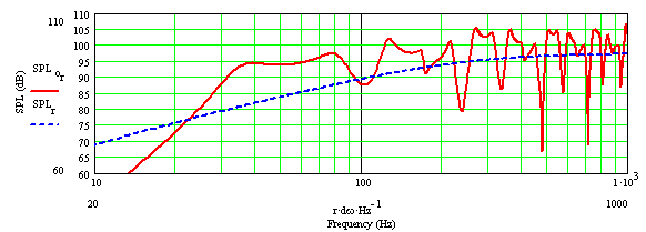

Variation on the FF225K theme. I'd built a pair for a friend before Christmas, and they've been playing ever since. However, his better half has just forced a change in furniture, and the drivers, which were already a bit high, are now way off-axis. So he asked me if a shorter version is possible. It is. Final cut off is a bit higher, obviously, but otherwise things look similar, and they should still produce plenty of LF. The FFs are very under-rated -probably due to that small Xmax, but it doesn't appear to be a problem when horn-loaded -without room-gain these are still about 94.5db 1w input efficient at the worst, and that's before you bring the average ~3db -6db boost you'll get from rear / side wall or corner placement. My 165s have never even come close to sounding strained.
Line length 138in
Zdriver 28in
Sm=118.125in^2

FE168 in FE167 BIB?
I am currently listening to a pair of FE167 drivers in Bob Brines cabs - sound well beyond my expectations. But having read this thread start to finish I now NEED to build some BIB cabs. Ultimately I will get some FE168EZ Sigma drivers as these seem to be the way to go. My thinking is to build some BIBs for the 167s and put the 168s in at a later date. So my question is, using the 168 sigmas will the 167 cab sound any worse than the 168 cab? If I am wasting my time fitting 168s into 167 cabs I will simply build the correct ones however what I read seems to indicate relatively small increases in line length and Sm should have little effect. Maybe I could even ask some kind person to do a sim of the FE168 Sigma in the FE167 cab (L=136", Sm= 87.75, zd=27.5).
Also my room has 10' ceilings, I have read something regards room gain and speaker/ceiling height but mainly around smaller BIBs. Does a 10' ceiling pose a problem for this BIB?
