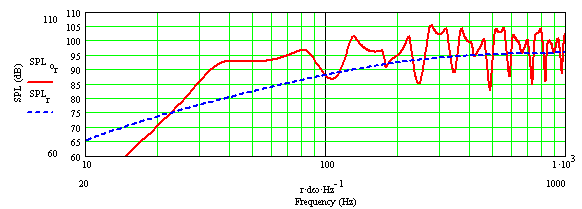

I'm in the making of a pair of BIB's for my Fostex FE 166-ESR. I can barely squeeze the design on two boards of plywood and have to reduce Sm by one inch.
Will that small difference have any affect in sound?
Thanks to everyone that makes this project possible!

Hi dmason,
the differance in volume between the squeezed version and original will be 1.3 gallons (5liters). From what I've read in this thread the Bib's are quite forgiving. I wonder how far you can stretch dimensions before the "optimal load " goes sour. I'm reluctant to fork out 100$ for one more board, but neither want crappy sound.
From what I've read Bluemenco is very satisfied with his 166-ESR BiB's, words like magic and eerie comes to mind.

Where did Greg's post go? I dunno, must've been quick, 'cause I didn't see it at all. Strange. Anyway, Vb is the internal volume of the enclosure. While I'd agree with Dan that the ES-R deserves the best, a small difference shouldn't be too drastic, as the response is altered by the room anyway. Attached is a rough 1/2 space plot for the ES-R in the smaller cabinet.

Thanks Scott!
You did the plot without me asking, great! Comparing the two there seems to be minimal if any difference, so I'll happily go along with the smaller design 🙂
I'm really looking forward to hear the BiB's when they are ready, work will start this weekend. More info and pics later. The drivers have been playing in another temporary construction for 4 months now and they are getting sweeter every day!

They are only 'forgiving if there's enough boundary gain, but the sim appears to assume no series R, so you could be left wanting up to 2x more Vb if you have to use it to flatten its in-room response, especially if you start out 'short'.
If you don't need any though, a 5 L (~5%) reduction shouldn't make much of a difference.

Thanks for the plott, Scott. Every picture tell a story. That one says to me that the reduced CSA load will work fine, but I also perceive that there will be lost the throati-ness that comes with that extra reach of 5 cycles or so before the illustrated roll off of the "optimal" load, optimal being in quotation marks.

They are only 'forgiving' if there's enough boundary gain and the sim appears to assume no series R, so you could be left wanting up to 2x more Vb if you have to use it to flatten its in-room response, making a 5 L (~5%) reduction seem insignificant. That said, $100 is a bit much for ~5 L, so I guess it boils down to how much tunability you're willing to afford now and whether or not you're willing to make new, larger cabs later if need be.
