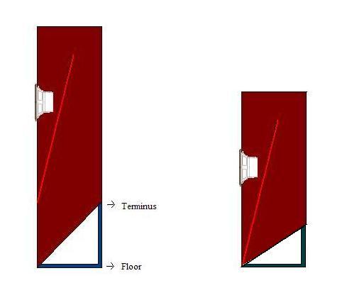

Inverted BIBs
GM wrote:
It is my understanding that highish Fs drivers are more suitable for an Inverted BIB.
But here are some questions:
- Do low Fs and low Xmax drivers also benefit from a shorter pipe when used in an Inverted BIB? Example, 56Hz Fs and 1mm Xmax from the Veravox 7x.
- Zdriver is adjusted when pipe is shortened for a “Normal BIB”. I'm just not sure if/how this applies to Inverted BIBs and what variables are involved (?).
I'm uncertain which drawing below is correct. But I surmise it's the one on the left?😕 Thanks!

Thanks edjosh23.
Yeah, the drawing on the left chops off the actual terminus at an angle, thus shortens the recommended pipe length - not right.
I'm still curious if a driver with 56Hz Fs and 1mm Xmax will work with a shortened pipe... Zdriver will be adjusted (I think higher) when pipe's shortened for a normal BIB... If the BIB is inverted, the driver postion becomes low, so an extra pedestal is needed to get the driver position circa ear-level .
fred
fred
Err, correction. I meant the drawing on the 'Right' is wrong.
fred
