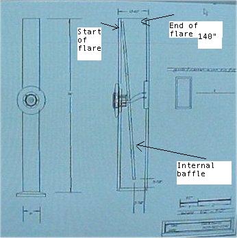

Last offering regarding these pipes, as I think I can now suggest how they are sized, which might be of use to someone.
Total line length, as we all know well enough, is set to 1/2 the wavelength of Fs. Generally. You can play with that -this is probably best followed for drivers circa 50Hz lower, and you're going to get a L-O-N-G pipe indeed.
They are So=0 pipes (we all have exceptions to out rules, and this is mine!), Sm terminates in free space, and is set to approximately 4.25Sd. I say approximately, because there's room for experiment there. That said, based on Martin's explanation of the acoustics, and Terry's suggestion of chopping the back down to increase the mouth area a bit (though I have a hunch that he suggested this more for those running 6"+ drivers in the original pipe, which was designed for the 5 1/4" RS 1354), I wouldn't think going lower would be advisible. Increasing it by perhaps 1/2Sd will probably be OK though. Where the internal baffle ends depends on construction material. It'll terminate in the mid point of the cabinet, the same distance away from the floor.
Driver height appears to be determined by ye olde Voigt pipe equation: D = L + the cube root of So / Sm. It'll usually work out to be around 0.275 of the total line length. Stuffing depends on the room and driver. The point needs a bit, and about 1/4lb or an inch or so of felt on the base would most likely be a good starting point.
And that's it! Easy eh?

The completed cabinet is seen in the first picture. (ignore the second, that's just a Voigt Pipe, and well worth ignoring, except to admire Terry's gorgeous cabinet work) The design for the BIB is shown in the CAD screen shot at the bottom of Terry's article, which provides the basic layout for you. I've attached a tagged version of this to the bottom here, which might help.
Basically, the original BIB cabinet is a rectangular box, 70" tall, constructed from 1" thick material. Attatched to the inner surface of the front panel (or baffle, if you prefer), is a sloping, internal baffle, that in effect splits most of the cabinet in two, a front part, and a rear part. This baffle descends diagonally downward through the cabinet until it finishes, 5 1/2" from the floor, and 5 1/2" from the front and rear walls. The That's where the 140" flare comes from -the flare begins at the pointy top, runs to the bottom of the cabinet in the front part, then all the way back up again in the rear part. The top is left completely open, and that forms the vent / horn mouth. So in a sense you were partially correct -it's a 140" tall TQWT that's been folded in half to keep the size down to a managable, but still considerable 6 foot. I'll try to draw a clearer diagram, but I'm afraid I don't have any CAD software, and I'm not too great at such drawings (perhaps we should ask Dave [planet10] nicely, though I suspect he's snowed under with different cabinet designs at present!) I've added a few tags to Terry's original CAD drawing below, which might help.
