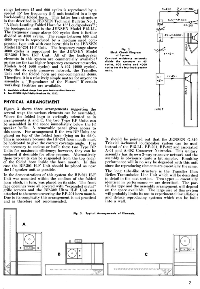

If you wanted to use a BIB as a sub-woofer would there be issues with lying it on its back as opposed to standing up? My room (like most) is longer than it is tall.
Other than having to use a driver with specs suitable for up/down firing [low compliance] if one doesn't want the driver on its vertical face and/or the loss of one boundary loading if not long enough to span ~80% of the distance between two corners, this makes for a space efficient platform for speakers, equipment which is what I sometimes used them for after reading about this early '50's variant [now considered a tapped TL]:

I'd wonder if you were wanting to use a BIB as a sub-woofer, that maybe a Tapped Horn may be the better option in the long run? Thinking about size and delay issues with a BIB used as a sub?, not sure etc..
