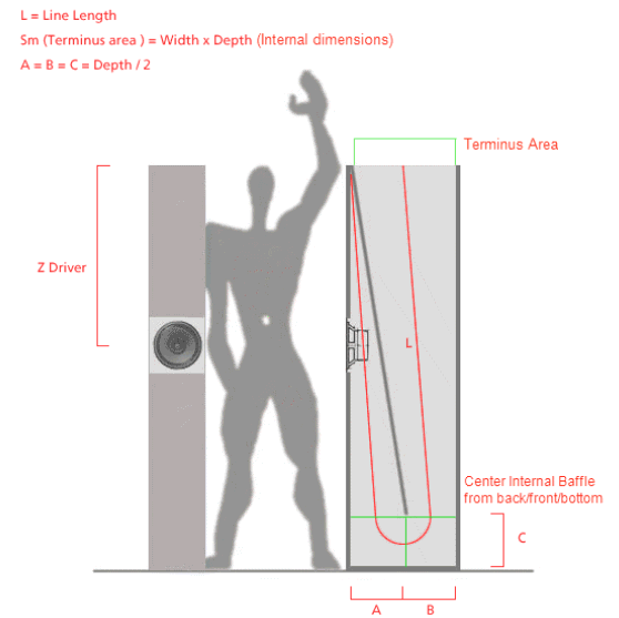

_henry_ said:hi greg,
i got beymas not long ago. i did try them in OB, but i would like to try with TQWT.
previous post on Terry Cain BIB
Greets!
L = 138"
Sm = 440"^2
zdriver = 30"
So, assuming 3/4" (19 mm) material thickness (all dims i.d.):
h = 69"
d = 24.96"
w = 17.625"
A-B-C = 12.48"
this is the post u made from 2006(sorry quite awhile).
what is Sm? i know that L is the length and zdriver is the position of the driver from the top, am i correct?
how about the size of the exit port?
would u mind elaborate more?
thanks alot
henry
Greets!
Ok, that sim is for a BIB of the same folded height as T.C.'s BIB and sized with my original formula. With the revised formula, it's somewhat larger: Sm = 679.674"^2.
FWIW, here's a full size BIB and the one I recommend if its size, relatively high driver location is acceptable:
L = 160.292"
Sm = 585.205"^2
zdriver = 34.783"
So, assuming 3/4" (19 mm) material thickness (all dims i.d. and approximate):
h = 80.146"
d = 28.768"
w = 20.342"
A-B-C = 14.384"
You say TQWT though, so wondering if you actually want an inverse tapered TL, the opposite of a BIB's expanding TL [horn].
GM

BiB sims for Tang Band W4-930SF 4"
Guys
Can any of you Sim the Tang Band W4-930SF 4" Paper Cone Full Range
and tell me what you come up with for Width Height & Depth
in BiB
this driver looks like a good candidate any thoughts.
4" Paper cone full range
Rubber surround
Neodymium magnet system
Imp - 6 ohm
Fs - 70Hz
Qts - .47
VAS - 8.7L
SPL - 89dB
Xmax - 2mm
Guys
in BiB
Rubber surround
Imp - 6 ohm
Fs - 70Hz
Qts - .47
VAS - 8.7L
SPL - 89dB
Xmax - 2mm
Guys
in BiB
D internal - 11.09"
W " " - 7.792"
Z driver - 20.87", a-b-c - 5.51" , line length - 96.175"
rounded external (wood width 0.750")
D - 12.5"
W - 9.5"
H - 49"
simon

Would the CSS EL70 work with these same dims.
Also how far from top of cab to center of speaker placement.
Thanks wagtail.
EL70 dims, inches
w =8.5
d = 11
h = 53.5
top of cab to speaker centre (z driver) = 22.87
for TB = 20.87
