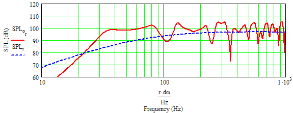

Looks fine in the TC 'stock' height cab, so punch in a 48.78 Hz Fs to get the rest and I'll let you decide if you think it will need a sub system once they are EQ'd ~flat in-room:
GM

Bigger is better right? When it's not costly and actually preferable to go bigger, how big is too big?

When you end load a horn the 'sky' is pretty much the limit, but the downside if you have the $$$/space to build such a behemoth its acoustic mass lowers Fs with increasing size it's also over-damping a 'FR' driver's mass controlled BW, so once it reaches a certain mass (horn Vb) you have little/no ~flat BW output above the horn's HF mass corner (same as the driver's originally) and far enough down in output to be of no real use.
For example, here's one I did awhile back to prove several points, though now that Hornresp can combine a pistonic response to it will serve well enough for this one also. Note that it wouldn't let me input a long/large enough horn, so even with corner loading it's not as smooth/flat as what theory predicts (set Ang = 0.0 for infinite to see how 'perfect' the math makes all its plots).
GM
