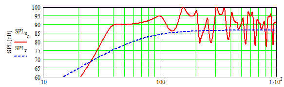

inrank said:
has anyone used a FR125s in a BIB (back loaded corner horn thing?).
what excatley is a BIB?
Greets!
You answered your own question. 😉
Anyway, measured Fs for this driver is 'all over the map', so I split the difference at 56.5 Hz:
L = 120"
SO, SL = same as the original
zdriver = 23.5"
GM
