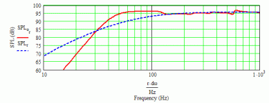

Looks like a BIB isn't 'in the cards'.......
Hmm, BB ply is 60" square, so if getting closer to the edge is OK, this MLTL may work, though like any MLTL there's the issue of blending a smaller CC to them if he doesn't set them to 'small' and XO to a sub when used for HT:
L = 57.5"
CSA = ~113"^2 (recommend 13.5" W x 8.375" D)
zdriver = 20.875"
zport = 45"
port = 4" dia. x 0.75"
density = 0.2 lbs/ft^3 down to the port
If 'boomy' in-room, either more damping and/or a longer vent can be used to roll it off.
GM
