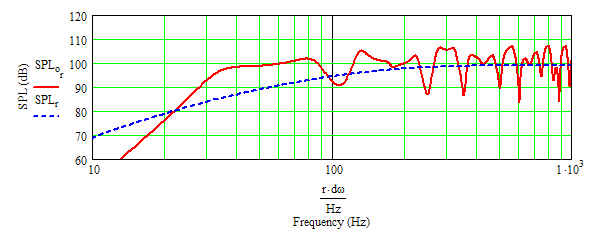

I'd think the $11.60 Sammi at e-bay might do OK in BIB and models ok for Cyburg's "Viech". It may need a helper due to 2" voice coil. It has high fs. is stiff but pretty lively with ~2.17% caculated efficiency. $11.60 isn't a bad gamble - but a horn might be.
rough guess at BIB set to get 1st z peak higher than 2nd (if that matters in pipehorn-?)
Sammi - guess at BIB vs Viech
http://img261.imageshack.us/img261/4532/roughbibvsviechum6.jpg
