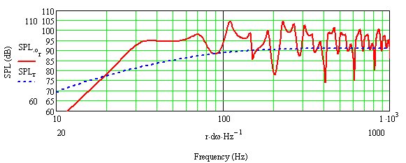

Was this the sort of thing you had in mind for the F200a Greg, or would you go for a different CSA? It seems happy enough with a 126in^2 CSA, albeit slightly rolled off at the bottom end, but I reckon the driver would be happier with the greater volume.
Line 160in
Zdriver 32in
Sl 190in^2.
Scott
Line 160in
Zdriver 32in
Sl 190in^2.
Scott

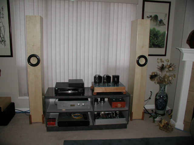

Albert,
VERY nice indeed! Looks like Maple?
Tell us about that amp which looks like maybe Mr. Beck's 807, or 1625? Is it the Electra-Print circuit perhaps? Very interesting.... I will be in Vancouver in March, perhaps we can get together...
dmason,
Yes, they're in maple. boxes are CNC cut with finger joint, glue only absolutely no nails. legs are made of rose wood, 2 out front and 1 in the middle at the back.
Hope they will surprise me more after the break-in
That amp is 1625 in triode

Mr albertli,
I note in the photo that your speaks aren't in the room corners.
Is this how you listen to them? Or is that just for the photo? They are against the wall which should help a lot and I guess one is kinda in a corner.....Would be very interesting if you thought that they put out enought bass without being in corners...
