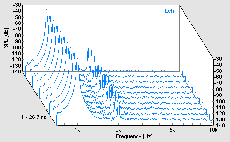

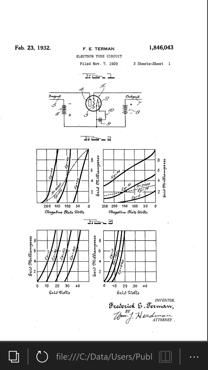

I looked at Terman's circuit and put it in a feedback loop, very interesting FFT but H2 is maybe too low, only 10db higher than 3rd.
Thd is very low on the Terman so I sent out the board with capability of operating in all three modes described in Glen Richardson's 1952 inverted triode thesis. All of the circuits have data from very low voltages (zero) .

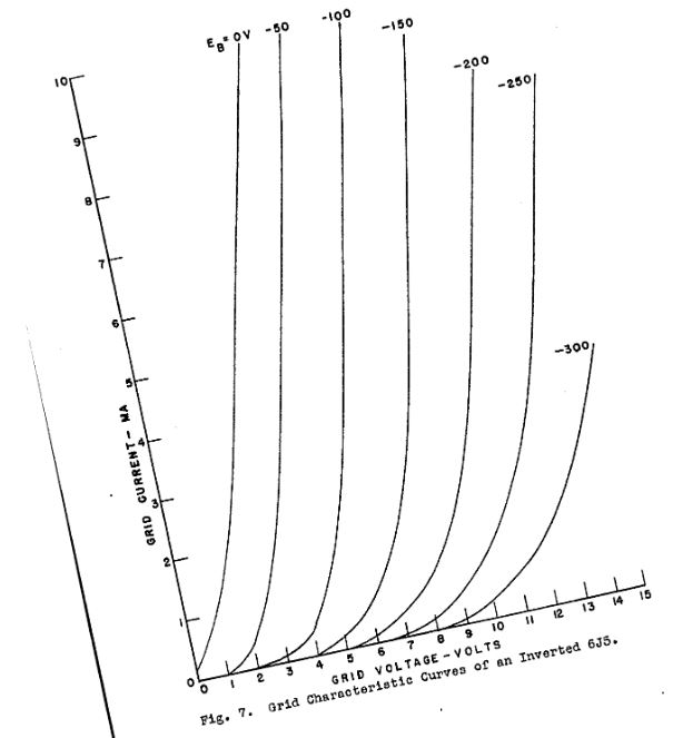

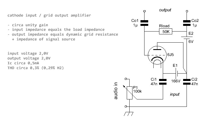

Interesting topology for a pre amplifier because of the low THD or for a compressor because of the possibly to reduce dynamics, making use of the non-linear area. From the text I took this setup. Do you have any recommendations for building an experimental unit?

Well, it's interesting but not very practical I guess. For my circuit in #4 it takes a lot of drive to swing that HV PS. Replacing Ci capacitors with a transformer would throw away the advantages of the circuit. Perhaps someday one would com back to build a compressor / limiter.
