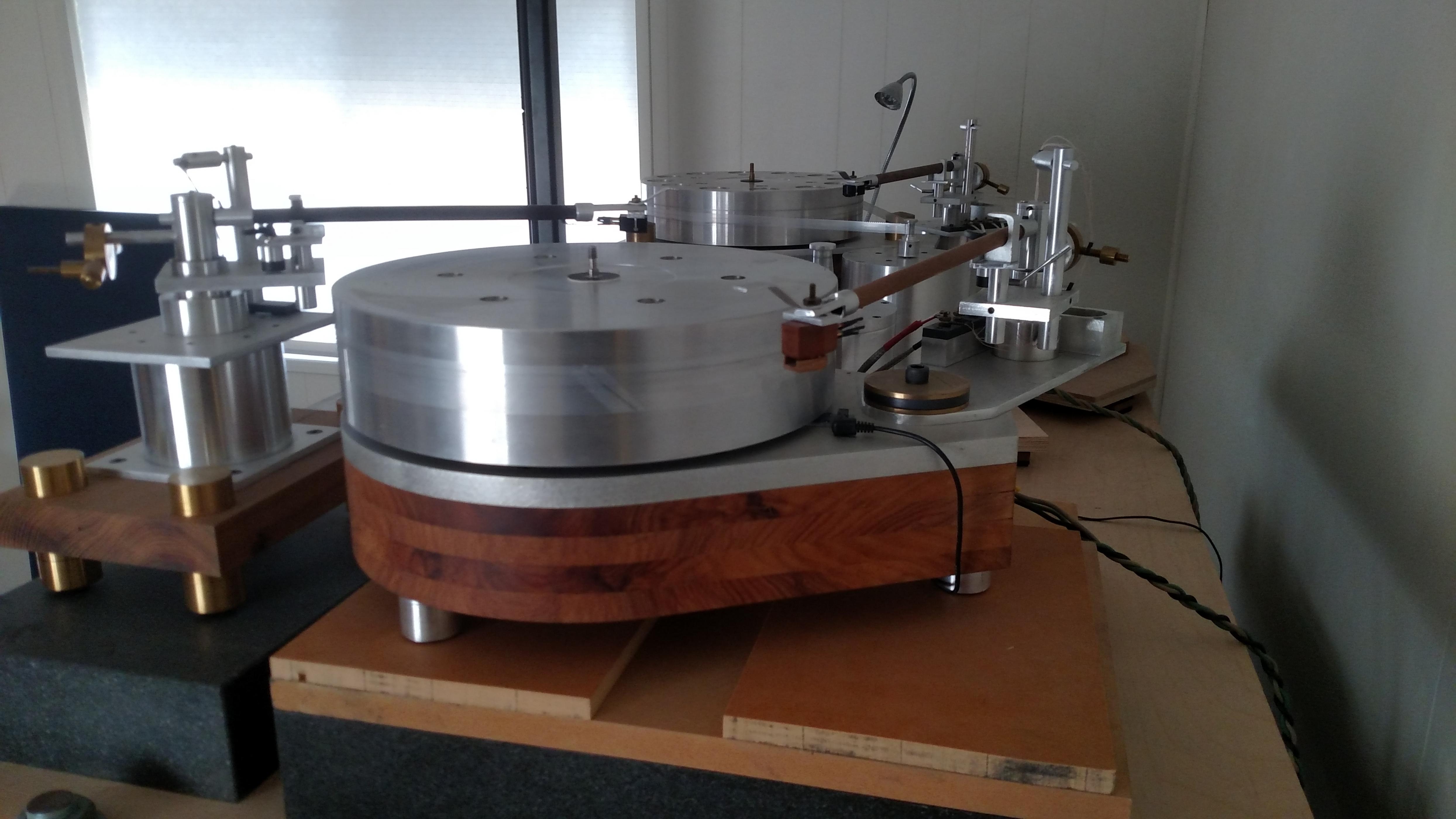

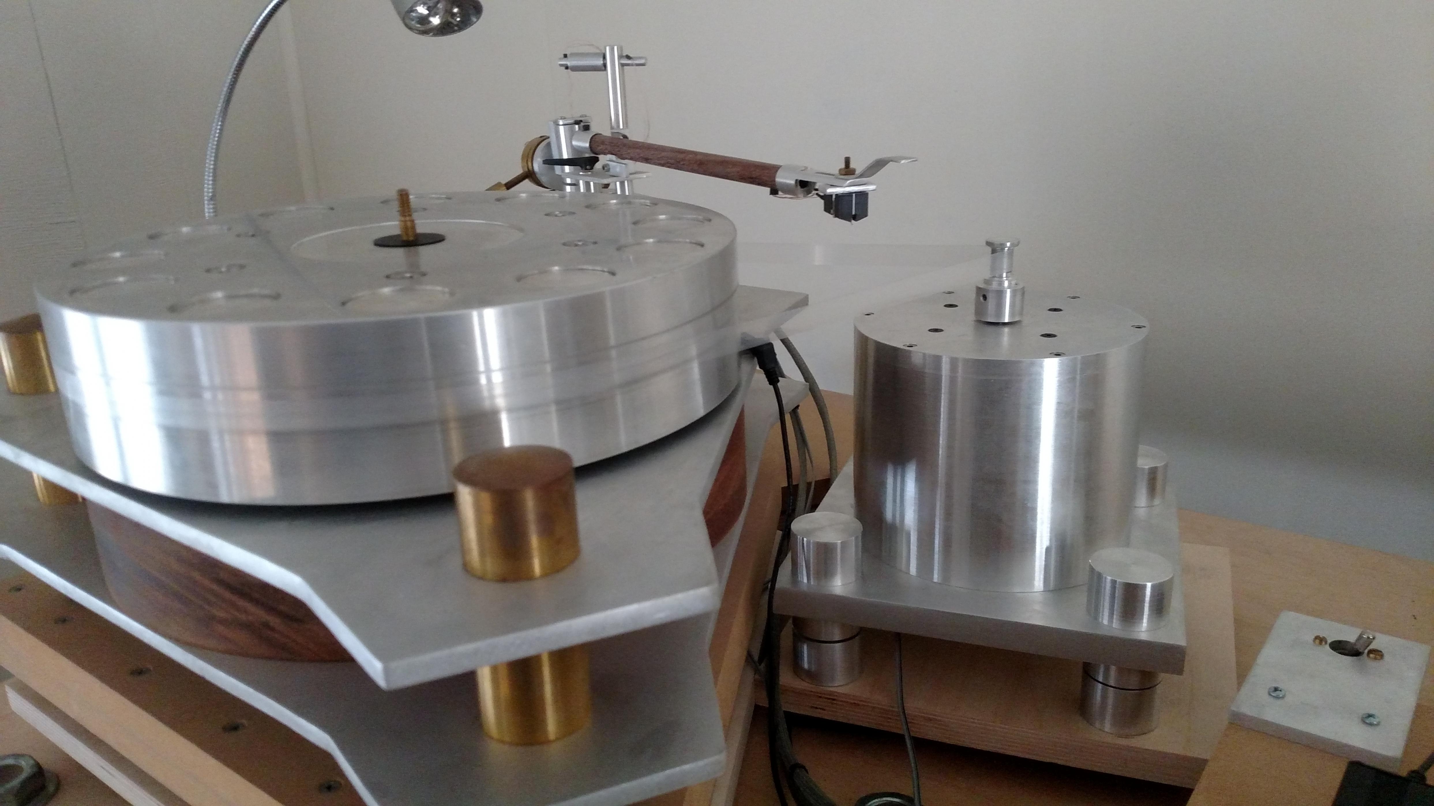

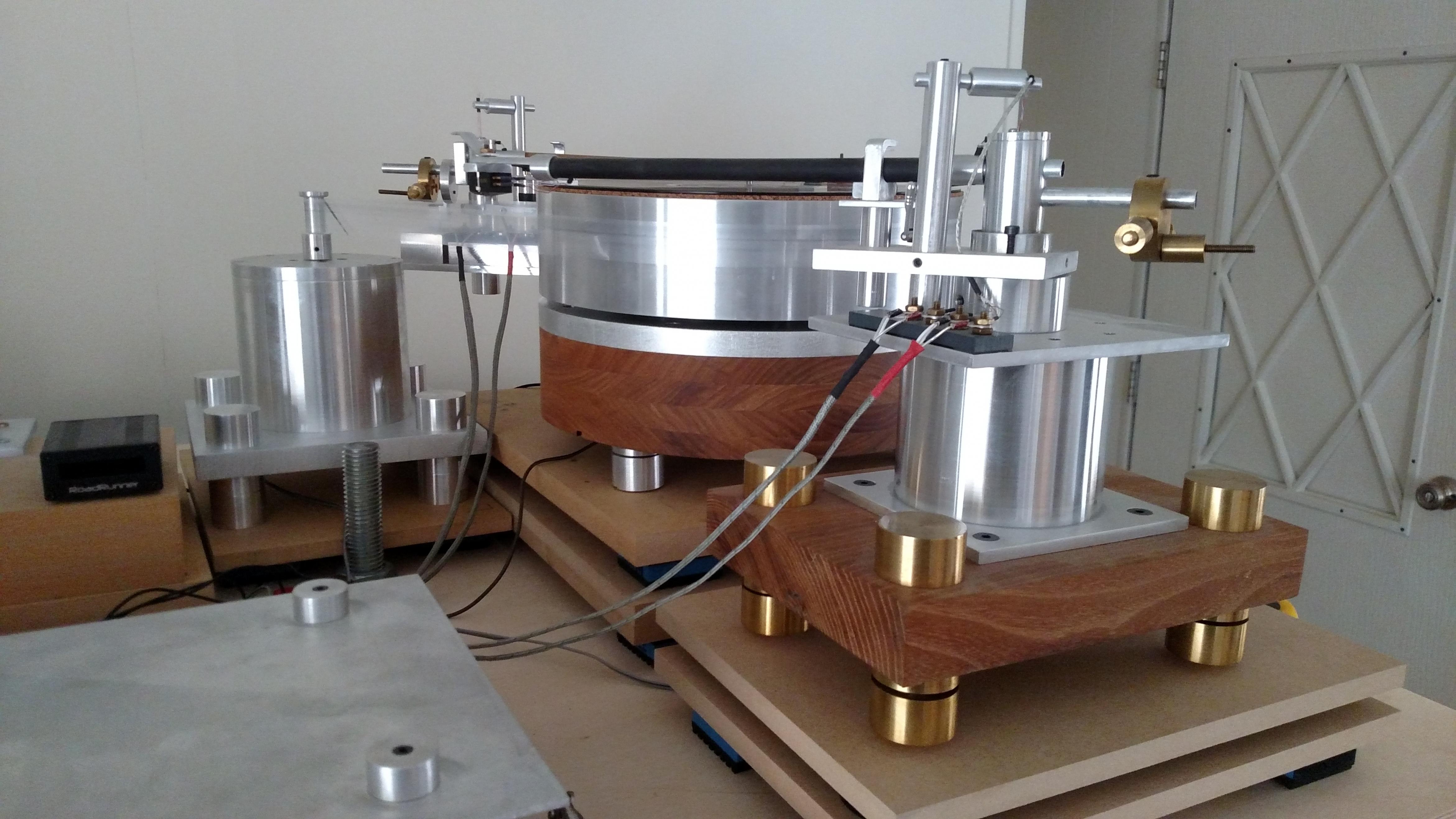

I built 4 different platters for teres and red point bearings. The 2 I liked the best are lead loaded aluminum at 32lbs and 38 lbs. I am also using PVC mats one with lead sheet sandwich.
I did not use acrylic but had the red point PVC platter. The heavier aluminum lead stood out in 3 areas. Drive/dynamics, pitch, and decay. I needed the money or I would have lead loaded the PVC for another comparison. It only weighed in at 16lbs. Met Chris at a show and we had a long talk. He stated weight is your friend with belt drive platters.
If you can build electronics, look on this site and get a sgt4 kit. Bill even has a motor and amp thread too. Run mylar tape 1/2 / 3/4 or 1 inch.
Here are the 2 platters I am using now.
Enjoy the ride
Tom

I did not make any drawings but depending on bearing and pulley size they could all be different. So default size would be 12" diameter. Height would be based on looks, weight and what you did with the bearing/plinth pairing. From there you see how the bearing wants to mate to platter(teres wants slide fit with 90 degree shoulder).
Now you bore your underside hole to clear the bearing and put the shoulder on platter for the bearing mating. On adding weight( brass, SS, lead etc) drill the holes (with CNC or by hand with rotary table. You want to keep things balanced and the more on the outside the better for inertia. Then figure out how you want to cap the holes if you use lead shot (counter sink with cap is one way). Gram scale the weights to keep things in balance.
How the machine shop goes at this will depend on his machines.
Hope this helps
Tom
