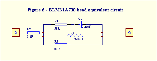

I was thinking more in a lumped element model like
I don't get that R2 thing.No more then the resistance of the wire in the bead.
If you do, why not include a rsistance for every wire in the circuit ?
Mona
if it is significant, you should indeed do so. If it is not significant, forget it, it is extra work and real engineers are lazy; they think before they act.
