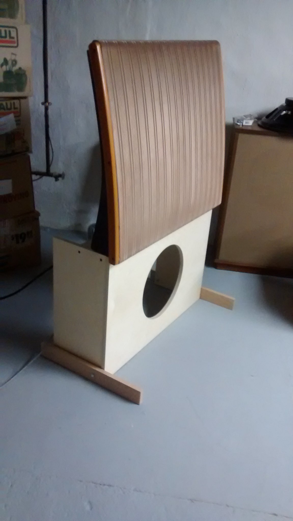

"Quad ESL57 on top of its 15" woofer base " It is my understanding that Quad ESL speakers often fail due to the glue letting go of the diaphragms. Putting a woofer directly below the Quad panel like that will subject the Quad diaphragms to the full bass pressure wave with a differential pressure on the panel front and back. If those were my speakers and I wanted a subwoofer under them I would build a sealed box and play the woofers such that the pressure from the sub is directed equally to the front and back side of the Quad. So a sealed box woofer with top , bottom or side firing woofer would be what I would do.
The "physical pressure" exerted on a surface by a sound wave is miniscule, and near zero unless the SPL is extremely high. For example at 120dB (threshold of pain) sound is only exerting 20 Newtons per square meter! That is about the same as 0.003 psi. It's just not all that significant.

I'll probably cross over at around 125 herz. The Quads will got down to about 50 hz without much fall off, but they sound more compressed (and they need a stiff amplifier) if you want to run them full range. The other side of it is that Quads can have wonderful, tight, bass, and it would be nice not to lose that.
In listening tests with fullrange drivers I preferred 80hz cut off for them.
That preserved the good time coherence of fullrange sound the best.
Possibly? The two failure modes I am aware of for the first model Quads are: 1) crud somehow gets past the protective mylar and causes buzzing an/or ticking noises. The degree to which the noises are audible is heavily influenced by humidity. 2) Arcing. Given a powerful enough amplifier, sparks can cross the (narrow) gap between the stators and burn holes in the diaphragms. I guess if you have crud (situation 1) arcing might be more likely. I've never had arcing. My Quads were manufactured in 1964. I have had them for about 30 years. There are six panels in two speakers and every ten years or so one of them goes. You can get panels rebuilt by various people. It's a good idea to learn to install the panels yourself if you want too live with these speakers....

I used to cross the quads over low like that last time they were working. I used something higher for a full range driver. I'll experiment for sure. It's interesting to compare what perrymarshall did to what Nelson Pass did with the B5 - in the latter case you wind up with more going on in the bottom octave. I guess biamping makes it more practical to drive a speaker that way.
