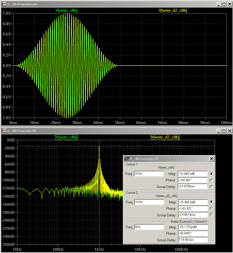

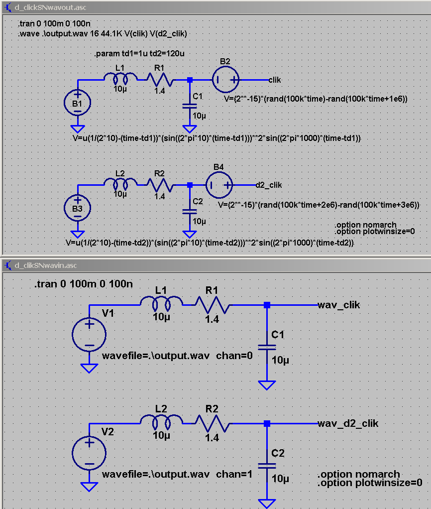

RedBook CD has plenty of bits for nanosecond resolution
this can be simmed - like I have with the dealyed clik tone bursts before when Kunchur's lack of DSP prowess has come up
LTspice - free, already used by many here
below I have created 2 50 ms raised sine enveloped 1 kHz tone bursts: B1, B3
they are dealyed by td1-td2 = -119 us
added 2 lsb pp TPDF dither (B2, B4), then write out both to a 2 channel .wav file at 16/44100
the next asc reads the .wav, then I run a fft on the burst wavefrom
the cursors are set to the peak at 1 kHz
calculating from displayed phase diff of -42.8401° / 360° * 1 ms = -119.000278 us
thats sub nanosecond resolution folks - encoded, transmited through a CD resolution .wav file
all the moving parts are visible, you can play with the sims yourself
(LTspice group delay calc seems to have a rounding? error - looks like I'll be emailing mike)
just to see it wasn't dumb luck I can change the td2 value to 12 us for a diff of 11 us - which is pretty much halfway between 2 samples @ 44.1k
-3.96005° / 360° * 1 ms = -11.000139 us
again sub nanosecond temporal resolution - just coincidence?
things you can try with the sims - edit the BV for shorter, higher frequency, lower amplitude - say 5 ms of 6 kHz at -20 dB: -23.7746° / 360° / 6 kHz = 11.007 us
that's 7 ns error due to shorter burst and lower amplitude showing limiting with dither noise floor

longer delays show that u(time-td) window in front of envelope is required too - added to .asc below
an LTspice obscurity is that to get different radom numbers for the dither in each run of the sim you need to check the box in the
tools>control panel>hacks> "use the clock to reseed MC generator"
  • d_clickSNwavout.asc
