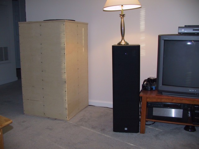

I started my tempest EBS enclosure for my sub. It is built to the design on adire audio's website:
http://www.adireaudio.com/tech_papers/tempest_apps.htm
It is the vented ebs subwoofer. It is quite large and will be 4' tall with the feet on it and 2' x 2'. 320L volume
I haven't finished it yet. I am waiting for the polyfil that I ordered and I still need to caulk the inside corners. Even though the top is not screwed down and the driver and ports are not yet mounted, it sounds quite good with my leach amp driving it with my denon digital decoder acting as a low pass filter.
I will eventually cover it with 1/4" baltic birch on all sides.
It will be downfiring when it is finished.

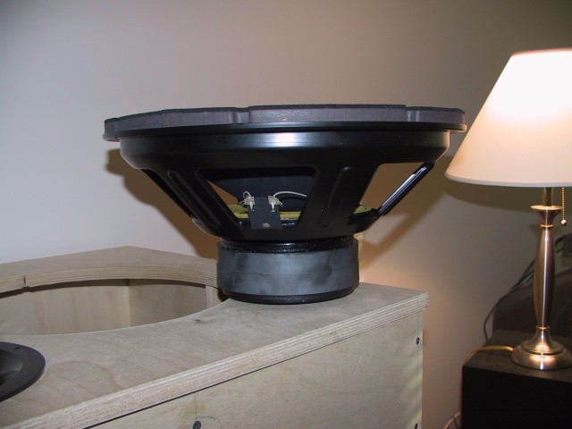

Looks pretty good so far. I am hoping to build a shiva suit someday.
Are you not required to make the driver flush with baffle for subwoofers?
When I cover the entire sub with 1/4" birch, it will make the bottom more flush. the sub sticks up 3/4" over the bottom including the foam part on the woofer. If you disregard the foam part, the metal part only sticks up 1/4" off the bottom. I am thinking of putting more 3/4" birch on the bottom instead of 1/4" and making it more flush.
Is it worth the effort? Will it effect the sonics for a sub?
Brian
Brian

brian as i browse your webpage i see your enclosure for your sub WHY is the box so huge. it is like 4 feet tal buy 2 feet wide each side.. that thing is huge.
JasonL:
I also figured what the hell... I am building my own sub, and don't have to worry about the wife acceptance factor for this... so why not build the one that looks to be the best... I was going to build a smaller sub that was almost 2'x2'x2' but I figured that this one takes up the same floor space but is twice as tall...
Brian

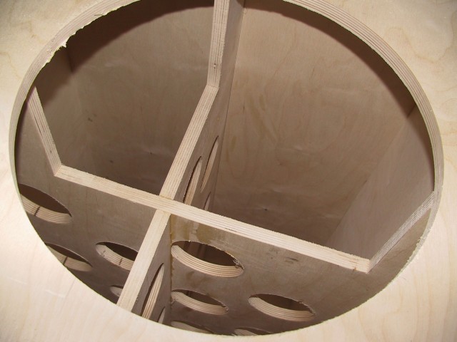

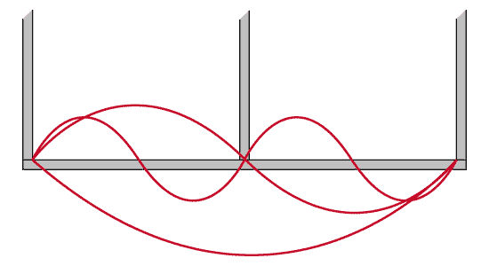

BrianGT said:The braces are directly down the middle.
The brace is a good idea, and you did run it the long way (a good thing), unfortuneatly right down the middle is the worst place to put it. It does little to brace against the 1st harmonic of the unbraced panel resonance or its harmonics. Because it clamps a zero-crossing it can actually raise the Q of these resonances. Best is to have braces divide a panel into 2 irregular trapezoids or if that is too much work at least 2 unequal rectangles. Hopefully the picture gets the idea across.
dave

I didn't even consider that. I just followed Adire Audio's cabinet design which divides it into quarters with the brace. The braces have holes in them so it is not exactly a full division, so I didn't consider it. It makes sense now how this might cause problems.
A lot of Adire Audio's applications have boxes cut into quarters with divisions making 4 equal square sections. If I build this again, I will consider this.
Where I got the design from:
http://www.adireaudio.com/Files/VentedTempestApplications.PDF
Would dampening help eliminate this problem. I will be following their suggestion, putting 64oz of polyfil in the box. Is there anything else I can do?

One more think.. This thing is very heavy.. made of an equivilant of almost 2 sheets of 4'x8' plywood

BrianGT said:Is there anything else I can do?
Since it would be a retrofit, about the best you could do would be to triangulate the 8 panels with pieces of (nominal) 3/4" x 1 1/2" plywood or hardwood end-on. It won't eat up much volume and will discourage those two modes.
dave

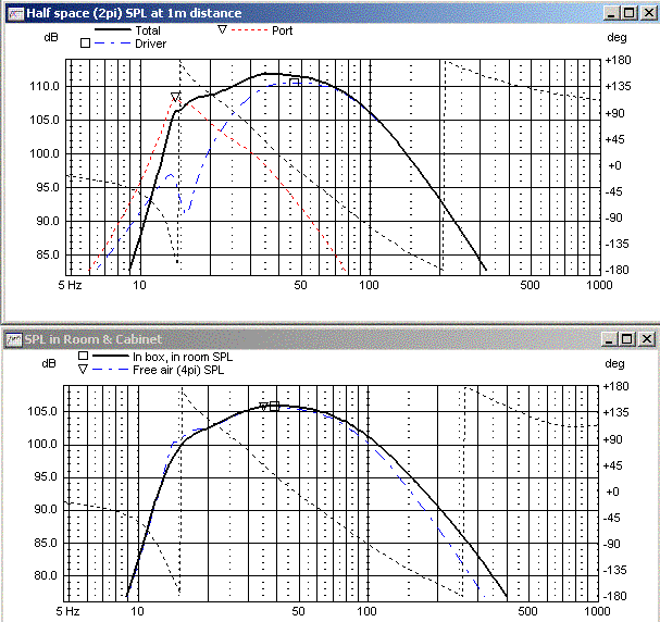

P.S. Have you run any calcs like Linkwitz did for his Thor
to get an idea how much amp you need? I'll bet with your
box size and vents, you can drive it to Xmax at 20hz for
less than 200 watts...

Good idea, I will see if I can get access to a table saw next week. Thanks for the advice.

The box will take 64oz of polyfil (4 lbs) I ordered a 5lb bag of it.
I haven't run calculations for the power needed for the speakers yet. They seem to go plenty loud with the Leach amp, so my Aleph 2s will be good when I finish them for it.
