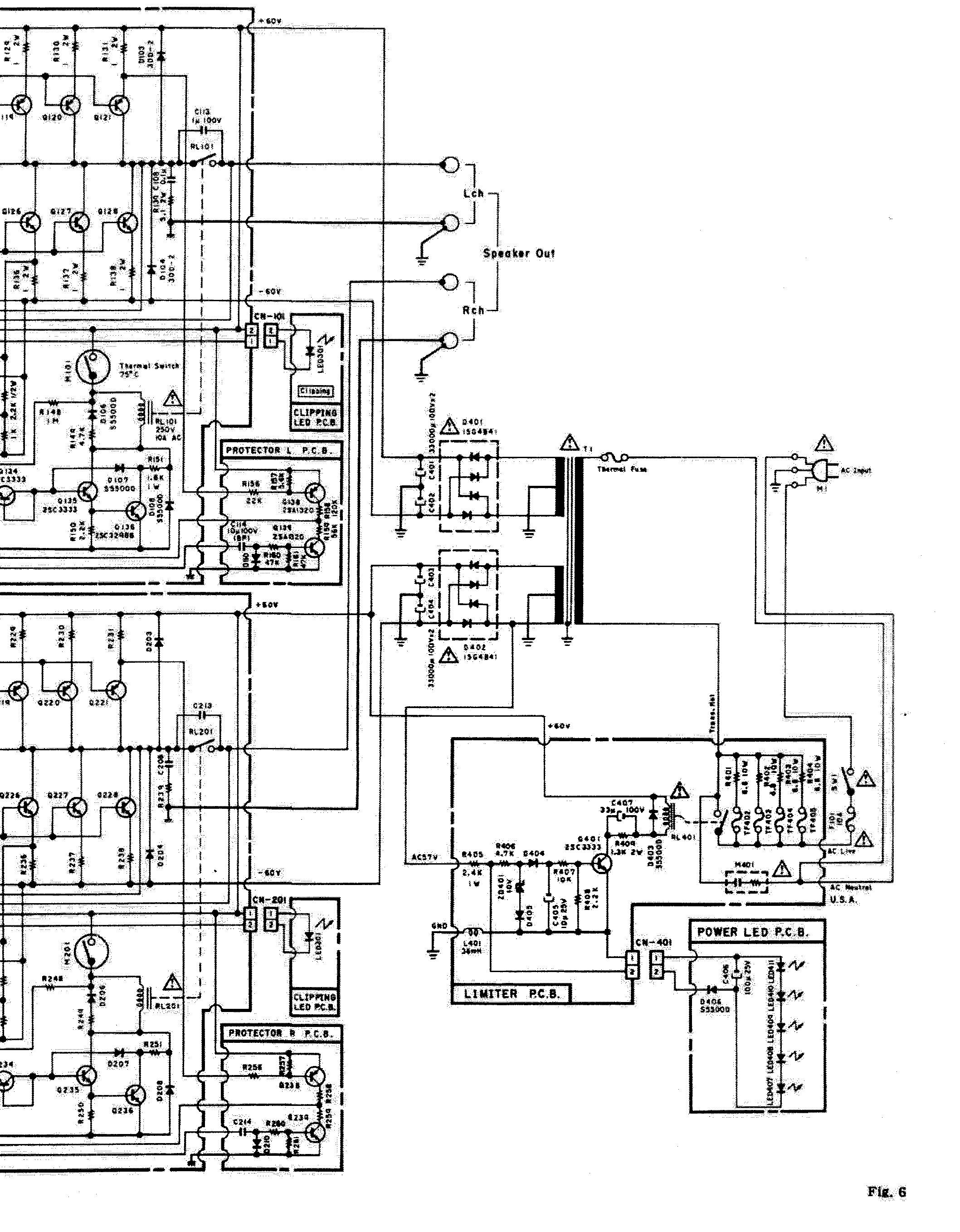

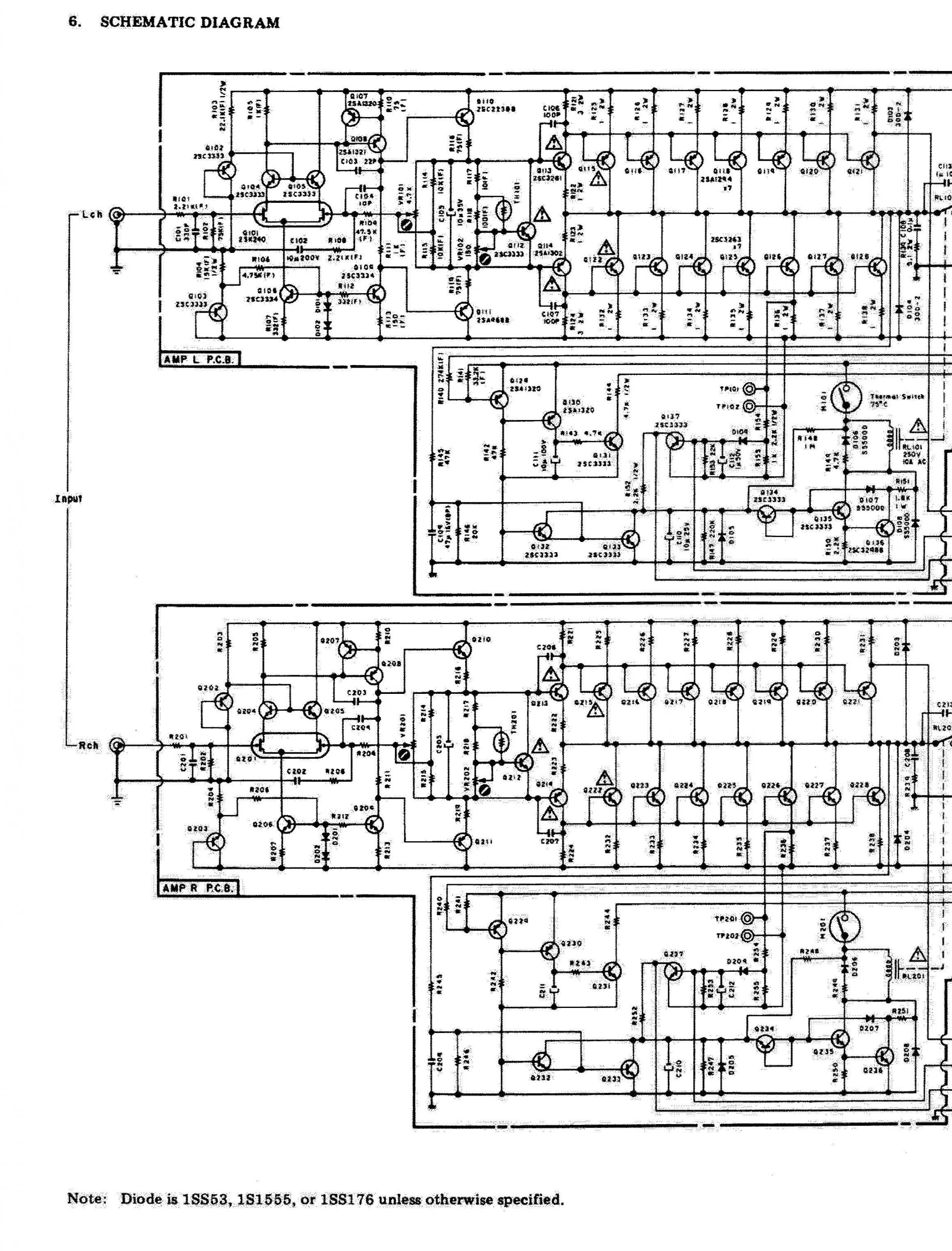

@Nelson Pass: Yes, I'm talking about the TO-220 style devices, see the schematics in the post above from Old'n'Cranky.
Please, can you tell me in some sentences, what is the "task" of these 4 (2 per channel) devices?
@Old'n'Cranky: Thanks you very much for the schematics!
I wonder why Nakamichi didn't put these transistors also on the large heatsinks..

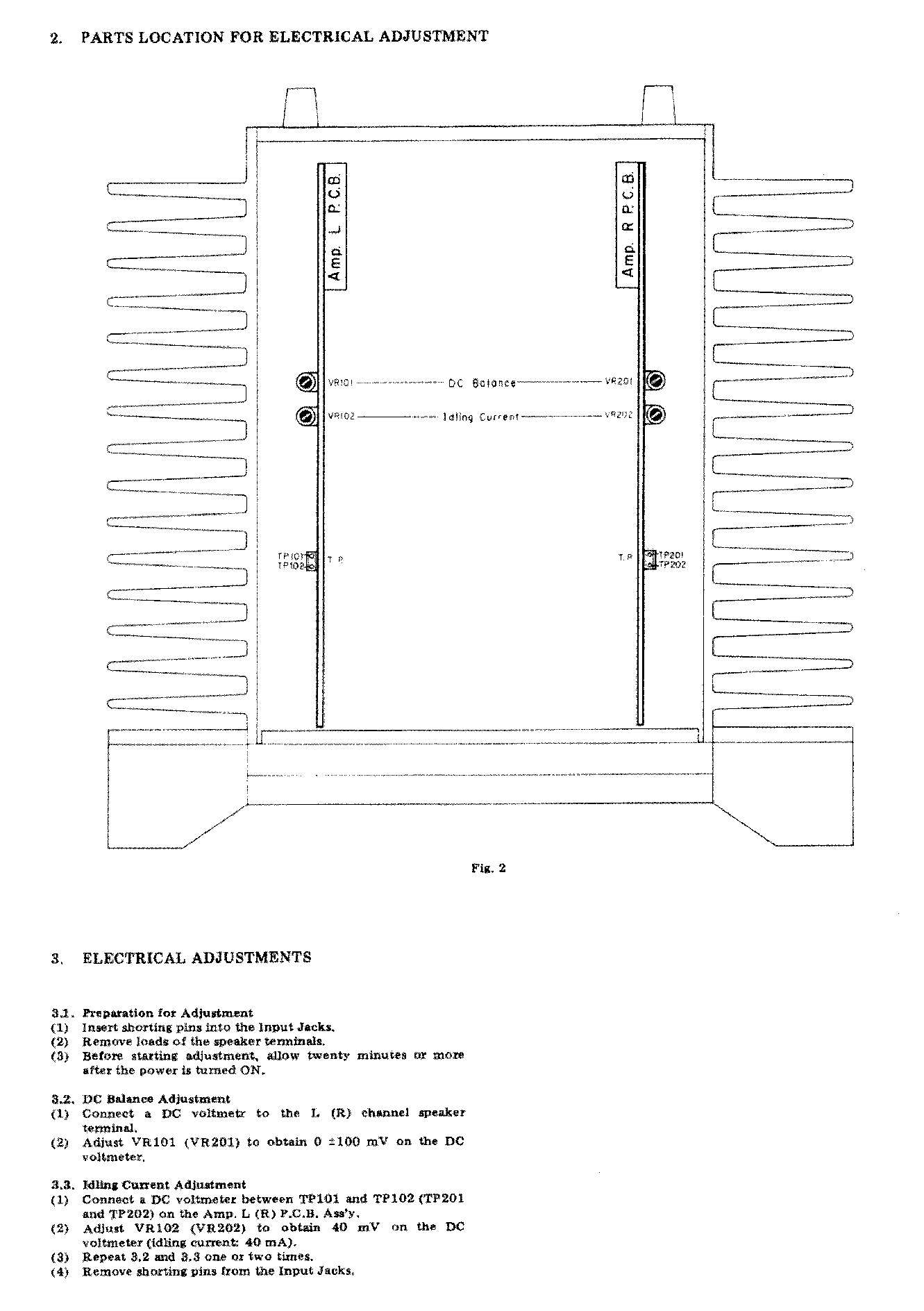

if you're asking for Q110 and Q111 , they're emiter followers and part of biasing stage
VR101(201) is for output offset , VR102 (202) is for Iq

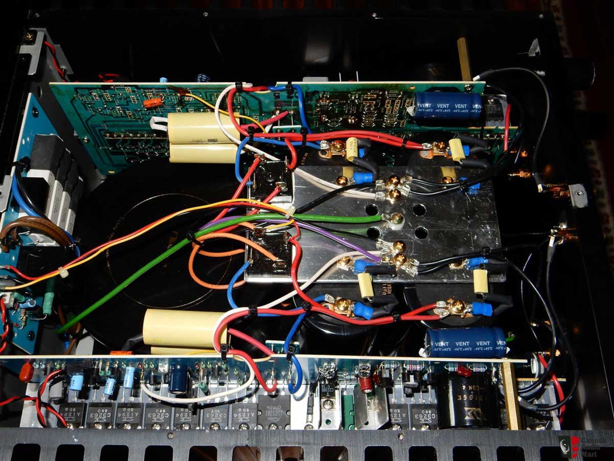

random picture from net - I see heatsinks , dunno is that later addendum by owner or factory
in any case , there is a place for some heatsinking
Thanks, Zen Mod. I understand now why they are getting hot (high bias)
Well, there are tiny heatsinks as in your picture, but inside a casing without any "holes" for airflow, this makes no sense. I'm thinking of modifying the casing for better airflow...
