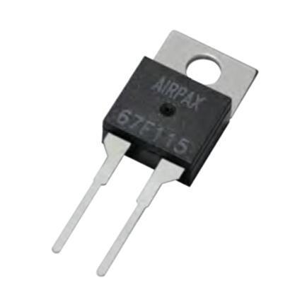

10x the price: Are these a fire hazard, too? LOL
"The Airpax® 6700 series is a RoHS compliant, positive snap action, single pole / single throw, a subminiature bimetallic thermostat that provides accurate and reliable sensing and switching in a single device. The 6700 series thermostat dimensionally conforms to the international product package standard Y220 / TO220.
Thus, the 6700 may be automatically placed and soldered onto PC boards with high speed automated equipment, eliminating the need for the expensive hand placement and termination required today for most power supply thermostats."
https://www.sensata.com/products/temperature/6700-series-220-subminiature-thermostat
https://www.sensata.com/sites/defau...iature-bimetal-disc-thermostats-datasheet.pdf
All this horses*it about them catching fire... if @Koonw has a bunch of them perhaps he can hit one with a blow torch and see what it does...

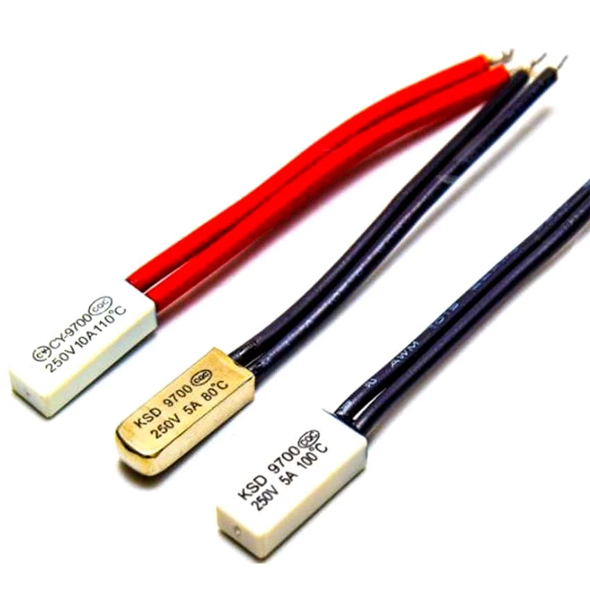

I have TIP31 and KSD-01F, try to cut the black package material, I can cut through KSD-01F quite easily without any sound but not TIP31, it's much harder you can hear scratching sound. So KSD-01F material is just plastic. For burning test I'll put them stainless steel plate over open gas stove. The plastic does not melt, and switch is opened, close again after cooling down (with water from tap). The packing material can not be so rigid due to the metal expansion I think that is why it's high temp. plastic, nylon (360 deg C). Mine is direct from KSD factory, one on Taobao maybe having fake packing although the metal maybe real.

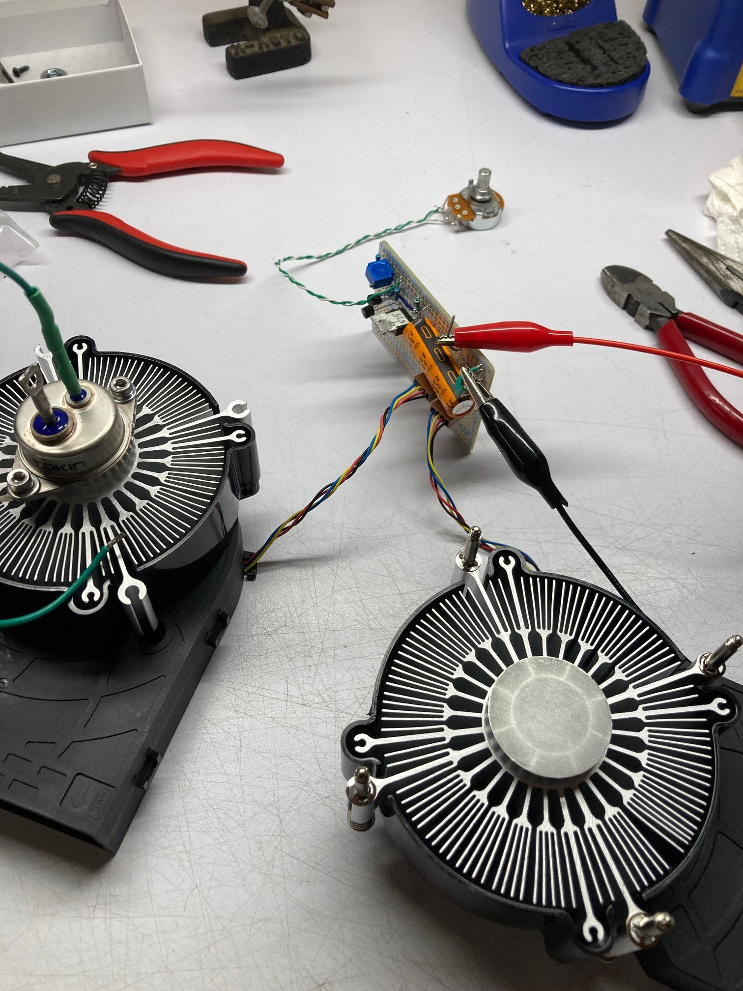

I mocked up one of these today, to test out my CPU cooler fans, and just wanted to say that this circuit can tolerate some junk bin part sub nonsense and still work. It works despite off-brand transistors (2N2222), an off-spec MOSFET (FQP3N30) without a heat sink*, an old re-formed capacitor, and a 100k pot in place of the thermistor. Two 12V fans in series run fine with a 24V feed, and if the zener runs the fans too high at baseline, you can clip it out and the circuit will still work. Alas these fans get noisy when blowing against finned heatsinks, but now I know! Thanks to Mark and this little mocked-up circuit.
*you'll probably kill your MOSFET if you run it too long un-sinked, though, mm hm. Just sayin'.
